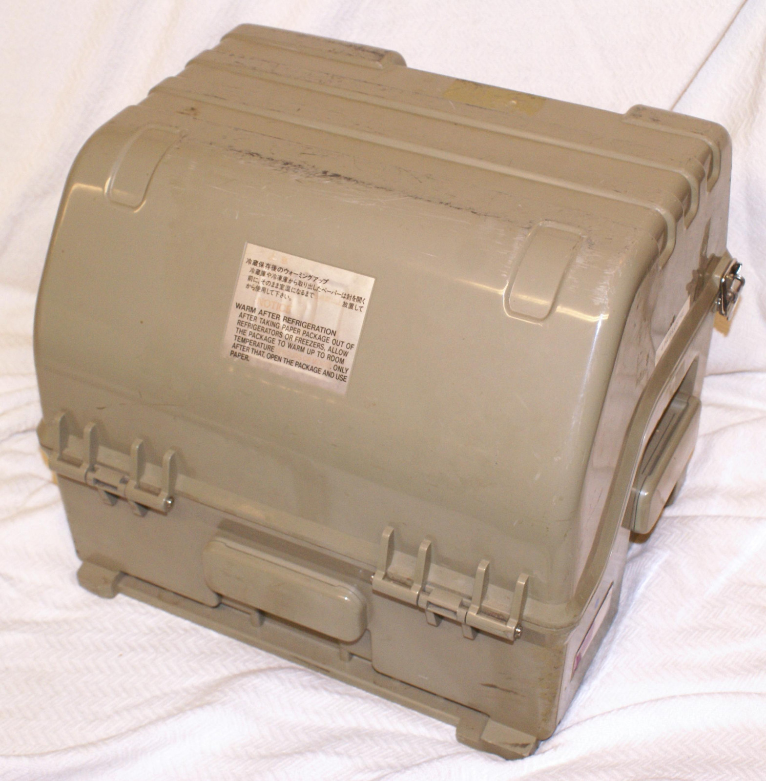

The only thing I'd add is that you can buy Fuji Chrystal Archive II paper much cheaper than cut sheets; I buy rolls of several hundred feet at a time for about $35.00 each. It really brings the cost of paper down. I bought a couple of those "paper cassettes" that they used to use in film developing labs; they are light tight and the paper fees out of them via a slot with a light trap. Other than the paper wanting to curl badly, they are very very enjoyable to use.
Picture?

this one was 39.00 and 39.00 shipping but I've paid less.
