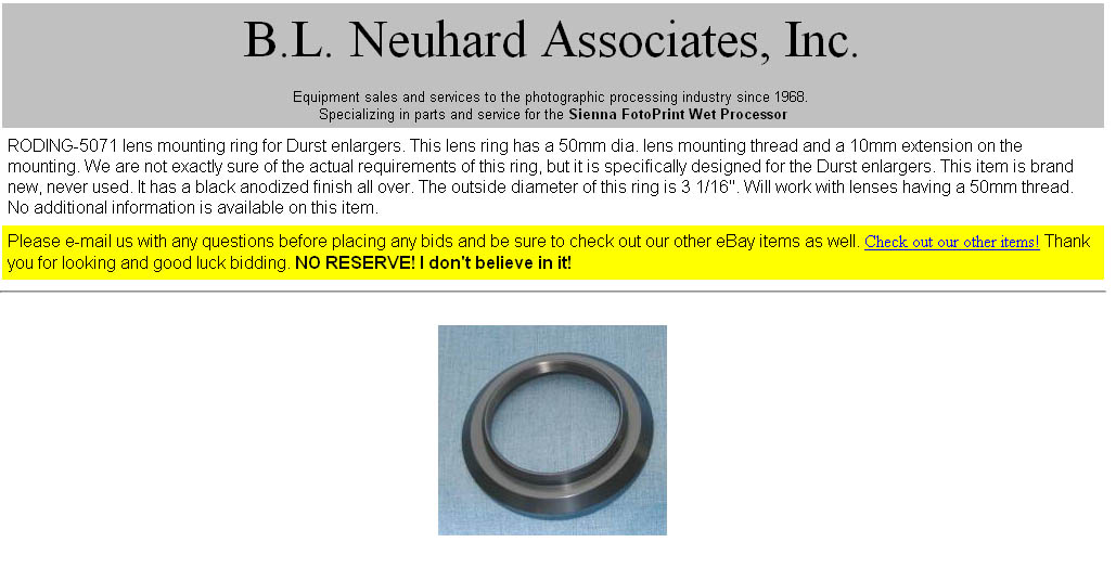

You could try Barry Neuhard at barry@neuhardassociates.com. I bought this from him on ebay a few months ago.(see picture) Not sure if 10mm extension is enough for the lens you have but I have a 150mm Nikon attached to mine which allows the turret to turn.
no 10mm is not enough. I think it should be at least 30mm

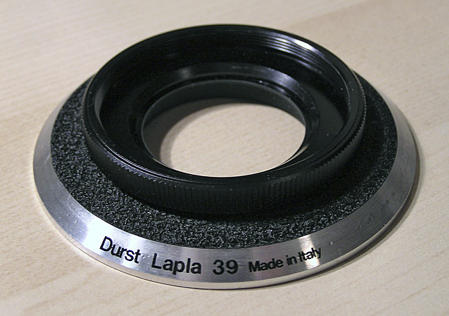

Another short term alternative would be to look for a 39 to 50 step-up ring per the picture below. This is a Lapla 39 with a plastic 39-50 step-up ring in which I mount a 150mm Rodenstock. No noticeable loss of negative coverage in my usage of this setup. At a pinch you may be able to get away with a series of camera lens stepup up rings to get you from 39 to 50.
Otherwise be patient or persistent. I have managed to find 4 different lens boards in the last 4 months since I purchased my 138. They came from Canada, US, Germany and a local Sydney camera store. All different shapes and colours. The Durst way. Why have one part number when you can dream up 14 different ones. As for neg carriers - yikes - be prepared to pay more than the enlarger for a decent 5x7 carrier with good glass...... Happy hunting
