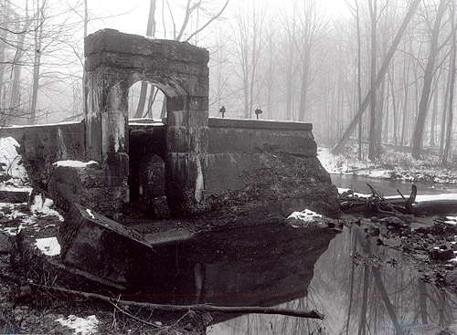

My own opinion is that split grade works best with images that contain broad areas of detailed shadows as well as significant, important highlight areas. Almost like two separate images of equal importance within the same frame. To create distinct tonal separation in the shadow areas with a solid dmax while also having a proper contrast within the broad lighter areas.
This would be an example though much deep shadow detail is lost in the scan:
The scan is very nice...I assume that the print is stunning...
