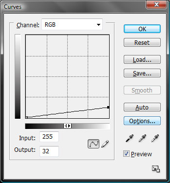

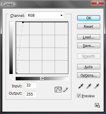

if you examin arguments like on this page http://jtrujillo.net/digital-photo-tutorials/8vs16bit/
you will find their proof of 16 bit advantage in quite severe adjustments:
like he does this to the image:
then undoes it with:
whoa, I'm not likely to do such wild adjustment to any of my images ... no wonder he got banding

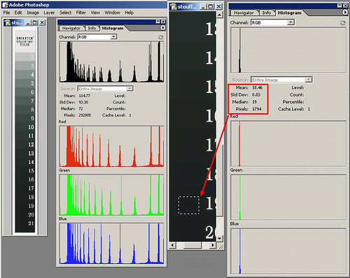

can you help me interpret the results from your stouffer wedge link? Is it indeed the case that when scanning with 8 bits I can expect pixel values between 17 and 250 or so? Or did I miss something in this test?
pellicle
May 25, 2006
1,175
Finland
Hi
yes, but my procedure was to not alter the black and white end points in the driver, keeping everything fully wide. I did this because altering the data set in software will make for complex variables. I wanted what the unaltered fully white reported to and what the fully black reported to
if that is clear?
by setting levels in the dialog box of the Epson scan you take what the scanner gets and re-map it.
Interestingly I do not get 255 anywhere even on the supposedly uncovered fully exposed areas. this indicates that the calibration of hardware is not perfect.
I'm intending to remove the glass in the future to see if this gives me access to a better white level.
my full data set is available here. I have also done experiments where I cover the "calibration" area of the scanner with unexposed but developed film base and that is also in that data set. This is presented as plain, 1 sheet, 2 sheets; in the 3200 extras
The scan was done at 16 bit, however I used photoshop to measure the values by selecting an inner portion of a square and seeing the values of this in the information dialog which remain as 8 bit represntations (NB 0 to 255).

Now that data set makes me really curious: At the darker sections you claim a standard deviation of 1.4 - 2 %, yet the pixel value seem way off :confused: So apparently (if my interpretation happens to be correct) ADC noise is only a minor factor in limiting Dmax, instead the seems to be some form of base fog in every flat bed scanner ...
I report what I see in photoshop
click figure for larger view
well, my interpretation is that this 'base fog' is the limits of noise on the conversion of the analog signal from the array of sensors. There is of course some limit at which the sensor can no longer discriminate or detect darkness.
Perhaps the analog gain is too much for the system.
However there is another theory I am intending to persue. This gentleman has explored blacking out the interior of the scanner to reduce extraneous light (flare) from the interior. Grab a nice drink and sit back to read his post here.
Aside from that there is probably some scatter along the light path (including inside the scan head itself).
When I get back to Oz I'll be taking the toolkit to my Epson in view of expanding its black levels.
Importantly (and why I have not yet done it) these levels are of greatest significance to E-6 film users (though they must also contribute to problems in Blue channel noise in C-41), which represents only a tiny portion of what I scan; Black and White in the main. The density levels there seldom go past the 14 step (at least not on my negs)
I can make the raw scan available to you if you wish.

Thanks, pellicle for posting these screen shots. To my knowledge these Stouffer wedges you used for your test have 21 strips spaced in density steps of 0.15 and cover D=0 all the way to D=3, which in my books is a 1:1000 range. This means that if the first few strips yield pixel values over 200, the strips with the highest numbers should theoretically yield pixel values of 0 or 1. The standard deviation you see in the histograms indicate that the sensor noise adds up to an RMS of 1-3 LSB, whereas the "base fog" is around 18!
From these results I conclude the following (subject to further verification):
  • The scanners you analyzed are not noise limited (in terms of Dmax) but shoulder off at higher densities. Sort of like film does, although the underlying process is completely different.
  • With a standard deviation of 1-2 LSB, we get about 7 effective bits per color channel and pixel.
  • It would be very interesting to find out whether noise can be reduced by scanning at excessive res (6400 dpi) and downscaling in software afterwards. Going from 6400 dpi down to 2100 dpi combines 9 pixels into one, which reduces the standard deviation of the noise by 3. This would buy us at least 1 more bit of color depth, bumping it to almost 9 bits per color channel and pixel.
that fits the description of the manufacturer and is what I understood too
yes, as the graph seems to indicate it runs out of discernable readings at about step 16 where little change is indicated
you may be disappointed to learn that I scanned at 3200dpi on my 4990 and downsampled that ... since the target was not large.
I have some other things to do at the moment, but I can repeat this later if you wish. Meantime my last results are available here. I have some space on my server there so it can remain there until some other space requirement pushes it off the stack.
Wait ... are you telling me that the histograms you showed were based on already downscaled data? That would change any noise estimate considerably ...
Just curious: these are 4990 scans, or are these from the V700? I'd love to get my hand on such a stouffer wedge or something similar at some point and do some experiments with my V700 myself.
