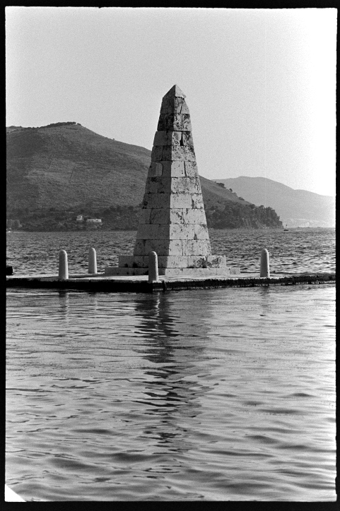

Thank you. The larger contrast adjustment in post for Tri-X is causing light diffusion unevenness in my backlight to become slightly visible. It's not noticeable in higher contrast film.

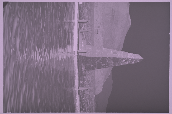

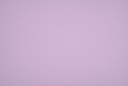

Can you see the unevenness here through a blank piece of Tri-X? Unaltered RAW file from a digitization session. It's just slightly enough to cause a problem at times.
Here it is beside an exposure on Tri-X for comparison's sake.

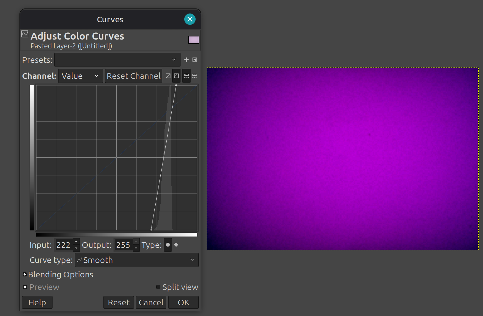

It's hard to see. Let's amplify it.
Quite often I'll apply gradients to the image to combat it, or try using the blank piece of film as a "divide" filter before any edits are made, but these are not without their downfalls.
Part of the problem is that I've had to add a clear piece of acrylic to my setup between light source and holder because my film holder is of such a shape that its feet are right on the borders of my light source. I need to remove this and try an alternate method of mating the two... as well as varying the distance between the two to aim for less "light vignette" and taping up anything that is contributing to internal reflection.

That negative above looks OK to me.
I'd just fix the actual problem instead of trying to work around it. You'd end up chasing your own tail. I think many of us have similar experiences; I sure have.
