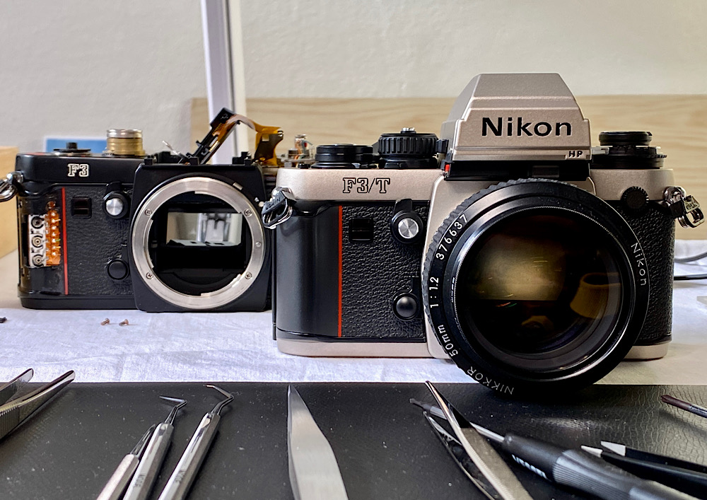

The salvation of my beautiful Nikon F3/T
I bought it from a friend in Munich in 2015.
He had obviously never used it, it had no signs of wear, the champagne-colored version.

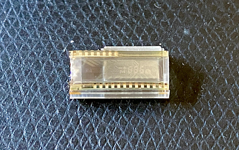

The only error was in the LCD display in the viewfinder, where a digit was no longer fully displayed.
Over the years the LCD got worse, more digits failed and I was desperate because I didn't want to watch my most beautiful camera lose its function.
Without an LCD
that shows the shutter speeds and the plus/minus balance for manual exposure compensation, an F3 is more or less useless.
So I looked for a workshop that could replace the LCD, sent several inquiries, but only received rejections. „Sorry, no spare parts available“.
My search for an LCD was also unsuccessful.

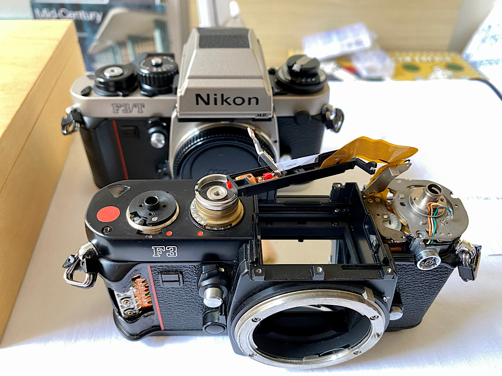

Until one day I saw an offer on eBay that included several partially dismantled F3s that still had their LCDs. I didn't know whether the LCDs were still OK. I just had to try an exchange!
So I bought - and ventured into replacing the LCD on my F3/T.
A donor for a replacement LCD was found.
And it succeeded!

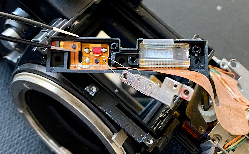

When I approached the matter after extensive research, I was very nervous. I still had only little experience with the screwdriver and, apart from the service manual, no instructions.
The left part of the F3/T’s top cover had to be dismantled and then the housing for the LCD illuminator and the LCD under the prism had to be opened.
Everything there is tiny, everything is crooked, just the genius work of Japanese engineers 🙃
The housing for the LCD block on the right

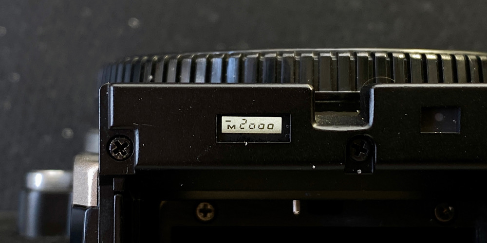

As I worked my way forward all I had to do was remove the LCD block from the contacts and insert the replacement LCD from one of the F3s.
The replacement LCD that was supposed to bring my Nikon F3/T back to full life.
When I turned on the camera, tapped the shutter button and saw - M 2000 in rich black digits, I almost fell off my chair with joy!
The most beautiful 2000 I had ever seen!
And this joy continues to this day.

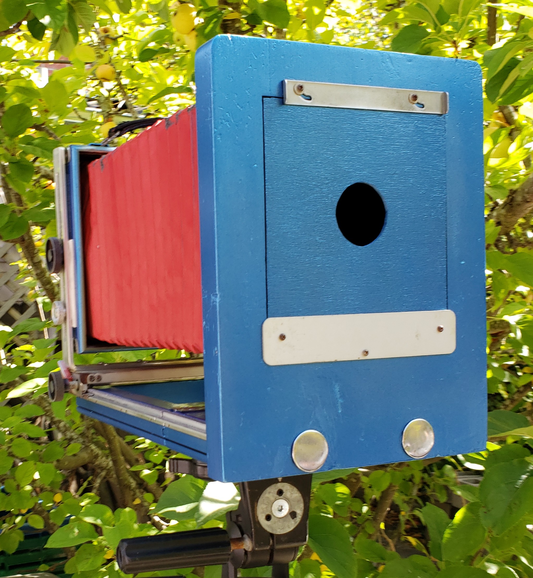

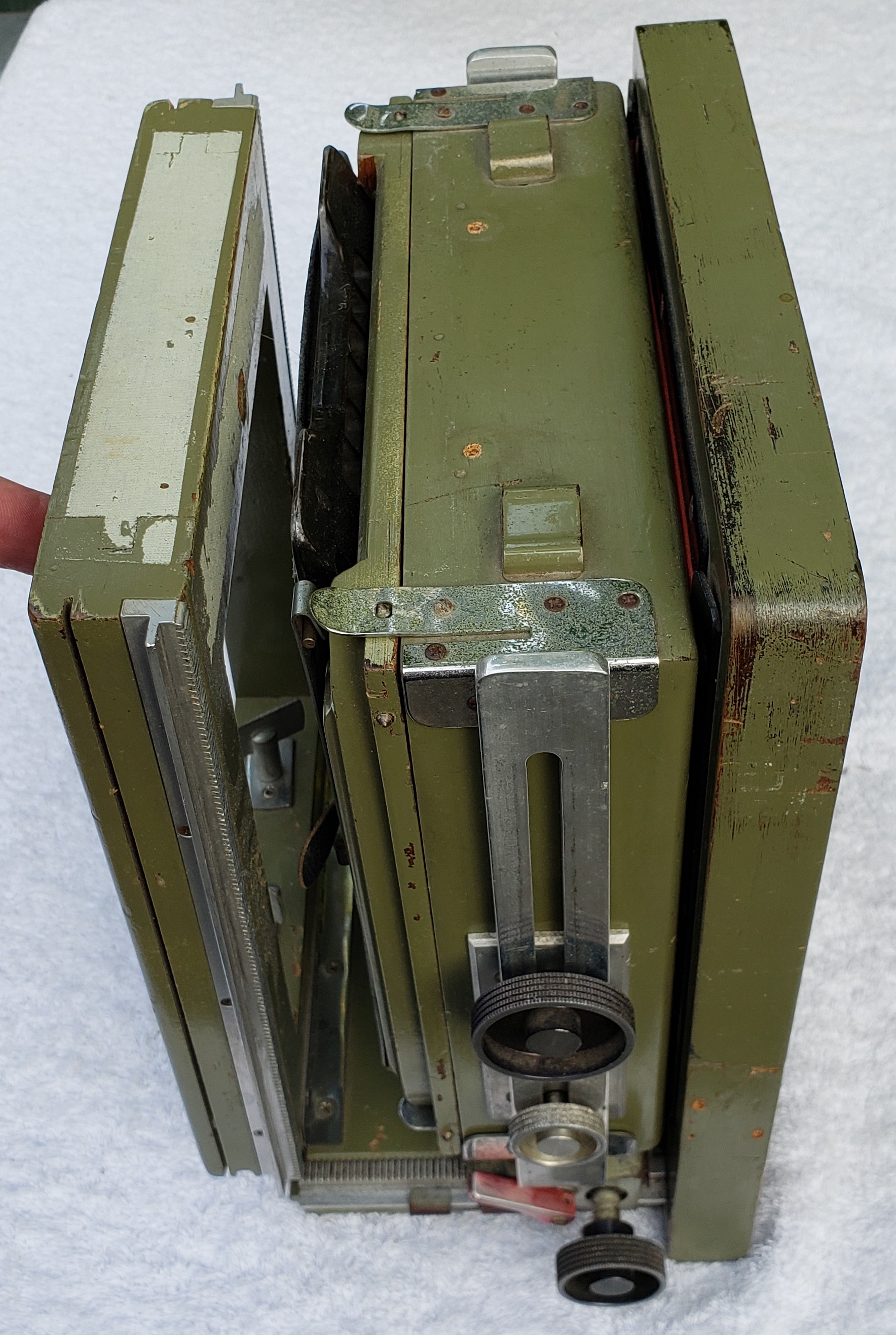

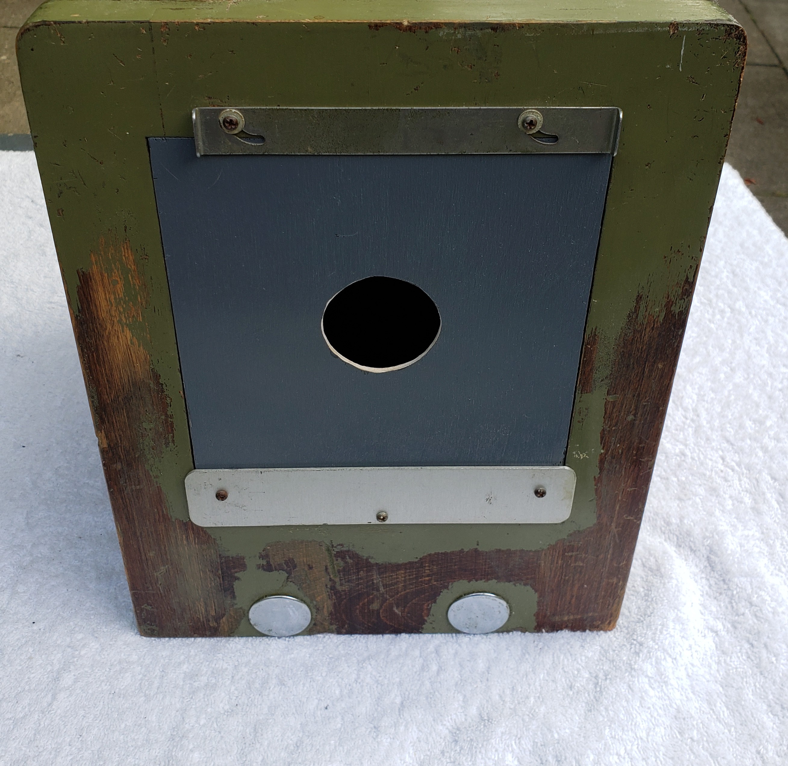

Not particularly challenging, but very satisfying.
I bought a beat-up Burke & James 5x7 Rembrandt Portrait camera...it had been painted an ugly olive drab color at some point, covering many dings, dents, scrapes & scratches.
The wood was too beat-up to be a worthwhile restoration project, but the sad camera was still usable, after a few pinholes in the bellows were patched.
I had some Lake Placid Blue instrument lacquer left over from a Stratocaster build, and decided to give the sad camera a makeover.
Behold "Big Blue" !
Now a happy camera, and not intimidating when doing portraits.

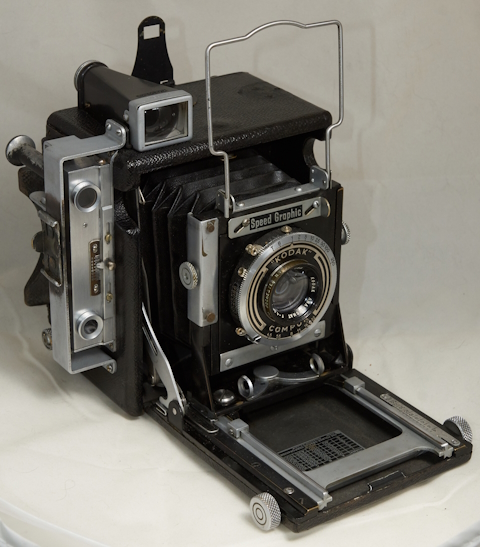

Graflex Miniature Speed Graphic
Cleaned off years of cigar/cigarette smoke tar residue
Took apart the Compur leaf shutter, cleaned the blades, escapement, and adjusted the timing.
Removed the awesome slotted focal plane shutter, lubed the bearings, reset the spring tension, and cleaned the winding gears.
Cleaned all moving parts, viewfinder, and restored the leather with tincture (no holes in the bellows).

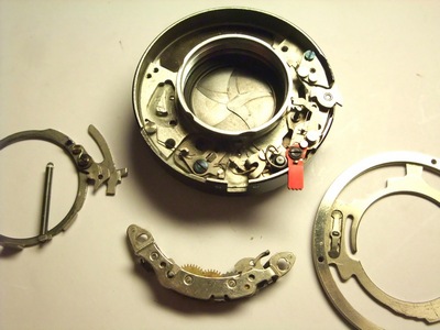

mshchem

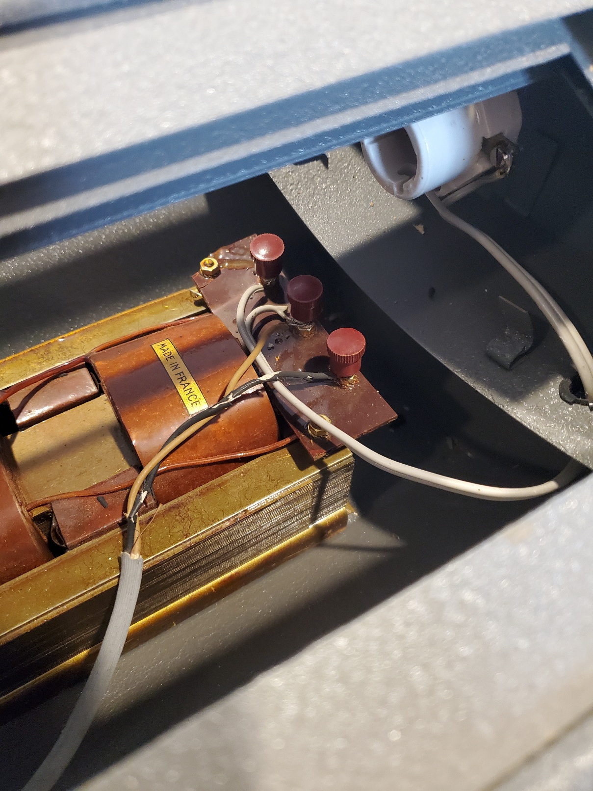

I did a partial rewire of a Thomas safelight, old, didn't even have an earthed cordset. Hard to get my huge fingers to do little things. But it's working, safe ( now has a 3 prong plug).
A beauty!
Are there instructions for the service or did you have to work it all out yourself?

A beauty!
When I started this restoration I could not find any service manual, but I did find a couple of videos concerning repairing the larger versions ... so I worked most of it out myself as I took it apart. Luckily, the slotted focal plane shutter curtain was intact ... the leaf shutter is easy if you have read over the Nat Cam course material on The Learn Camera Repair site ... they now have a copy of the service guide.

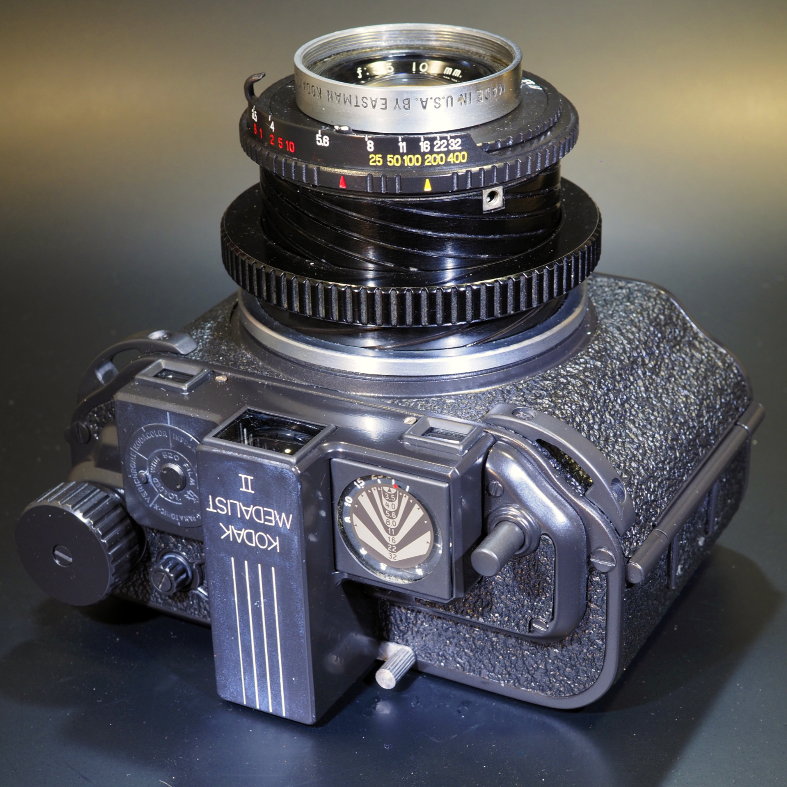

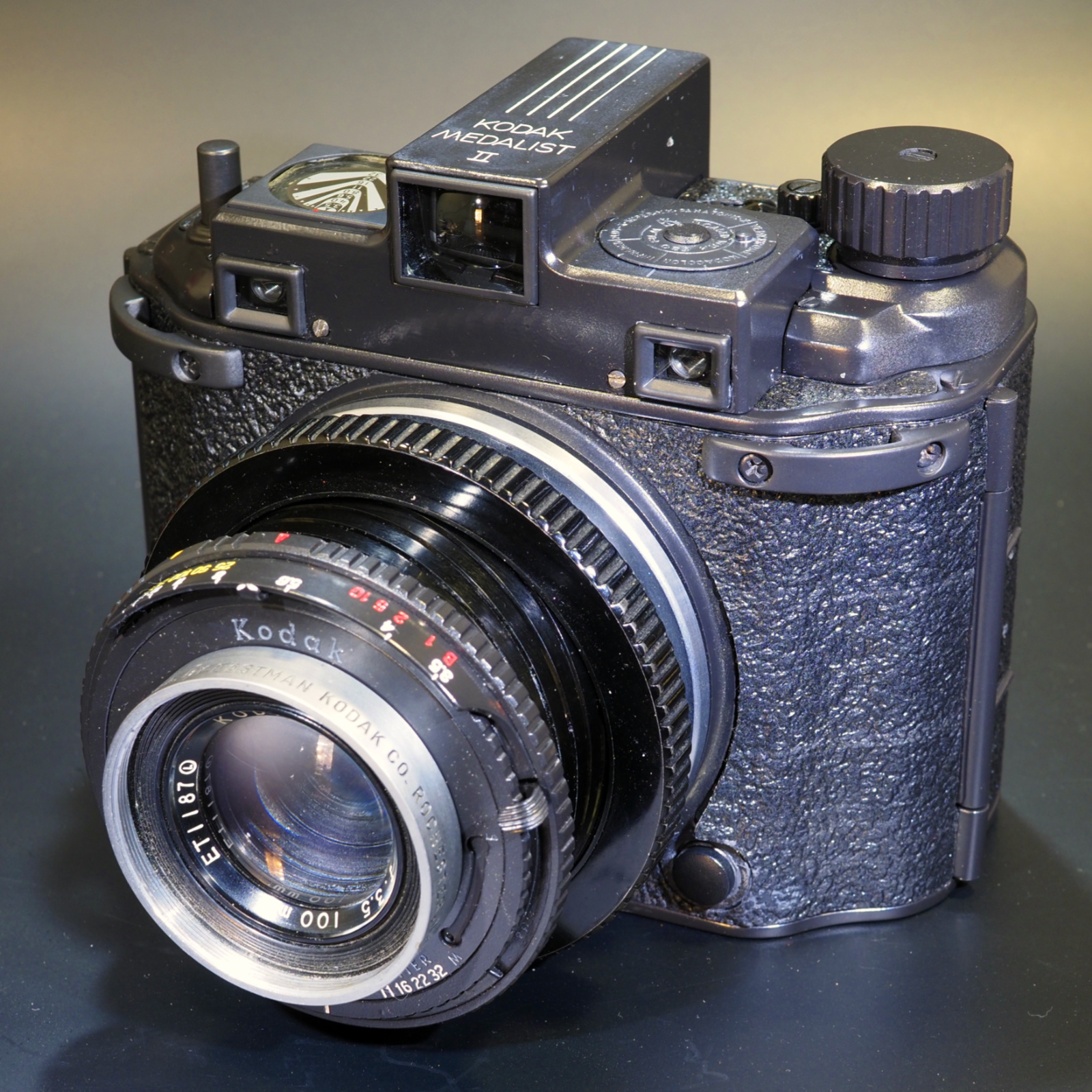

Well, not the best photos. And not the best final results. Kodak Medalist II turned black. CeraKote ceramic coating. Unfortunately the guy who did the coating is a gunsmith, not a machinist, so there are issues of tolerances and such that although I talked with him, he must not have understood. More than anything, had to use a black anodized focus helical set from a Medalist I, not the original parts that no longer worked because of excess material build-up on the thread surfaces. This lack of understanding of fine tolerances showed up in a lot of other places, too. Oh well, live and learn. The person that this is for is going to use in hiking and rock climbing so I went for clean bright in-fill paint on areas needed for camera function. Probably a bit brighter than I'd want for regular street use or such.
Medalist II, overhauled (everything- shutter, rangefinder, wind, focus helical, viewfinder, hinges, etc.). Converted to 120. GripTac covering. Installed a PC flash terminal in place of the Kodak ASA original.

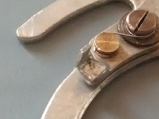

bernard_L
Feb 17, 2008
2,031

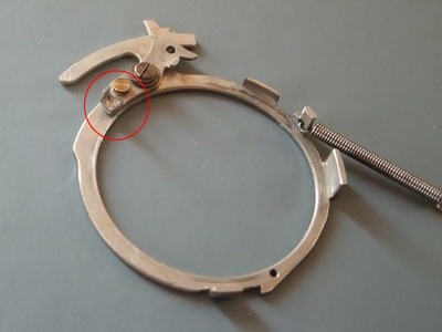

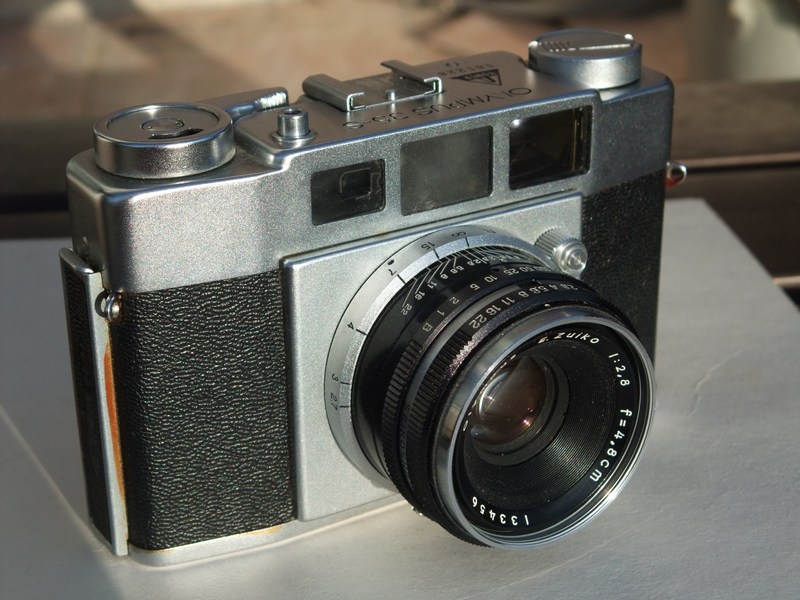

Not the most complex repair, but maybe the one I'm the most proud of. Olympus 35S, bought "for parts or repair". Thought it just needed a cleaning of shutter blades. Actually a small part on the main shutter ring was broken. Made a replacement from scrap metal and glued it with high-performance epoxy. Works! Film tested.
