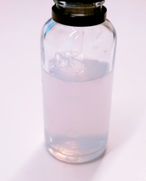

Note that this question is really out of curiosity; I'm not trying to solve a problem.
I've got this old (definitely very expired) bottle of Adoflo of which I decanted a bit into a pipette bottle. As you can see, it is quite cloudy, whereas fresh Adoflo is as clear as water:

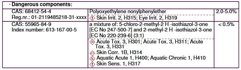

The SDS for this product lists the following components:
There may be other stuff in there that doesn't require listing, like IDK, plain ethylene or propylene glycol or so?
I wonder what has decomposed or perhaps polymerized here. Again, just curious. I've seen something similar happen with dishwasher rinse agent if you use that in warm water; it tends to go milky in a very similar way.

The first compound (also known under the name Triton X-100 appears to degrade into some non-polar and therefore water insoluble compounds. This article's abstract suggests a few degradation pathes.

Probably not; that tends to be stringy and uneven, and tends to settle on the bottom. This is perfectly dispersed, resulting in a stable, milky suspension. Moreover, Adoflo contains a pretty effective biocide as you can see in post #1 (Kathon). See @Rudeofus' post above; that one makes good sense.

Sure. No doubt the bottle this came from (if I still have it somewhere) contains some that has gone bad in the same way. The question is what the pathway of degradation is - again, out of curiosity.

I know @Cor makes his own Flo using Triton X-100, suggesting the Triton in undiluted form is quite stable (I can't imagine @Cor buying a new bottle every year).
It addition to some degradation, this could simply be temperature...
Wetting agents (surfactants) such as Triton X-100 (and Tween-20, the other commonly used surfactant in photography) form micelles in water.
The size & structure of the micelles can change with temperature which would change their light scattering properties. Such changes might show up as cloudiness.
Try warming (or cooling, less likely but who knows! ) the solution by a small amount and see if the stock clears up. No need to go to extremes... 5-10 deg. C is plenty
It is interesting that Adoflo uses CAS #68412-54-4 (IGEPAL CO630 or IGEPAL CO520) as a surfactant. Is it due to the ban/use of Triton X-100 by ECHA in 2021...?

That's an interesting thought, but this bottle has been sitting like this for a while and it has gone through temperature variations of around 5C at least. I can try warming it up a little more, though. However, I really think that something has changed permanently, because when fresh, this Adoflo wasn't milky.
That sounds entirely plausible. And it's also quite plausible that the safer alternative also has its drawbacks.
