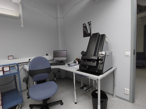

Nikons (while praised) are not the speed demons you can get. We have some seriously fast stuff at my workplace
but we are doing mass digitization of books and newspapers, so we need the speed

What kind of scanner is that??

Looks like a very specialized niche company , very cool, I am interested in scanning large volumes of film, 35 and 120 that has been cut in strips.
I bought a fuji 2500 for this purpose but it is quite cumbersome to use and we are always on the lookout for roll film scanners with current software and hardware.
thanks
Bob
its the Eclipse ... we have just phased it out because we were having trouble with jams when splices weren't perfect.
Its this one http://www.ristech.ca/eclipse-plus-production-film-scanner.html
