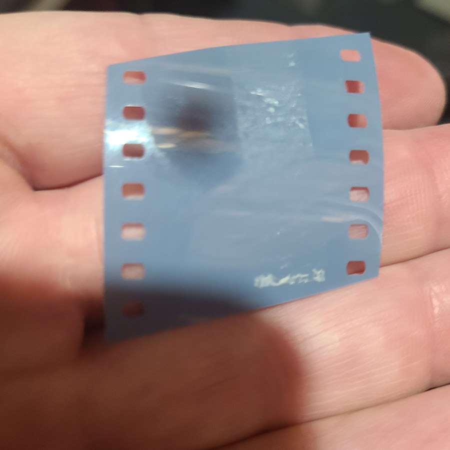

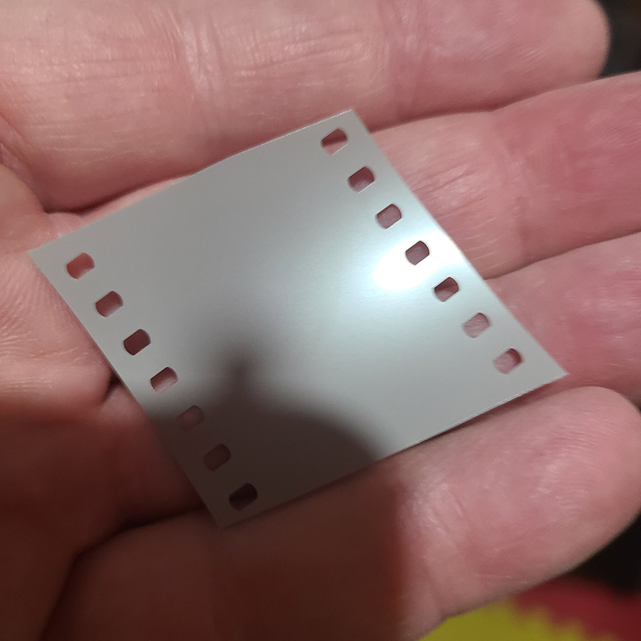

This is all I have. And yes I will put some through a camera at some point to see if there are any edge marks but there is no point if it's colour stock. If it's colour I will shoot some and take it in for development at a lab.
Batch number: 24ehw7x01
NB23

Ok, with this info I will load it into a cassette and give it a try. Should be interesting if nothing else.

Have you used this film?
Sure. Bad film, but interesting because of its lack of antihalation layer. Lots of ghosting.
No edge markings iirc.

Develop some without putting it through a camera. No point trying to use it if you don't know its speed. That said, it may have no edge markings. Develop in rodinal 1:25 for 20 minutes - that should overdevelop pretty much any film and show the edge markings.

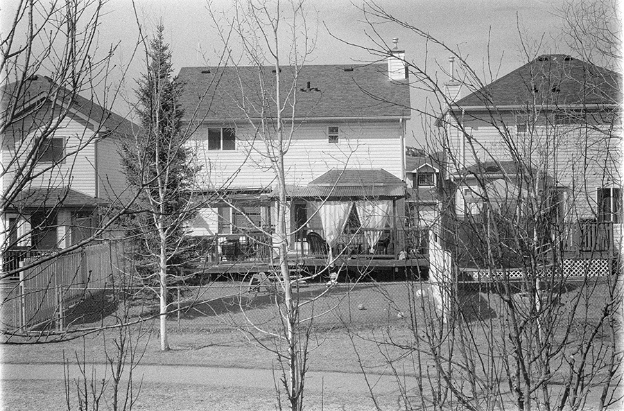

Just developed a quick test. Rodinal 1:50 for 13 minutes as per Massive Development chart. Shot it at 50asa and then increased the exposure by one stop until I ran out of f stops. I will wait until the film dries before making any final judgements but initially it looks like the optimal asa is around 70. So 50 is close enough. However even at 100asa it looked good. Once it dries I will scan it tomorrow and see what kind of tonality and grain I get.
I will shoot another test and develop with PyroCat-HD and see what shakes out there.
I have 600 meters of the stuff! There is no way I will be able to shoot it all before I go to the big darkroom in the sky. I think it might be good for kids learning black and white film though.
Or I can sell it to Cinestill for $5 a meter and they can pass it off as some kind of hipster film lol.

So here is an equivalent to 8x10 enlargement of the mystery film. I developed in in Rodinal 1:50 for 13 minutes as outlined above. As I would expect from Rodinal, it's grainy and probably more grainy than I would expect from a 25asa film. However it's not objectionable for certain applications. May next experiment will be to develop it in PyroCat-HD. The neg showed a good range of tones from blacks to whites. The shadows didn't go to black and the whites didn't get blown out. I will have to find someone locally that can shot a roll and develop it in Extol. I have some Microphen I will try as well. I suspect this film was used in police applications as it is quite sharp.
The house in the middle of the frame is white and the coverings on the deck are white with a light gray strip. While it was pretty sunny the north sky had darkish clouds.

As promised here is a shot developed in PyroCat-HD 1:1:100 for 9 minutes. I can not see any staining from the Pyro which is interesting in itself. The negs are full tone and minimal grain for a 35mm. In PyroCat-HD I would rate it at 32 rather than 50. That's interesting too as I have never experienced a loss of ISO with PyroCat-HD.
The image below was taken on a very bright day and the main subjects were very light in colour to stark white.
Comments??
