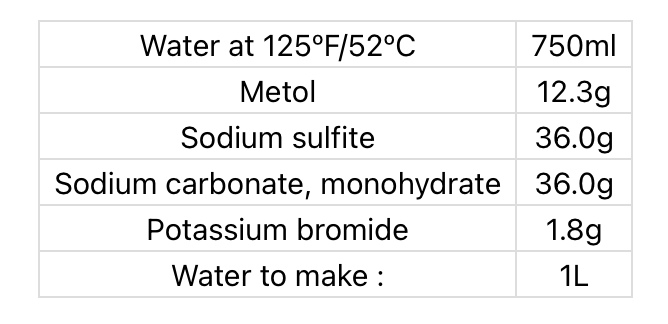

If you can't get it, you can try Ansco 120. It's a very simple developer to make. Note that it's low contrast. Use 1+1.
Similar to @koraks I've been primarily mixing id78 (assuming that's what he meant since id68 is closer to microphen) and it's good stuff.
