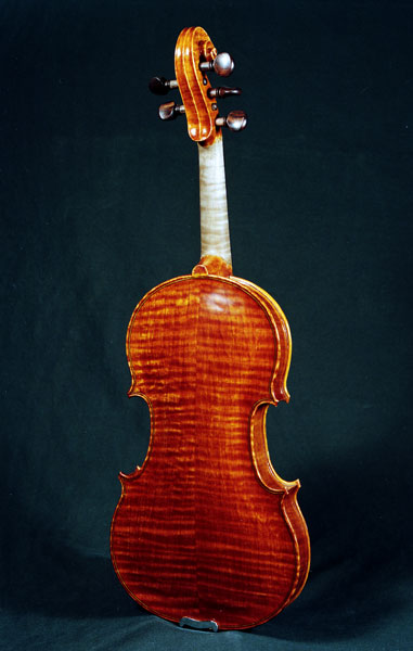

Would the 180 be a good lens to photograph my violins? After they are completed I place the on a table with a drop cloth and a stand to hold them and two studio hot lamps.
Here are two examples using my 90mm. Would the 180 be a better choice?
Your examples look good as they are. The 180mm will allow you to get further away and change the perspective.
As an experiment, you could take a shot similar to your first, then move the camera so the subject to lens distance doubles and take another shot.
If you crop and enlarge the second shot so the violin is the same size as the first, you should see the effect of the 180mm lens.
Obvious the 180mm lens will allow you to fill the frame from that position.
Steve.
2F/2F
Apr 29, 2008
8,034
Los Angeles,
Medium telephotos are generally my preferred lenses for product shots. I think the 180 or 250 would work quite well for your violins. Then again, you already have a 90mm, which does the job just fine. Maybe I would concentrate more on the setup and lighting quality for now than on getting a new lens. IMO both of these things could be better in the pix. A longer lens would eliminate more of the background, which would be nicer, IMO.
Probably your best choice would be the 127. But.. all three lens will do the job, the film format will allow you to enlarge to whatever you need with little decrease in quality.
My favorite rb lens? the 65. then the 127 (so damned sharp) The 50 never quite does it justice, and all others are too tele for my likeness. But then again, I have always been a 35/105 shooter in 135 format.

I have a 127mm and actually like the framing with the 90mm better when trying to get the entire violin in the shot. If I am just trying to get a shot of the body the 127 is excellent.
