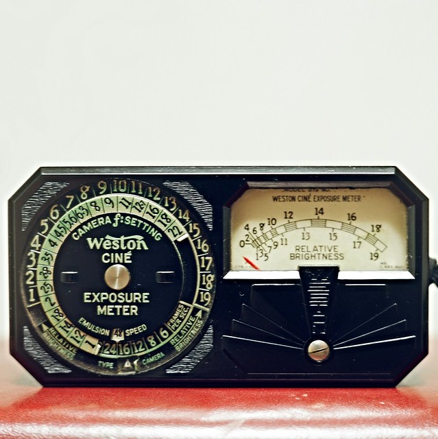

I have a Weston Cine Exposure Light Meter model 819 made around 1937. I think it's basically the same as your model 650, they just change a few things on the dial for cine exposure . I've had it over a decade, it never worked, so I put it on a shelf for display and kind of forgot about it. Recently I was looking at it and its working great. Sometimes after being stored in the dark for a long time they just need to see some light for a while to get going again. I still need to check it for accuracy.
Weston Cine Exposure Meter by Bryan Chernick, on Flickr
