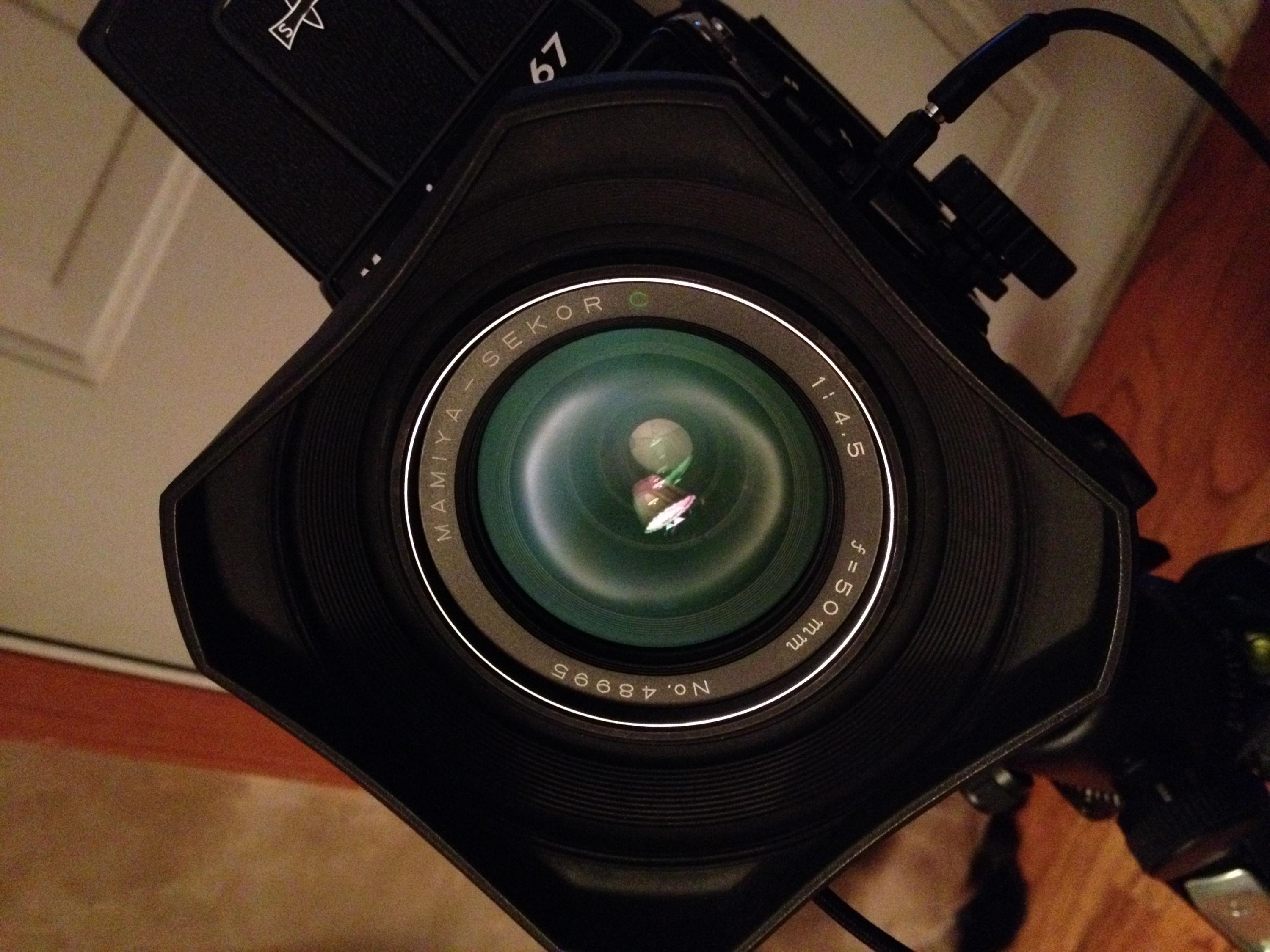

Hi, I'm hoping someone here can give me a quick idea of what is up with my lens. I'm new to shooting, developing and printing B&W and have been playing around with medium and large format for about a year. My previous experience was with 35mm. I purchased an RB67 not too long ago, and wanted to purchase a 50mm lens for it. I saw one on ebay that looked good (it was described as mint, specifically purchased for one photoshoot) and when I received it, it did indeed look good. I've shot a few rolls, and other than it being slightly soft on occasion (which may be me or may be the lens - at this point I'm not sure I've paid enough attention to the floating element) it looks pretty good. My only question has to do with a "ring" or a "halo" I see when I view the lens at a certain angle. I have no idea what it could be - it doesn't look like separation. To my untrained eye, it looks like the antiglare coating was applied but not to the whole lens. I have attached a photo link. I'm wondering if this is normal-ish and nothing to worry about, or if I should look for another specimen of this lens. Thanks for any input, and I apologize if this isn't the best place to post this. I didn't see a forum to discuss equipment, other than antiques.

I can get all sorts of weird reflections in my copy, but I can't get any 'halo' effect. Can you see any evidence of it from the rear?
May 28, 2015
34
None that I can see. I can't even see it if I'm looking directly at the lens from the front. I'd say it's something with the back side of the front-most element. It's very apparent when you see it, like in the photo. I'm probably just paranoid. :smile:

I noticed the 'halo' you're referring to is not perfectly round. What happens when you look at it so it's visible then you rotate the lens along the optical axis? Does the halo turn with the lens?

Yes, it appears to move when the entire lens rotates. It doesn't move at all when I adjust the floating element.

I agree, it doesn't look like separation, but it might be haze. That's all I can think of, and since you mentioned the photos were sometimes soft, that would be my guess based on your one photo here.

Then I'd say there's an issue with it. Maybe haze. Maybe coating separation. Maybe fungus. Might even be fungus etching.
I would think flare or reflections would be round, and not appear to rotate with the lens. I'd be sending it back.

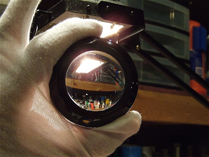

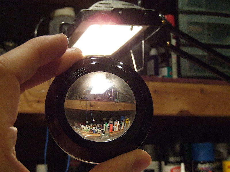

Below are before and after pictures of a Fujinon SuperWide 125mm that I was able to salvage. Looks "Mint" from the outside but KEH appropriately listed it as "BGN." The haze wipes off easily, the damage stays. In this case it was worthwhile, but there is residual permanent damage.

The ring's not normal and may be permanent. Or not.
I've got a couple of junkers around the house that have similar marks that are not removable.
It could be residue from condensation being allowed to dry. It can be rock hard.
