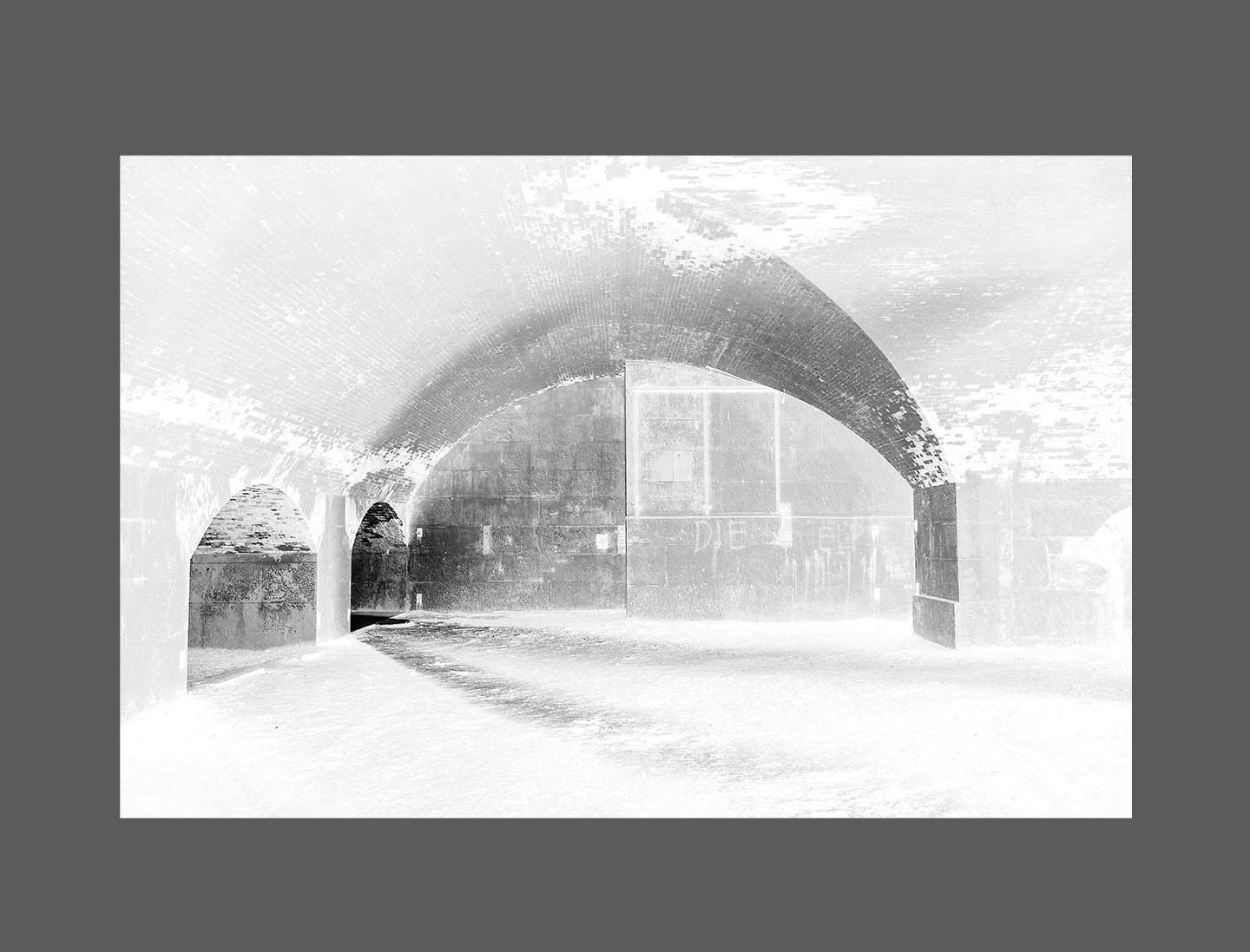

Don't know if anyone has any ideas as to what the problem may be. I've made a number of successful digital negs using Dan Burkholder's template and instructions. Have made a dozen fine negatives that have used to create kallitype prints. Today I created a new negative using the template like I always have. I set the template to provide a black masking border so one doesn't see brush strokes around the printed area, just white. Today for some reason the negative area prints fine but the mask area, which appears full black (inverted) on my monitor, prints out to about 80% grey (inverted). Four attempts have all come out the same. Good amount of ink in highlight areas within the image, masking area is anemic although it looks fine on the monitor. Even tried printing a copy on regular paper on my HP all-in-one. Print came out fine, masked area is full black. Why won't it print black on my #%$*? Epson R3000? Printer is set per Dan Burkholder's recommendations and I've made a dozen successful digital negs with this same template recently. First time I experience this frustrating problem. No streaks, lines or anything to indicate it's an ink or printing head problem.

Thank you, Mike, I've thought of rubylith, quite familiar with the stuff. What has been easier up until now was to simply print a black masking border. The problem isn't that some light can get through it. The problem is that the masking border looks black on the monitor. It prints black on paper through my little all-in-one. It's printed black on this same printer with the same OHP product before. Now instead of black it prints a very light grey. Everything else within the file prints as it should. Areas within the image area that have the same density value print fine. Only the border prints much too pale.

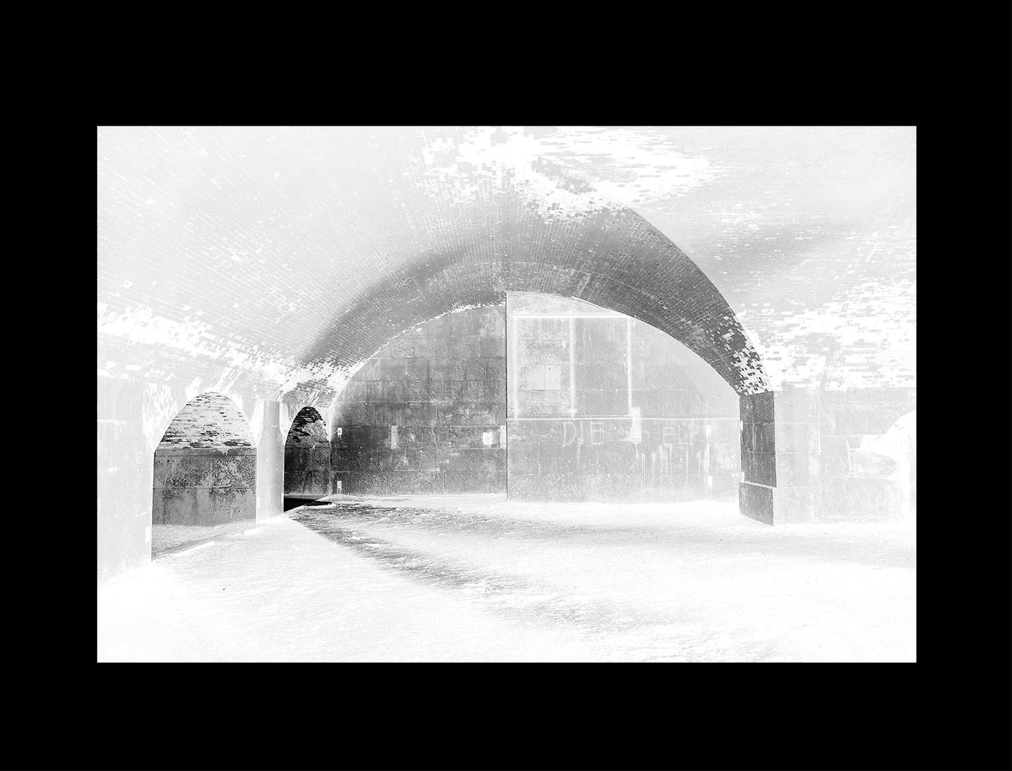

Maybe this will give everyone a better idea. It looks like Example 1 and should print like Example 1. Instead it prints like Example 2. Note that values within the image frame are correct.

What program are you printing from? What ICC profiles are you using? Are you converting the colors of the negatives? How are you adding the border?
Sometimes Photoshop can do some weird things to colors, especially blacks. It's even worse about this if you convert files between RGB, Grayscale, and CMYK. For instance, if you have a CMYK rich black and looks to be a really solid black (lets say C=30, M=30, Y=30, K=80), it will often convert it to something like 80% black if you convert it to grayscale. Also, sometimes your printer's ICC profile might adjust these colors from what photoshop says. And sometimes you can look at a file in PS and use the eyedropper to measure a color, save the file, and measure the same color from the same file outside of PS, and find out it's actually a different color, if you try to print it from a different program. PS is really bad about switching colors around depending on the profiles you use. And if the black border is imported from another file (like if you have the border saved in it's own file and aren't recreating it every time) and it's not made using the same color mode with the same profiles imbedded, it can change the color. In other words, there's a lot of places behind the scenes where it can go wrong that would cause this.

I am printing from Photoshop using the same ICC profile, printer, color space, print driver settings and all other settings that I've used for a couple dozen identical files printing on identical material. Negative is created with Dan Burkholder's template which is the same thing I've done before. All of a sudden the border that was printing correctly as black yesterday morning would no longer print as black yesterday afternoon although everything else within the image area was normal. I am going back to square one, starting from scratch to see if that resolves it. I'll also print an earlier digital neg file to see if it's the printer or the new file I created. Again, the weird thing is it printed fine on regular paper on a crappy all-in-one so it doesn't appear to be the file. I'm also replacing a couple of ink cartridges to see if it's ink related.

To me it does not make sense that the only the black border (where the RGB are 000) would print gray selectively while the same input values prints "fine" in the image negative. That's why I asked if you printed a step wedge, preferably with your border.
Agreed, that's what prompted the question. I used to include a step scale in earlier negatives until I developed a workflow that gave me an acceptable tonality range, then I eliminated it from the dig neg template. I still think the problem is a conflict in the layers so I'm starting over again with my dig neg workflow and want to develop a way to produce my own PACs instead of modifying Burkholder's.
I would simply start with an inverted image with the border without correction layers of any kind. Print and see if the border is gray. Then add the layers one at a time. Still confused though: Are you saying that after all the layers, inversion, flipping etc, the border area measures (with an eye-dropper for example) RGB of 0,0,0 and prints 80% gray only on the R3000 and not on other printer.

That's about the size of it. Good idea on printing inverted image without correction layers. Glad I'm using up Pictorico film and not wasting platinum prints. Maybe this is just my printer's way of telling me it's time to upgrade to a P600 or P800.
