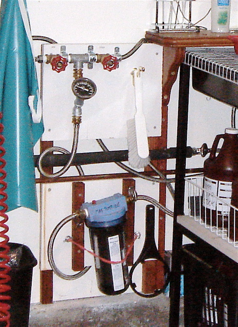

It is not the Delta that you have mentioned, but I have the following:
Delta Water Temp II with Temperature Lock (approx $59 B&H)
http://www.bhphotovideo.com/bnh/con...867&is=REG&addedTroughType=categoryNavigation
I have attached (I hope) a photo of how it is plumbed. It's not a very good photo, but I have a filter in line after the thermometer. I bought all of the other parts at a hardware store. It's not very pretty and I don't know if this is the right way to do plumbing for a darkroom, but it has worked for me and I'm quite happy with the cost and functionality of the Delta. No it doesn't automatically correct the water temperature, but I keep my eye on it and it doesn't really vary much unless I spend too much time in the darkroom and start running out of hot water. :smile: I must note, however, my darkroom is in a separate building from my home where the darkroom is the only use of water on that hot water tank.
