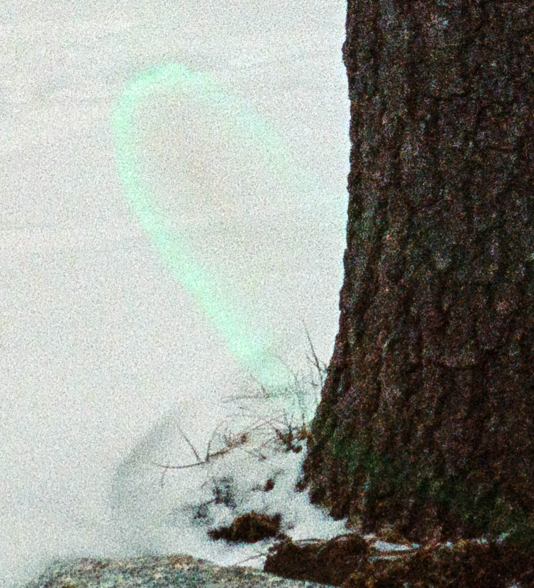

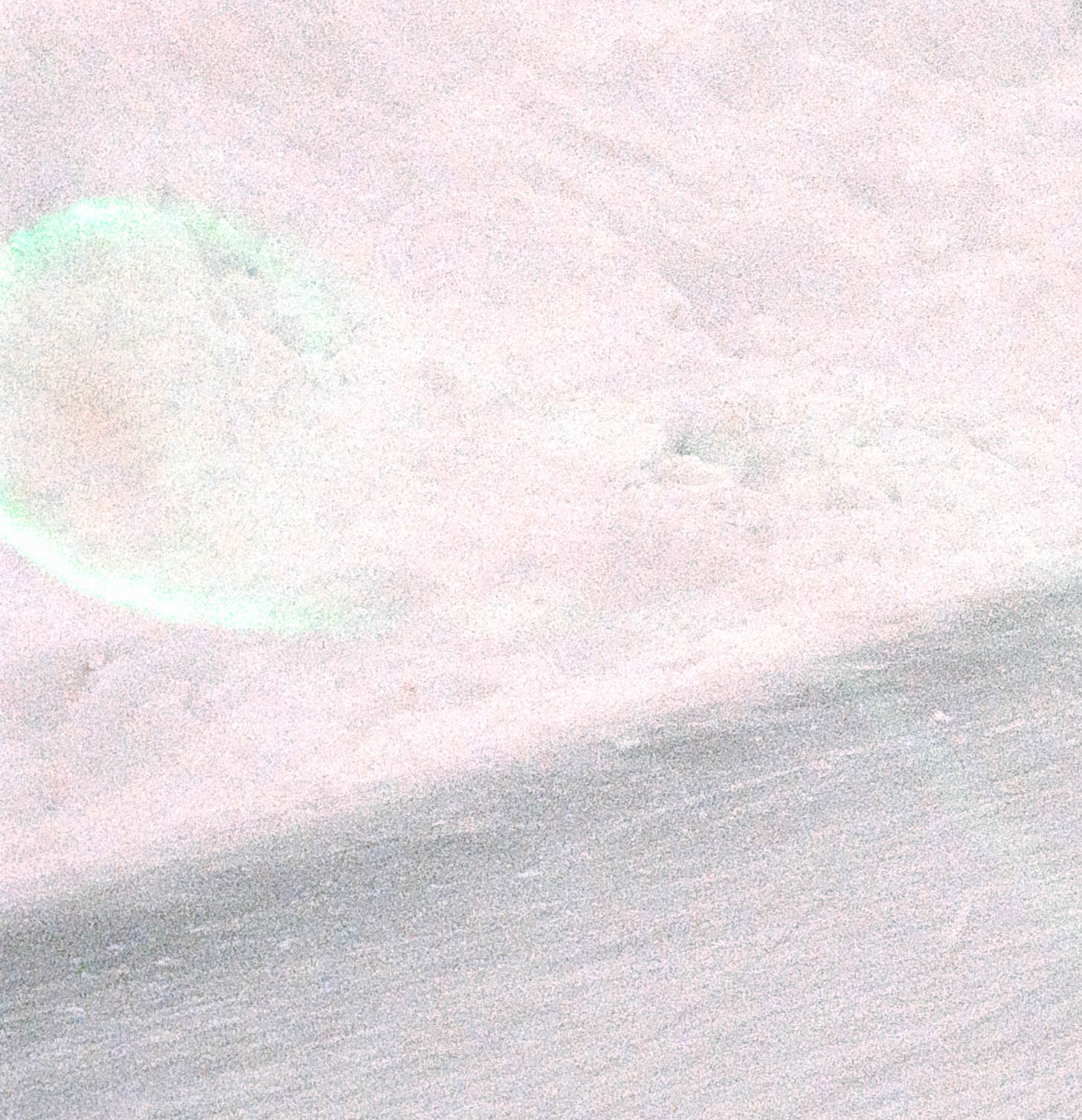

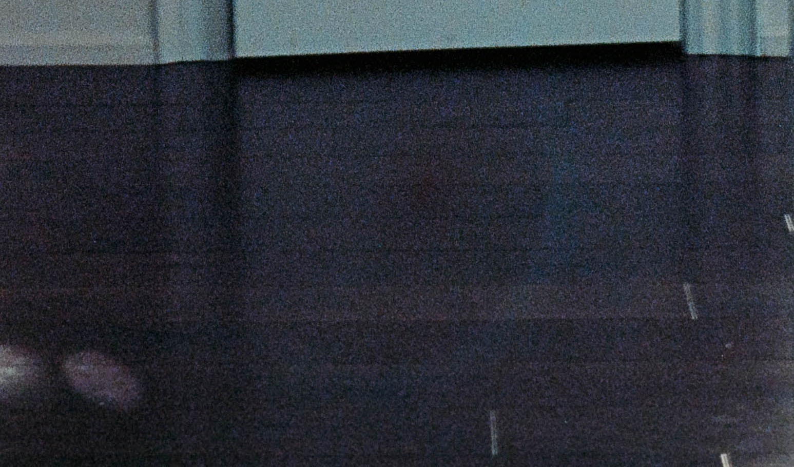

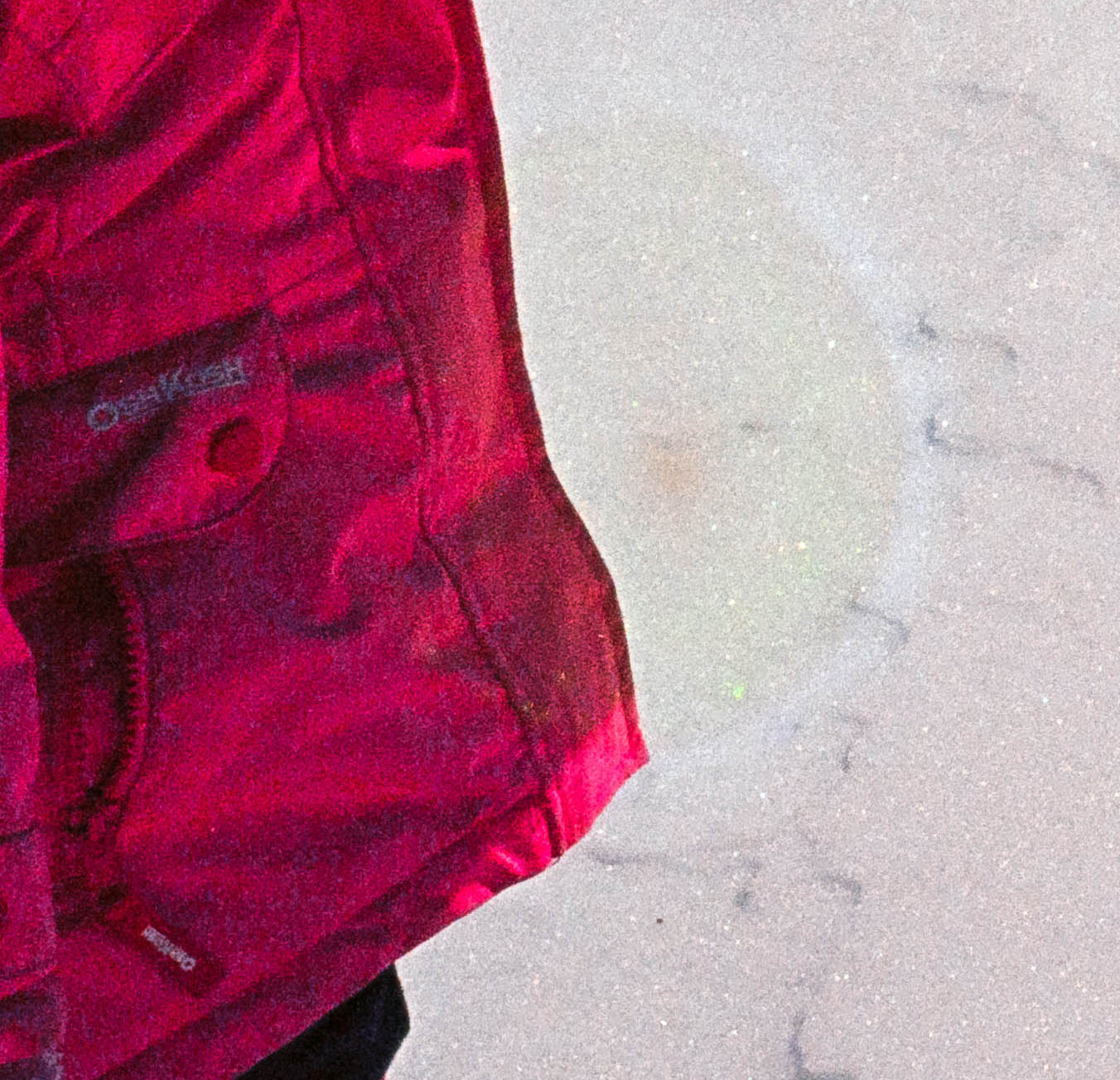

I've been having trouble with these spots on my last two rolls developing at home. These are sporadic throughout the roll. What's throwing me off is the green halo appearance. Is it from hard water stains or could it be something else? I check the negatives themselves and I'm not seeing any hard water stains that can be wiped off that correspond to these marks.
Pictures attached are from Portra 400 scan converted using NLP. I use Cinestill CS41 and I made the chemicals using distilled water. I wash with distilled water.

I don't know what that is, but it certainly isn't just a water/scale spot. Those are neutral density, while this is clearly on the magenta/red end of the spectrum. First thing it reminds me of is bleach, but that should have washed out with ease.
Can you tell us a bit more about your C41 process? Do you use a pre-bath for instance? Separate bleach and fix, or blix? Stop bath?

I didn’t use a pre-bath. CS41 Developer for 3 min 47 sec, manual inversions for first 10 sec then 4 inversions every 30 sec thereafter. CS41 Blix for 8 min; 10 sec inversion then every 30 sec thereafter.
I think you may be onto something. Previously after Blix I would continuous wash using my tap water for 3 minutes. I stopped doing that and used Ilford wash method instead with distilled water all in the name of avoiding hard water stains (where I live the tap water is especially bad).
Ilford wash: fill tank with distilled water, invert 5 times, then dump and fill again with inversion 10 times, repeat then inversion 20 times then I dry. I didn’t wait in between.
While that eliminated the water minerals showing up on scans completely, but I now seem to have a problem with insufficient wash. Could it be the bleach/fixer causing those marks?
I’ll have to resume tapwater wash x 3 min then distilled water after. Or can I get away with the Ilford wash and waiting some time in between dumping? I really don’t like the hard water stains. Thanks.

Hmm, I'm not to sure the wash is the problem to be honest. Having said that:
The essence in washing is not so much the agitation, but the wait time. Washing is a diffusion process, so you have to give the water some time to permeate the emulsion. The agitation mostly serves to prevent higher concentration 'pockets' of the previous bath remaining somewhere.
Don't worry too much about hard water being used for preceding wash steps. A final rinse of demi water will remove most of the dissolved salts. Personally I always wipe the shiny side of 35mm film after washing (even with distilled water); it's the only way I get perfectly clean film without any spots whatsoever. We all have our own wash routines; try to figure out what works best for you. This part is no different from B&W btw.
Were the reels and tank perfectly dry when the film went into them? I.e. no chance of droplets of a previous bath/water falling onto the film as it sat waiting for the developer? What kind of tank do you use?
I have no experience with the CS chemistry; in principle a blix should work just fine and I'm not aware of similar problems to yours with this chemistry. @Tel's remark about the final rinse is so far the most concrete lead I think. Try leaving out the conditioner/stabilizer. As @Tel remarked, a stabilizer isn't really necessary with modern C41 films. You can just do a final rinse with distilled/demineralized water with some photoflo added to it.

If you get droplets of water onto the film before development, it's virtually certain to show up. Since the film is already wet in those spots, there will be a difference in how quickly the developer permeates the emulsion and starts to act on the silver halides, and hence, the effective development time/degree of development will vary.
Especially that final image of the diagonally oriented spot makes me suspect the above is a possible cause, since anything that drips off the film as it's hanging will generally be oriented longitudinally.
A better wash of course never hurts.

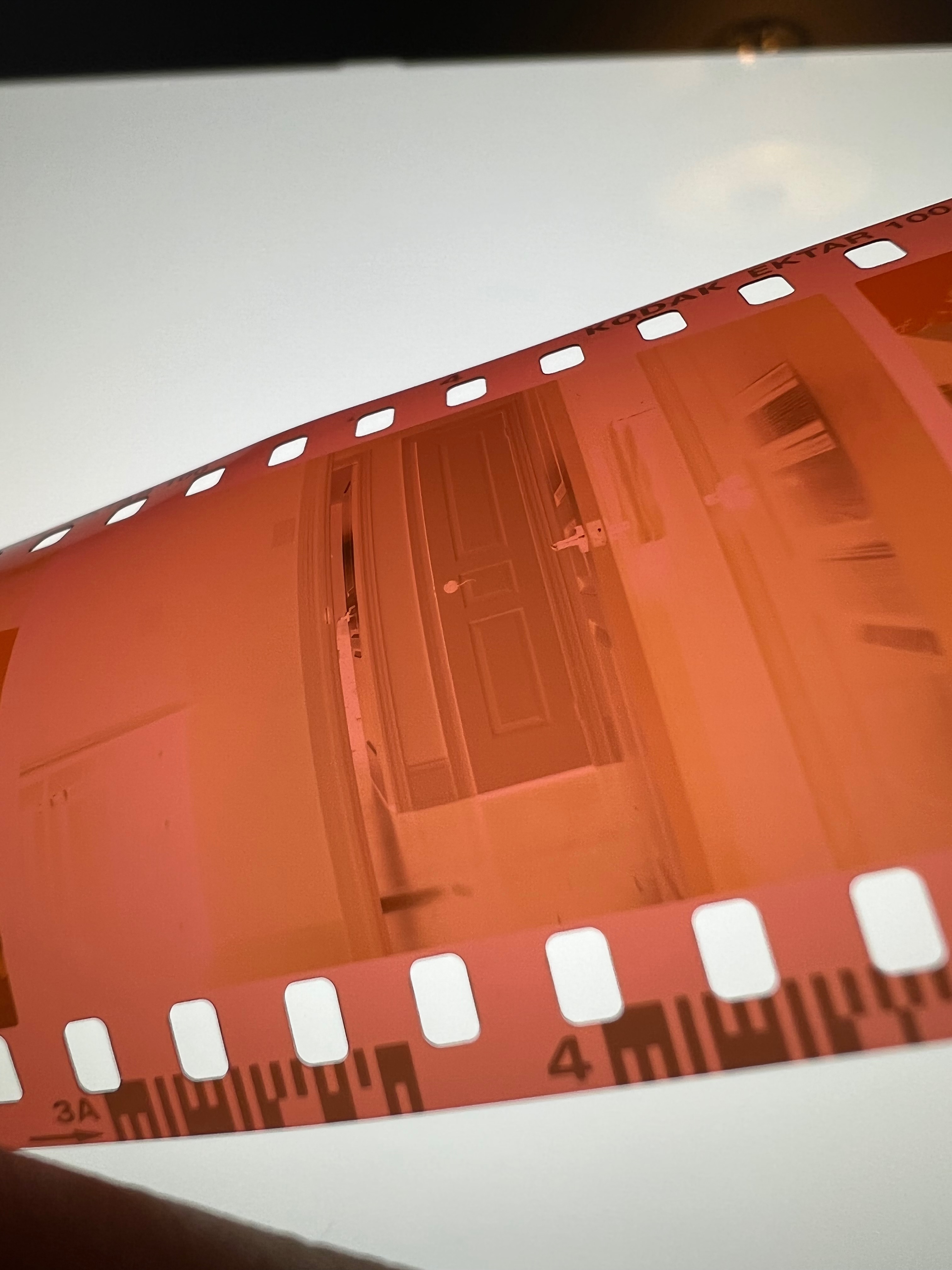

I wonder if could it be where the negative almost touched on the spiral during developing.
See this image of the negative.

I can't deny that it may have happened. I use the Job 1520 and the reel that comes with it, and working with this reel has been quite frustrating compared to the Paterson reels.

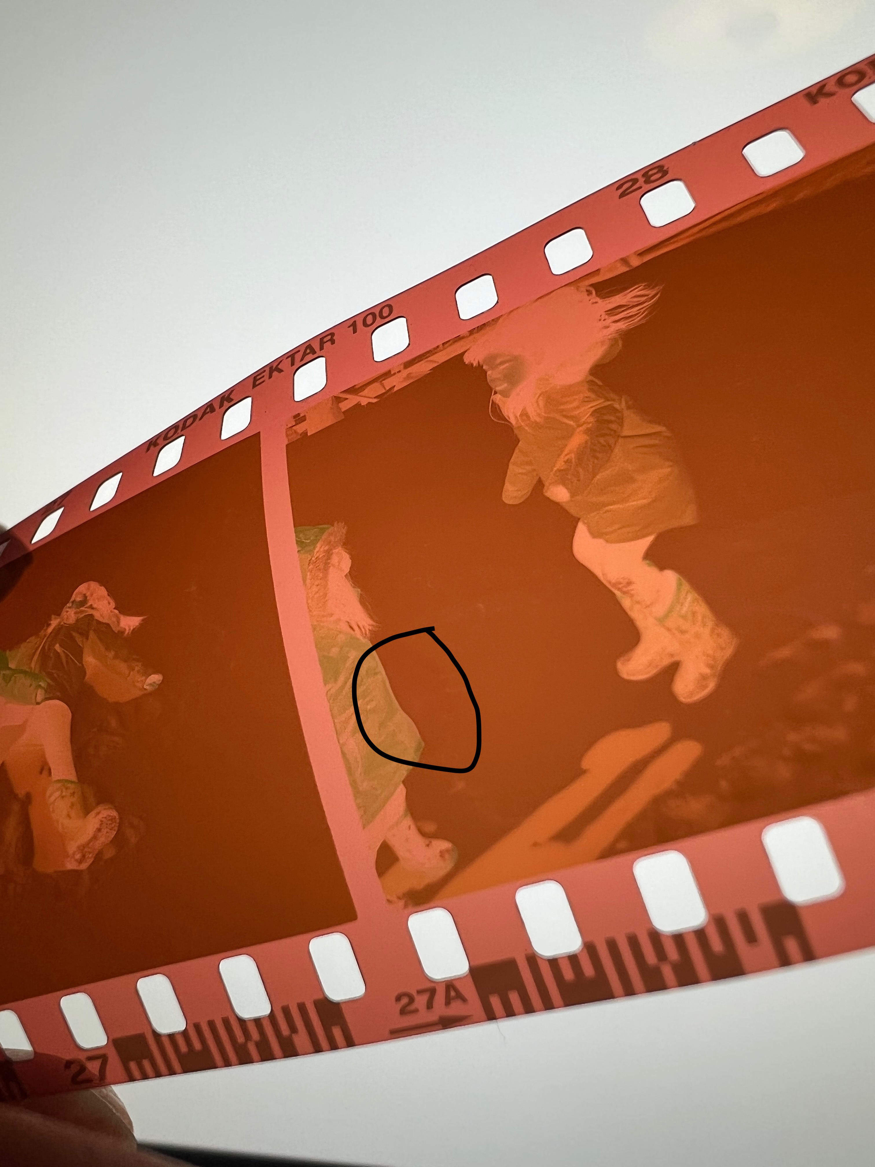

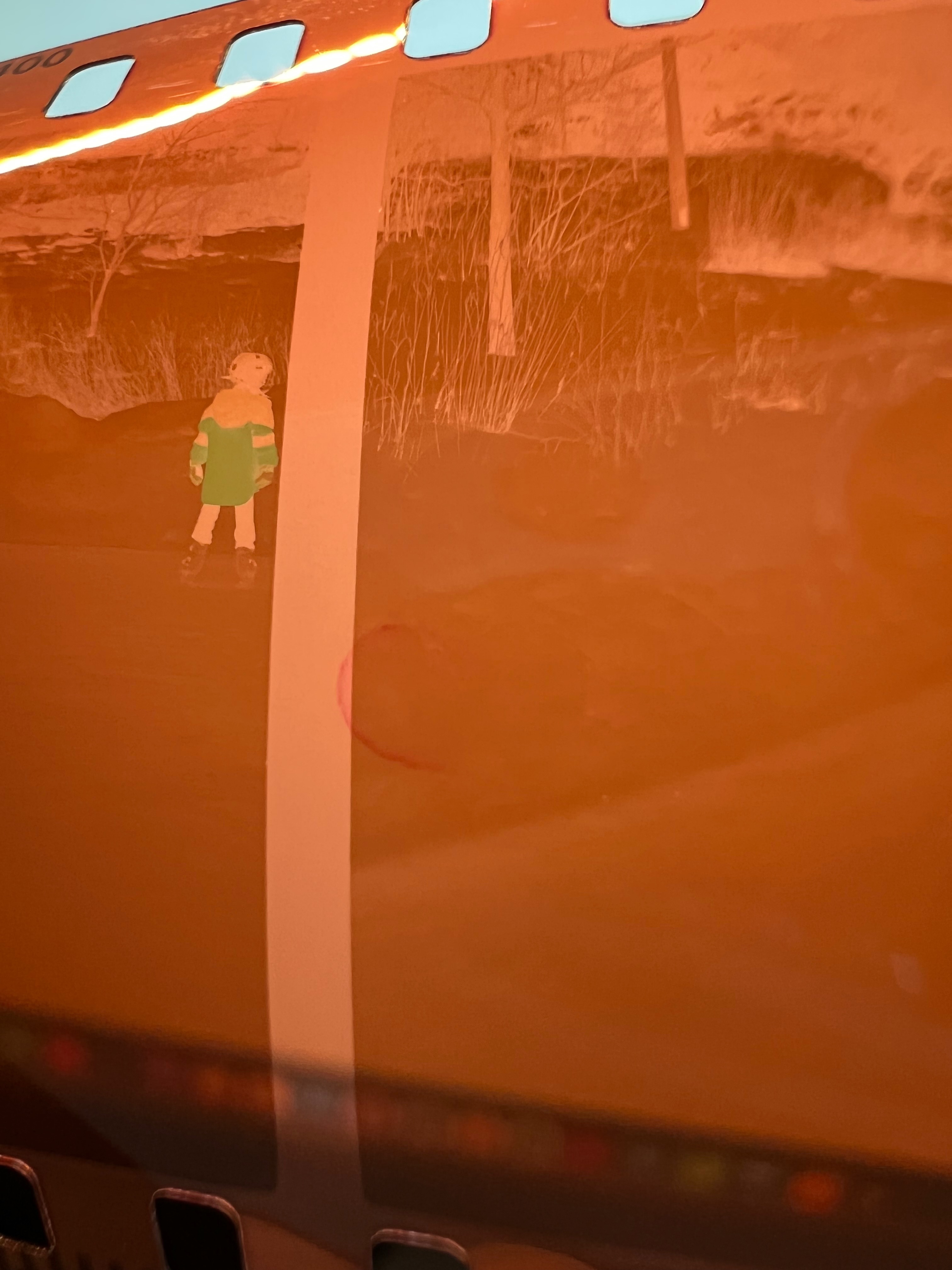

The good news is that the marks are greatly minimized to two frames. The bad news is that they're still there. I'm happy about the results however.
I have yet to make the stop bath so the only difference is the pre-soak in the beginning and the 3 minute wash + Ilford wash distilled water.
The first picture shows the same kind of mark seen in the original post.
The second picture shows the negative in the immediate drying period right after it was taken out of the reel.
I see that the mark on the scan correlates to the substance circled pink on the negative.
Is the milky substance on the negative something to worry about? It seemed to have dried and disappeared completely except for the mark left behind.
Addendum: Please note I hang my negatives diagonally.

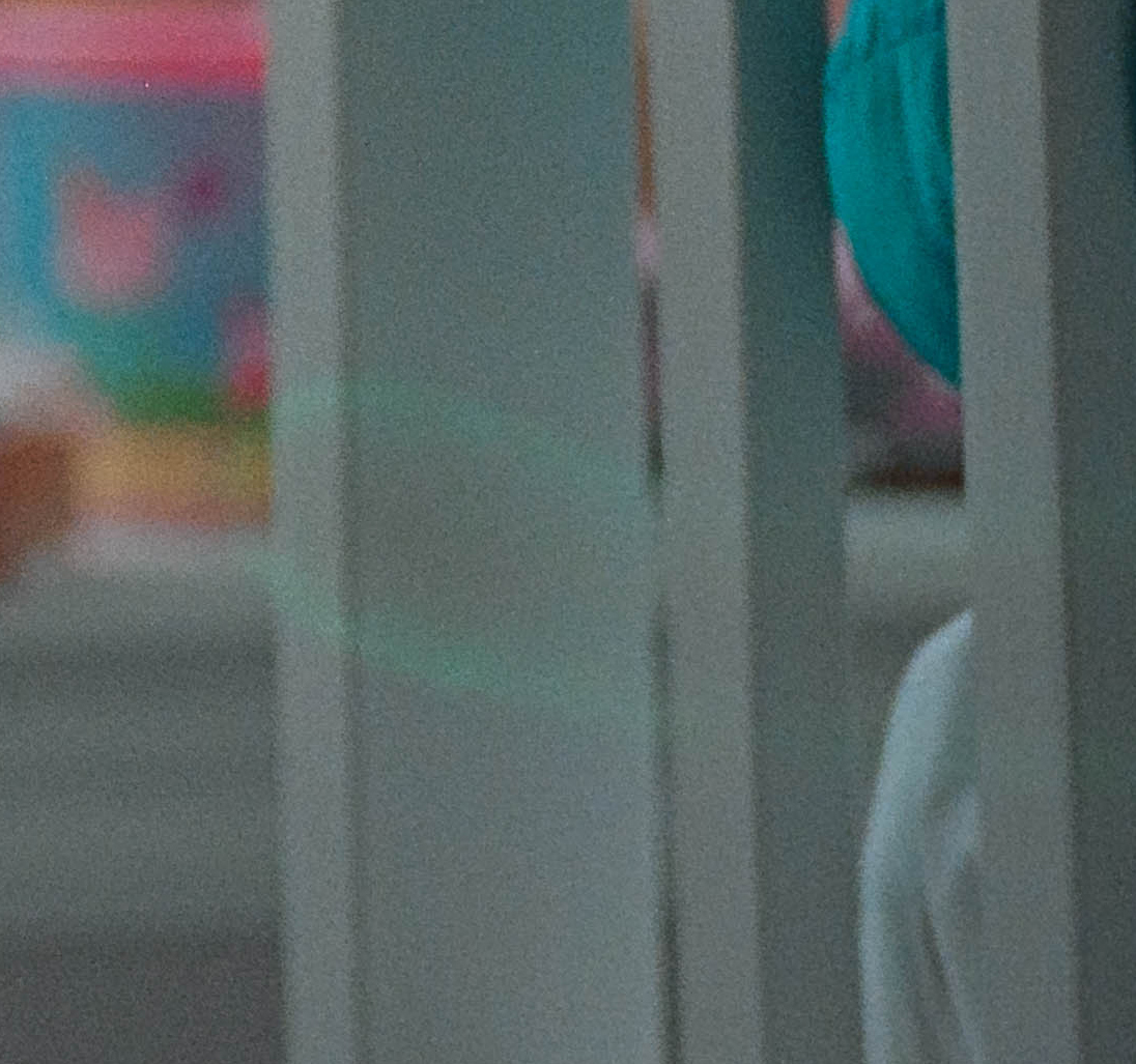

Attached is a picture from the other frame this mark was seen.
The other frames turned out fine thankfully.

Can you post a photo of it when it is fully dry, please? (wet negs can be hard to judge)
Sure. Negatives dried quite well with no remnants of that substance, however, in the first picture you can see the mark it seems to have left behind.
I'm still not sure if it's a washing/drying issue or a pre-soak issue. However, pre-soaking seemed to have helped greatly thanks to the advice here.
Cinestill's reply:
"Thanks for reaching out to us and for including some pictures. From the look of the negatives, the actual chemical development seems to have gone fine. Image area looks nice and dense and the unexposed film base is nice and translucent.
The fact that these markings register as magenta-colored density on the negative (green in the scan) could mean some kind of light leak, but I've never seen that shape before. I'm honestly a bit stumped and would encourage you to reach out to Kodak as well. Perhaps they could shed some light onto this."
I might reach out to Kodak but I don't think it's a Kodak issue, as this happened with Cinestill 400D as well.
Any ideas?

Frankly, it looks like the film wasn't fixed.
Yeah it seems that way. Cinestill process uses blix. I’ve emailed support the picture of the white substance for troubleshooting. However, it seemed to dry fine with no residue except for the marks.
The blix was newly mixed. This batch I’ve overdiluted to perhaps 50-100 mL at worst by accident (instructions say mix to 1L). Could this be the issue?
