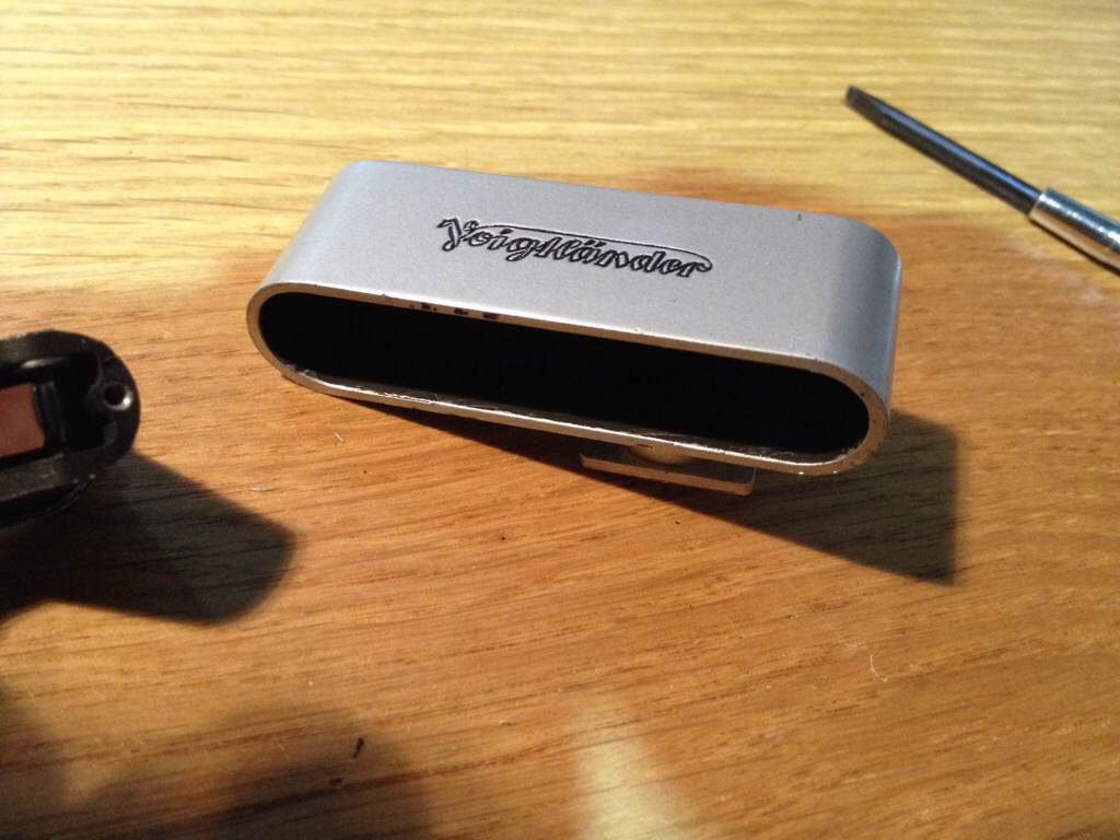

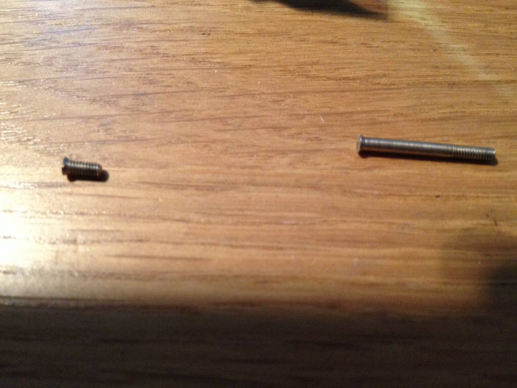

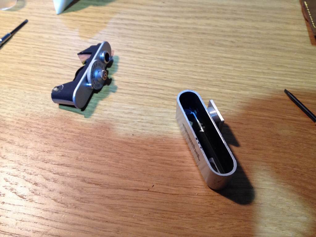

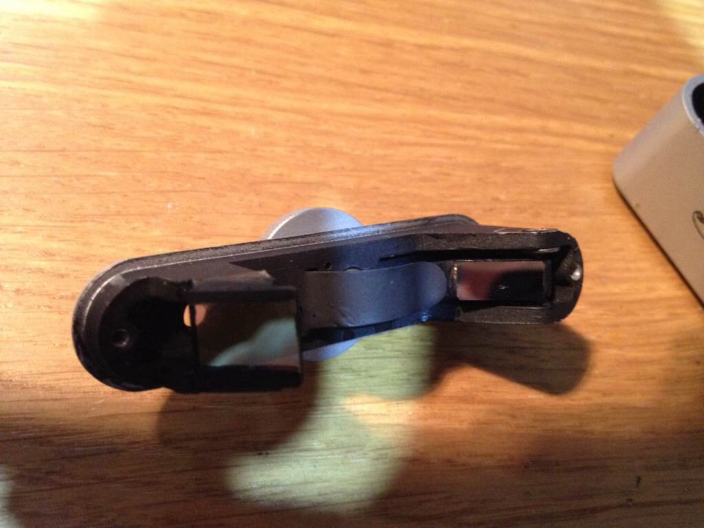

It is rather hard to open the voigtländer rf accessory after unscrewing it. Today I've tried again inserting in the holes leaved after removing the screws, a toothpiece. After removing the tips you push with attention ande the two part of the rf separates a bit. At this point you use a thin screwdriver to separate more the parts. Then I've cleaned the dirty optical surfaces with a cotton fiocc abd a lens cleaner for glasses (very very gently). Soon after very gently I've dried with several cotton fioccs. The redults have been impressive. The rangefinder is now extremely sharp. Delicious. Great Voigtländer!
I hope I've been useful to somebody. ImageUploadedByTapatalk1384880845.098304.jpg ImageUploadedByTapatalk1384880859.247183.jpg ImageUploadedByTapatalk1384880870.880640.jpg ImageUploadedByTapatalk1384880882.862704.jpg ImageUploadedByTapatalk1384880908.533240.jpg
