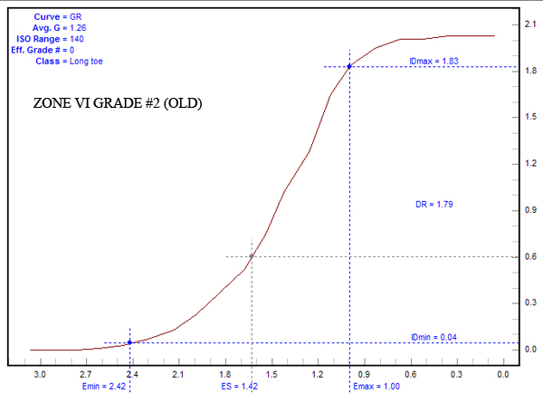

I finally had some time to do some BTZS testing tonight and found something very interesting.
I recently purchased 3 boxes of "Old" Zone VI Brilliant Grade #2 FB Paper (Pre-Calumet) that had been stored frozen.
I tested this paper along with fresh Zone VI Brilliant VC FB Paper.
The interesting thing is that the "Old" Grade #2 paper has the same curve as the VC paper exposed with NO filter.
Jim

That may be true, but not all no. 2 papers behave like each other, so I think Jim's observation is worth noting, for admirers of the old Zone VI Brilliant.

I liked old Brilliant a lot for enlarging, so I'm interested in this. Donald has a very valid point - what light source did you use, Jim?
juan
The light source is a Beseler Universal 45 head using the V/C Controller in "Normal BW" (White Light) mode.
I have yet to do the test using my Zone VI V/C Cold Light Head, but I probably will just to see if the results are the same.
I am also going to make some prints on both papers tonight and compare the results.
I have never printed on "unfiltered" V/C paper before and I was really surprised to see that the 2 curves matched.
If in fact the prints "do" match it might be worth it for fans of the old Zone VI Brilliant paper to give it a try.
