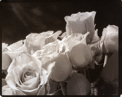

just so you all know there's a happy ending....
Congratulations. Looks like you have real good Dmax and nice clear highlights in that print.
Seems to have a lot of grain, though. Is that from the negative? Or am I just seeing things?

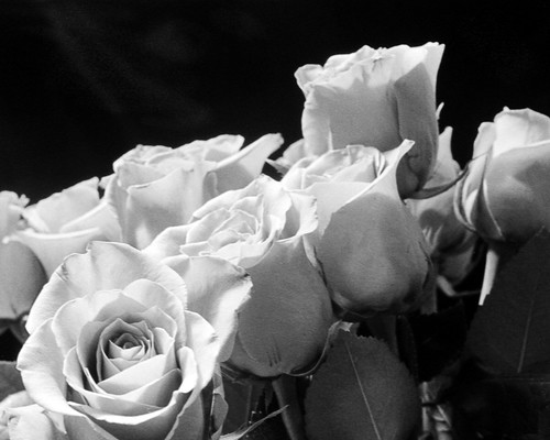

thanks sandy.
it's not the film, it's the printing. here's the original photoshop file (scanned from film and tweaked). it's not nearly as grainy. any idea what would cause that in the printing process? perhaps not quite dry enough?

The grain could come from too much drying during the exposure process. This certainly happens with Pt/Pd prints, where the paper dries out too rapidly because the light source is too hot. You end up chasing a reciprocity failure problem. Another possible cause could be a contrasting agent, if there is one for VDB. In Pt/Pd, using certain contrasting agents promotes flocculation (graininess) in the highlights.
Matt,
If the grain is not in the film it is most likely from the paper. Papers that don't have a good size will show this.
There are other things that can cause graineness with the iron processes, for example contrast control agents such as dichromate and chlorate. But this should not be an issue with VDB because you would not be using them anyway, right?
What paper is this?
Sandy
VDB, which is ferric ammonium citrate based, does not respond at all to the contrast controls we use with kallitype and pt./pd, which are based on ferric oxalate.

thanks FlyingCamera and Sandy.
i'm not using a very hot light. it's two blacklights in a fixture hung from the garage rafters, with a ladder holding the two sheets of glass i use for a contact printing frame. i've never noticed much heat from them at all. so i don't think it's drying unduly fast under the lamp. i can't say for sure though.
i'm not using any chemical contrast controls.
the paper i'm using is Stonehenge Rising. i don't do additional sizing to it, as i was under the impression it had adequate sizing already. should i?

I have been using Rising Stonehenge for Van Dykes with good results; I don't think that sizing is the issue.
Rippo, are you still using the older sensitizer? I found that dead sensitizer prints a little grainier but it also has no dmax which doesn't seem to be the issue with you.
Also, are you toning before fixing? If your using Rapid Fix, it can destroy your image and cause a grainy look.
