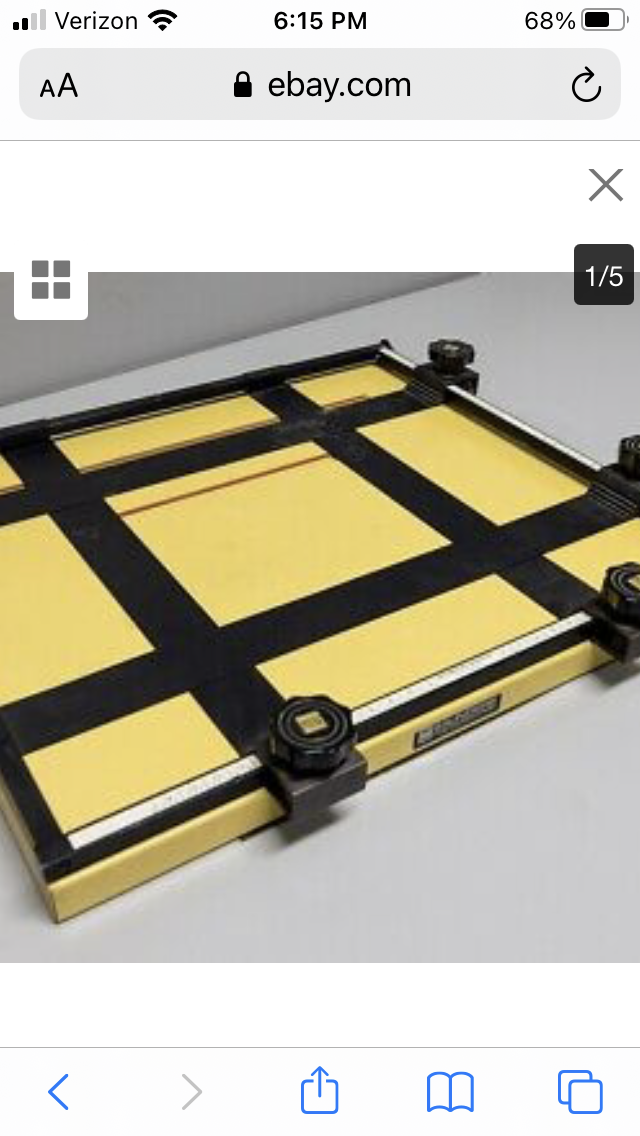

I put a piece of paper in my easel for a brighter viewing image. Focus before I take it out. I don't think it makes any difference in the real world.
Ditto. I need the white paper to focus properly.

What colour is your easel? And what enlarger manufacturer in their right mind would make an enlarger with a yellow baseboard. Is this for wildlife photographers who only photograph parrots?
warden
Jul 21, 2009
3,036
Philadelphia
I misunderstood. The baseboard is unpainted wood (beseler) and the easel is yellow. It’s a Saunders easel. It’s easier to focus if I use paper.

The easel is yellow?
The very popular Saunders easels (among others) use a relatively non-reflective yellow paint - I understand that it minimizes halation arising due to the enlarger light passing through the paper and then reflecting back through the paper again.

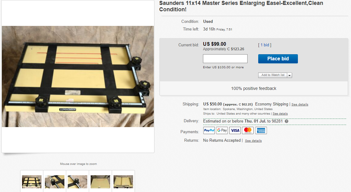

Speed Ez El's, vintage 1960s by AJ Ganz Co.
Saunders easel for 8x10" with flatter paper hold than Speed Ez El
I have a 2003 catalog from Calumet that shows 7 different models of Saunders yellow easels, each one available in multiple sizes.

The only thing I could compare a yellow easel with, is perhaps the Allegro launched in 1973 – with its now-famous Quartic (or square) steering wheel.
