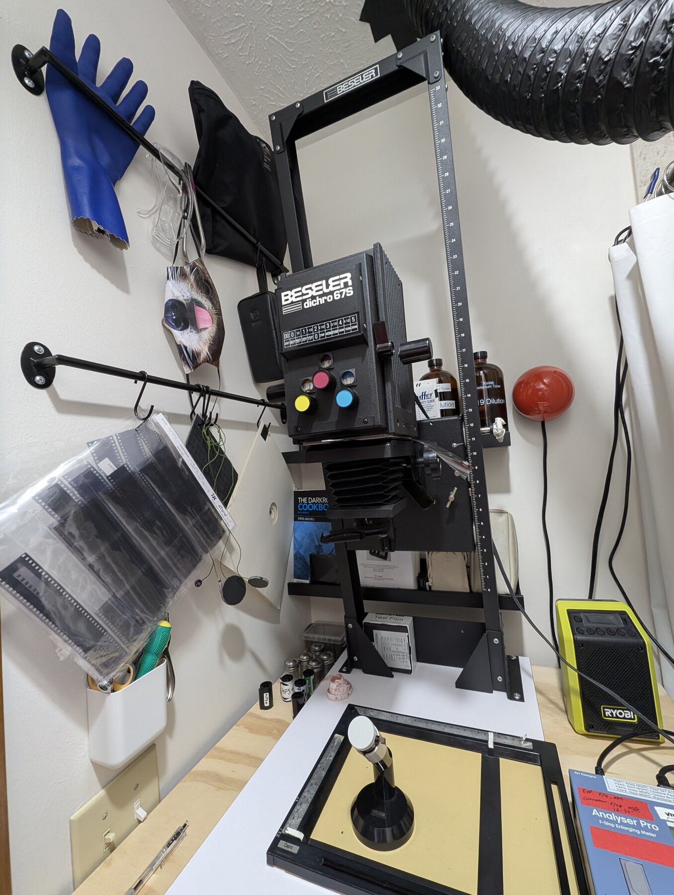

About a year ago, I upgraded my Beseler 67 from a condenser head to a diffusion head with Dichro color filters. I mostly print small, often 5x7, so I use a neutral density filter under the lens to maintain an optimal aperture and feasible print times. This has worked well enough, but I recently had a thought—could I use the dichro filters as a sort of built-in ND?
If the paper needs a grade 3 filter for the desired contrast I would set the magenta knob to 40. Alternatively, could I set the magenta knob to 200 and both the yellow and cyan to 160? Would this still give the correct contrast, while using the remaining joint density of the three dichro filters as an ND?

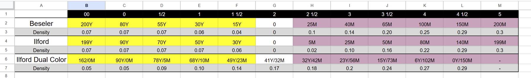

As you can see in the dual settings (which are meant to keep a consistent time) the difference in 0 (90 yellow)and 00 (162 yellow) maintains approximately the same time.

FWIW, when I used mine, I worked from the appropriate "speed matched" contrast setting table and just added equal amounts of all three filter settings to reduce the intensity - usually in increments of 30. 30 of course being a remnant from my days doing colour printing.
I know that the cyan was probably unnecessary, but it just seemed to feel appropriate!
Drew is almost certainly accurate about it being both not strictly linear - the contrast probably changes a very tiny amount - and the non-linearity not mattering enough to matter for B&W variable contrast work.
For black-and-white enlarging, you don't need to dial in any cyan. The paper is blind to red, so you don't need to remove it. Equal amounts of Y and M should get you neutral density, then add whatever extra you need for contrast on top of that. That will make the image a bit easier to see too.
Since you're testing for contrast as you go, there is no need to worry about how matched the increments are, just get to a reasonable printing time with equal parts of Y and M and then find your final contrast by adding more Y or M. EZPZ.
