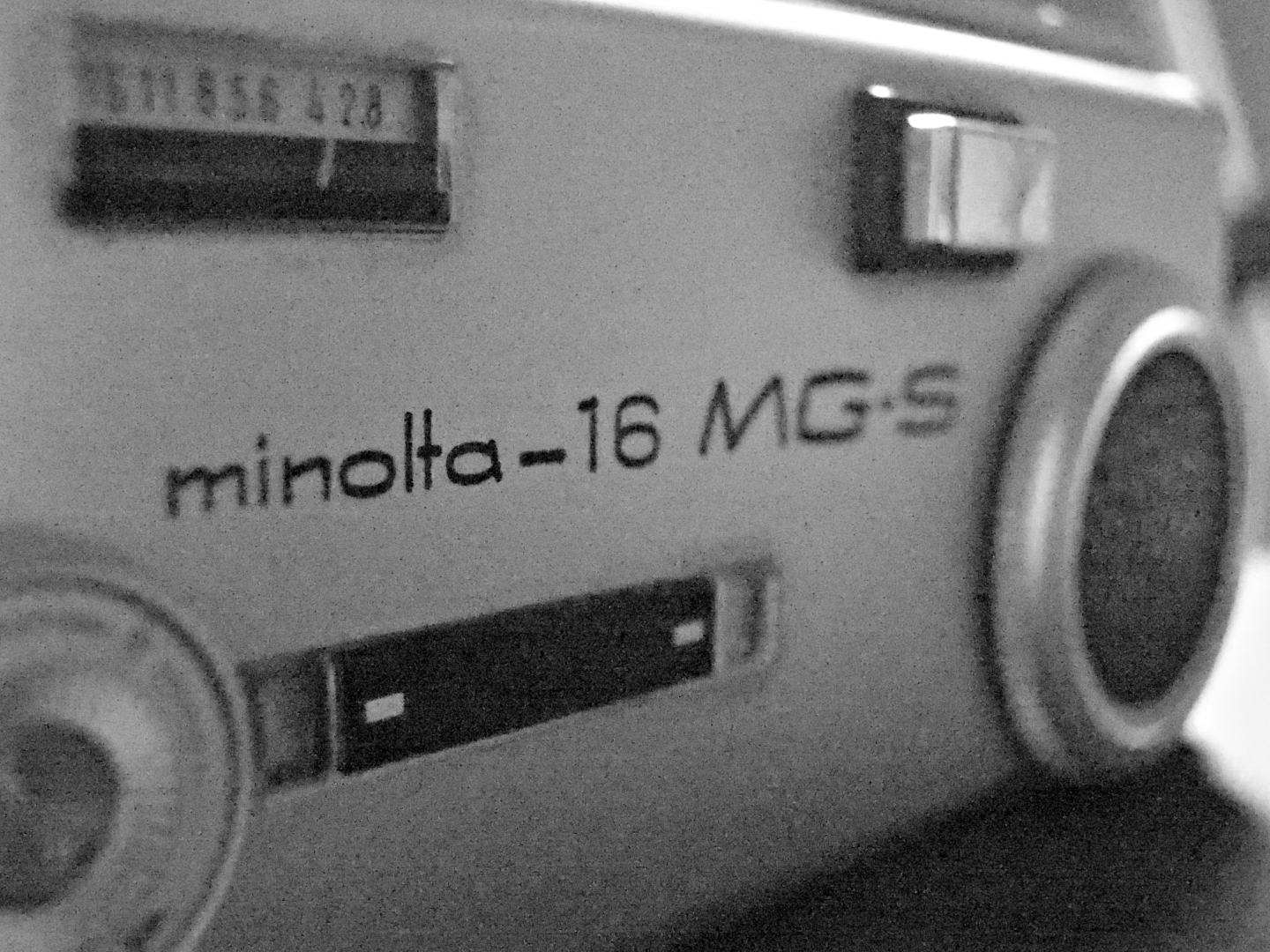

Come on, feel the noise
(P340, Hi 1, minimal noise reduction)
High ISO's in color photography are generally pretty nasty looking (except for certain special effects) but one of my favorite things is shooting max ISO in b&w. The smaller the sensor the better. Its an aspect of digicam performance that is often overlooked but can be appreciated by a film shooter.
