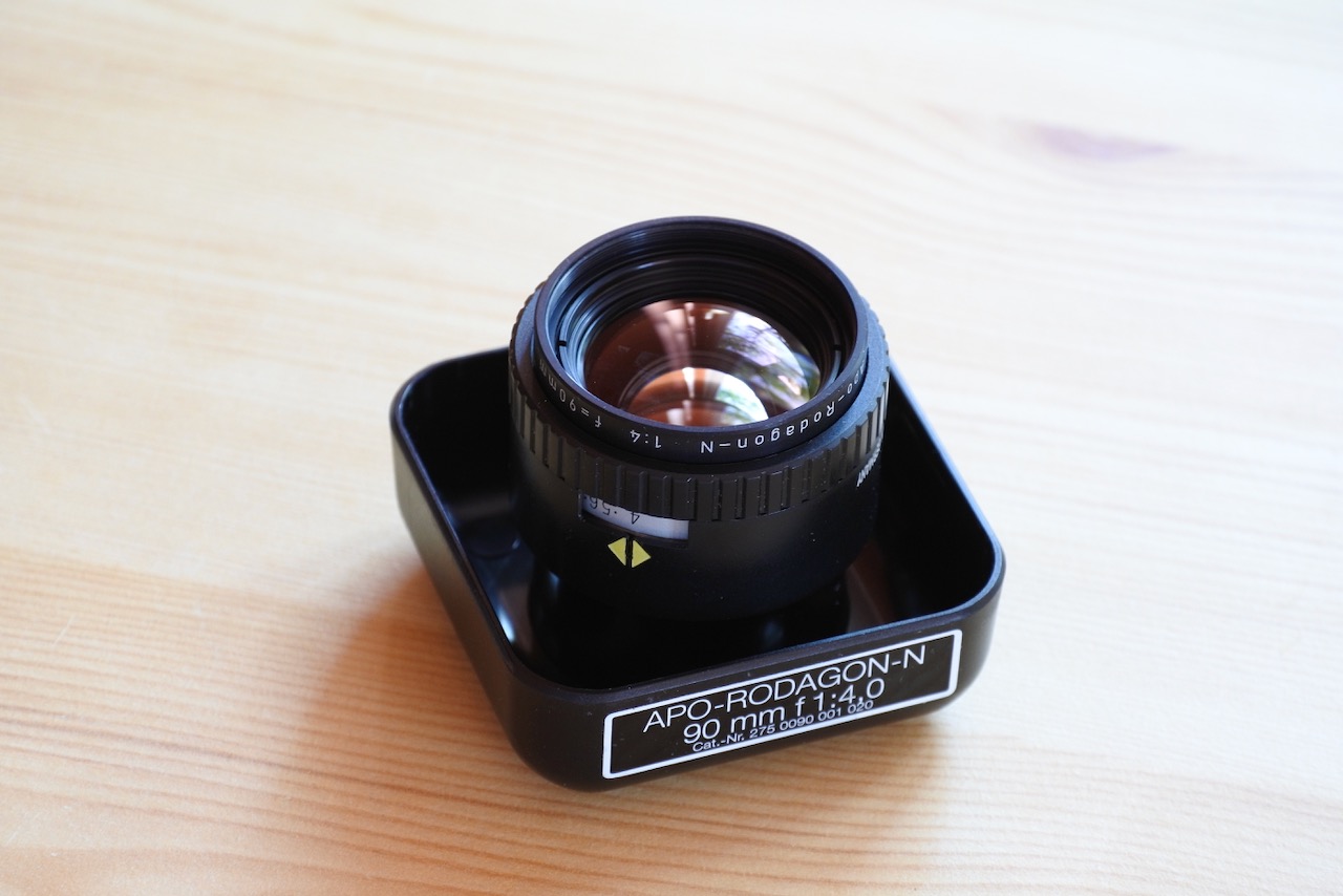

Many thanks to all of you for the helpful advice. My search for a new enlarger lens took quite a surprising turn. In the end, I decided neither for the Rodagon 80/4 nor the 60/4 WA, but found this beautiful Apo Rodagon N 90/4.

Lachlan Young
Dec 2, 2005
4,942
Glasgow
The 90/4 N is the newest & best of the lot.
