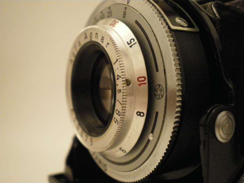

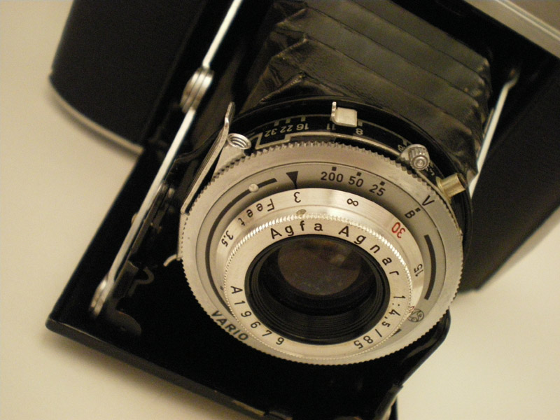

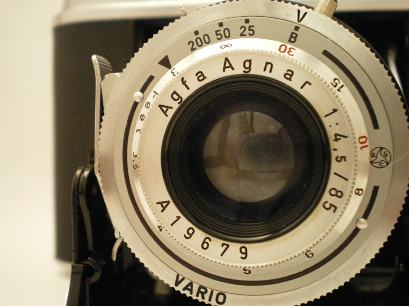

OK, so how do I get the lens off the shutter? Do I unscrew the 3 very small screws in the side of the outer ring? Here are pics of it. I figure I'm better off asking first.

If you unscrew the 3 very small screws in the side of the outer ring and remove that ring, you'll find a post screwed into the side of the front cell that limits travel while focusing. removing that allows the front cell to be screwed off - assuming, of course that anything is movable given the frozen focus. Don't lose those set screws! They're little buggers and easy to drop. With the cowl off it's easier to apply some torque to the front cell as well.

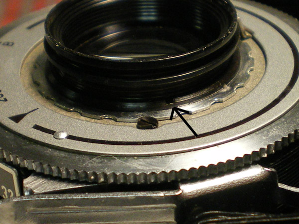

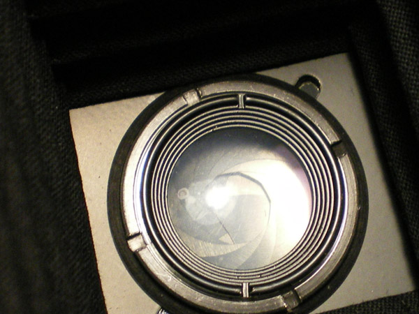

OK, the outer retaining ring (with the focus distances on it) came off easily enough. I still haven't managed to loosen the lens at all. To take it out of the shutter, do I need to undo the apparent retaining ring? There are slots in a ring that look like a spanner wrench would work on them (both inside and out - see photos). Do I undo those?

The retaining ring inside will drop the entire shutter out for you - useful if you need to give the thing a bath in solvent, The arrow pointing in the other shot is a somewhat enigmatic to me... I don't get what it's really pointing at as it appears that no spanner wrench could realistically get around the top of the cell and down to a ring in that position. The removal of the front cell is what is giving you the problem in the first place. In order to get it off, you have to be able to unscrew it, just as you do when you focus, only more so. There should be a small pin extending out from the side of the front cell that hits a stop pin coming up from the surface of the shutter. That's the infinity stop. You have to unscrew past it, so remove that pin and save it.
I'd undo the rear retainer (your bellows will back off the front standard - don't worry) and have the shutter and lens separate from the camera body in order to do any more work on it. Then try the various methods described above.
