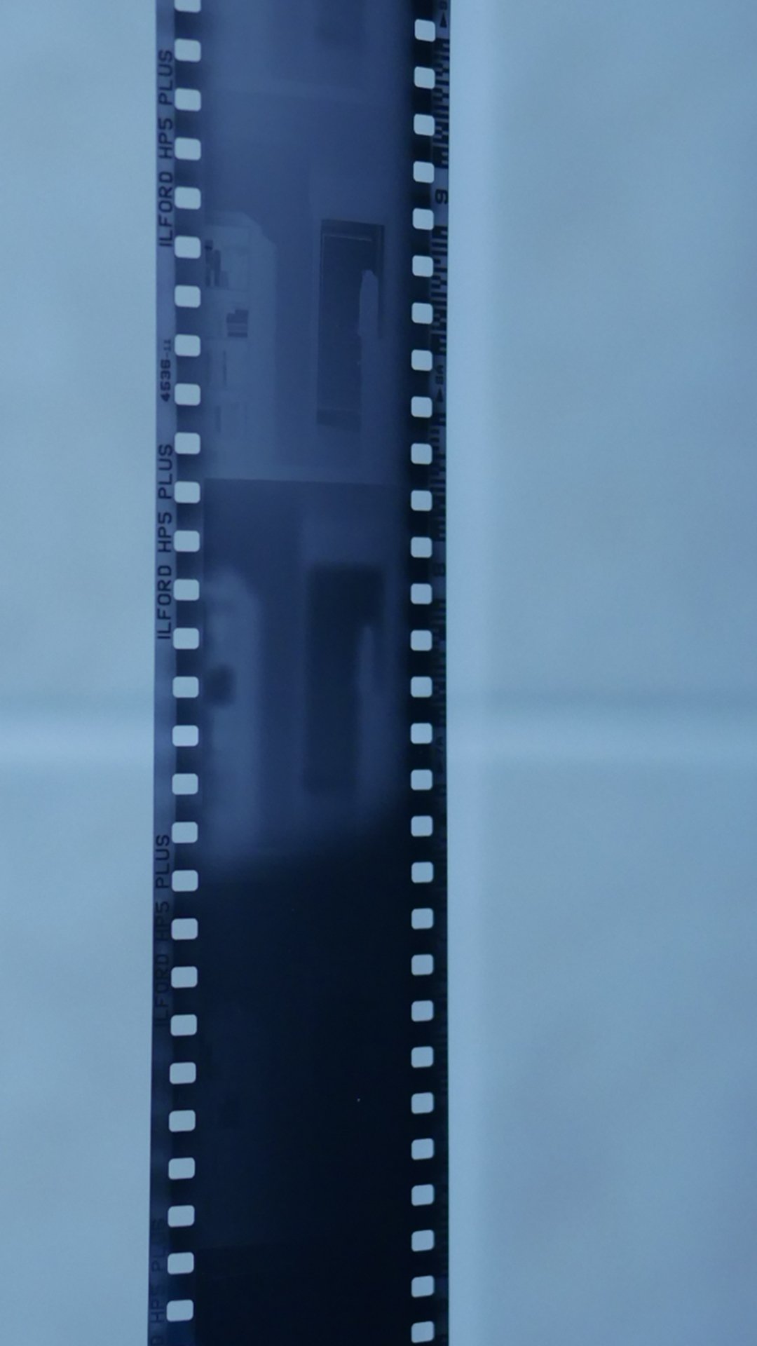

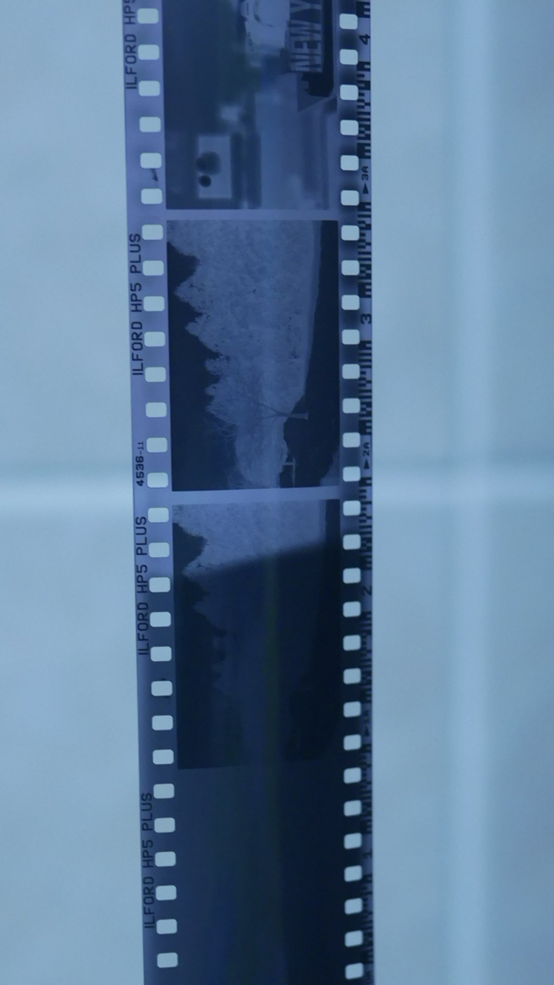

Hello all. Another noob mistake all of you could help me diagnose. This has happened to me twice already, so clearly it is a trend and not just a fluke. When I develop a roll of film the first frame looks half properly developed and half very dark, like the short length of film after the leader, as if I had accidentally exposed it (picture below). However I load the camera just as the Nikon manual suggests:

This has happened to my third (pictured) and second (first frame was very overexposed so hard to take a picture of) rolls. My first roll has been cut up and put into a 3-ring binder negative sleeve so I don't know what the beginning of the roll looks like, but suspiciously my negatives start at frame # 4.
Also I noticed another such uneven (development?) line in roll # 2 shown in the second picture. This roll has TWO such lines. What is going on here?
Finally I see my rolls are starting at frame # 2 and end in frame # 25 (have only been using 135-24 film so far). Is this normal? Seems I could have a whole 'nother frame if only I load it properly! Better yet I see another two frames worth of film in front of frame # 1...yet another 2?! These could in theory be exposed as the two dots in the beginning of the film counter S . . 1.

I'm wondering if the problem might be happening at the other end of the process - after you have rewound the film or while you are loading it into the reels for development.
The facts that these are both at an angle (not straight across the film) and not dense enough to fully obliterate image information (at least in the first example above) suggest this is something other than light fogging at loading (caused, for instance, by not advancing enough frames after closing the camera), but rather something happening in development. Check your tank lid and core for cracks, mismatched parts, and other things that could cause a light leak at the core (which is where the head end of the film would normally land).

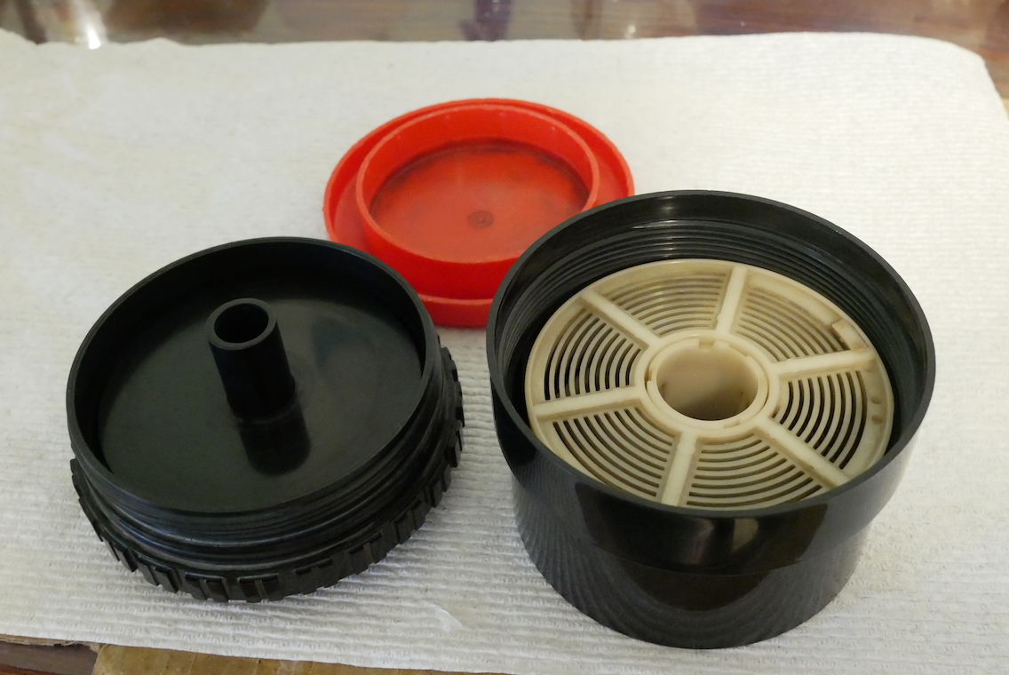

@Donald Qualls Are you referring to the part on the left? The suspect part would be the central cylinder? Running my fingers around it and the surrounding areas I do not feel any cracks. Placing a powerful flashlight top (underside in the picture) and plugging the bottom of the hole (topside in the picture) to prevent any light coming from there doesn't produce any visible light leaks. I am thinking of just buying another and see what happens. Adorama has a sale on this tank:

My 2 reel version of that sort of tank has a separate centre column that comes out. Perhaps yours should have something similar.
Nope. The joys of eBay. :blink: You never quite know what you're going to get.

Just want to point out that it doesn't look like uneven development, rather exposure to light either in the camera (doubtful if you're following the instructions as you say) or in the darkroom. How do you load the film on the reel? There could be an issue with light coming through the filler hole in the tank, too. The fact that the sprocket area has been exposed to light as shown in you second example isn't a good sign either. Is that happening throughout the roll?
That is what I suspect right now. The lack of the central pillar part and agitator in what I got is the likely culprit.
If Exposed To Light = sprocket area is darker, the second picture is the only example on either roll.
Yep, I'm late the party, but I think you're missing the column. That would cause the fogging on the inner wrap of film in the tank, while the material of the reel itself limits the density and creates the angled shadow. It would also account for the sprocket strip fogging, so fix the tank problem before worrying about your camera.
Both photos show the sprocket are exposed.The film in that strip top & bottom should be clear with frame numbers, film type etc.

Your first tank looks similar to the AP tanks that Freestyle sell as the Arista Premium, and as everyone else pointed out it's missing the central core. Freestyle sells replacements for their tanks, and it is possible that the replacement for the single reel tank would work: https://www.freestylephoto.biz/05042-Arista-Replacement-Core-for-5042-Premium-Single-Reel-Tank
It only costs a dollar, so add one to your next order.
