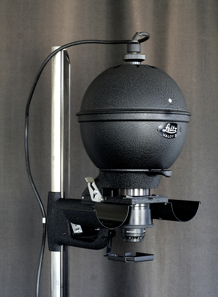

Does anyone know if a screw filter holder from say the Omega B-22 or other brand will attach and work on the Leitz Valoy. I'm thinking a L bracket type holder would work.

The Omega B-22 filter holder does not work. The B-22 assemble is straight. The Valoy needs a L shaped braket.
Is anyone using an under the lens filter holder and could you explain how you fabricated a bracket or found another enlarger part which works with the Valoy?

I removed the Leitz red filter shipped with the enlarger and fabricated an ""L" bracket out of light aluminum stock. I attached the bracket to a Kodak Polycontrast filter holder. By using a cap screw, nylon lock nut and plastic washer I can adjust the friction so the filter holder is easily swung out of the way when not needed. Let me know if a picture would be of any help.

I tried the a contraption that screws on the lens. It works, kinda but prevents one from seeing apertures. Basically to unelegant to even what to use. Would rather hold the filter in place with my hand.

Just in case you're still wondering
Better late than never, I hope
Beseler filterholder, sacrifying the redfilter and modifying the part that allows the redfilter to go up and down - very easy !
