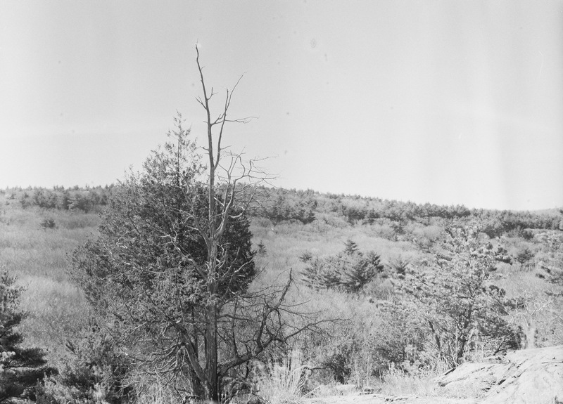

I have used the same lab several times over the last six months (6-7 rolls) and my negatives continue to come back streaked and washed out as the example shows. Both color and black and white.

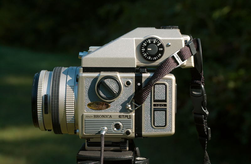

I am using a Bronica ETRSI(40th anniversary edition), AEIII Prism, with 75mm PE, tripod, MLU, and release cable. Some of the negs are great, but a large portion of them have these noticeable streaks.
This image is just a typical example and not very good, but I would appreciate any input.

Looks like light is fogging the fill from the topside of the negative. I am not familiar with the Bronica ETRSI, Does it have a removable back?, or a dark slide of any sort? I had similar problems with my Hasselblad when the light seals around the dark slide were bad.

If this is a light leak there should be some noticable fogging at the edges of the film outside the picture area.
It looks to me a little more like processing, but the processing for color and B&W would be entirely different, unless you're using a chromogenic B&W such as Ilford XP2.
What B&W films are you using, and what do the edges look like in the color and B&W? Does the streaking continue past the picture area?

This particular image was shot with Ilford pan f plus

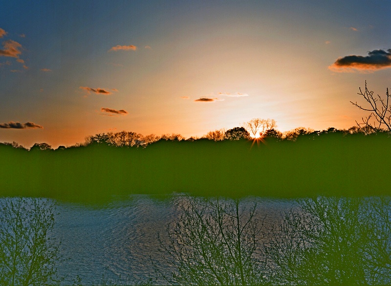

here is another image that I shot with Ektar 100, i purposely altered it to highlight the streaks.

It does have the appearance of uneven development, but, also check that your films are wound tightly onto the reel once exposed as slight slackening can cause light leaks. (As said, this would be apparent on the edges also).

its not light leak it is chemical and you should inform the lab immediately! this kind of processing problem is not acceptable.

This looks more like a development issue than one with your camera. I'd talk to them about it. It's important to have a good relationship with a lab, a good working back and forth dialog with them. If they get defensive right off the bat, then I'd see about finding a new lab that might be more responsive to your concerns. Tall order, these days, I realize, but worth the effort.

Looks to me like a development issue as well. I did see similar patterns when I developed film in a drum; a Presoak in tempered water fixed the issue.

I agree that it looks like a processing error, possibly bromide drag which can be caused by improper agitation. It might also be caused by problems with the rollers in a processing machine. Notice how the increased density favors the areas above higher density parts of the negative. Light leaks usually cause denser fogging and the density due to a light leak is concentrated near the edge of the film, although it may extend across a wide band with lesser intensity.

I have nothing of value to add to this thread but would just like to say that I wish my ordinary ETRS looked as good as the one the O.P. posted a picture of!

If you look directly at your negatives are there spots on them that look metallic? If so your lab needs to clean the rollers in their machine, more than likely that is the problem, the rollers stay clean where the 35mm rides over them, but medium format uses the normally unused part of the roller resulting in what you see on your images.
If you like the lab and it is in a good location for you please let them know about this problem, you will be helping yourself by having a good lab close to home, and you will be helping others because a machine that is well maintained will provide years of service not just for you but for others as well.
I just had a similar problem to this with my local lab that does my 120 C-41, the lab owner thanked me, gave me free processing, and told me that next time I am shooting C-41 I just have to call her a day in advance so she can clean the rollers before I come in or I will have to wait an extra day for my film. This is why you need to support your local lab.
