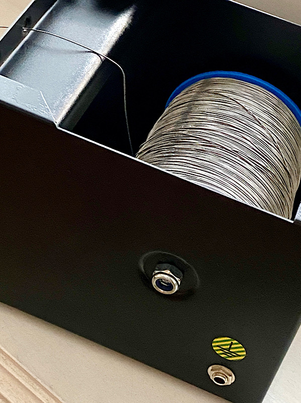

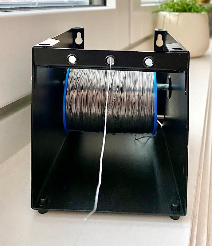

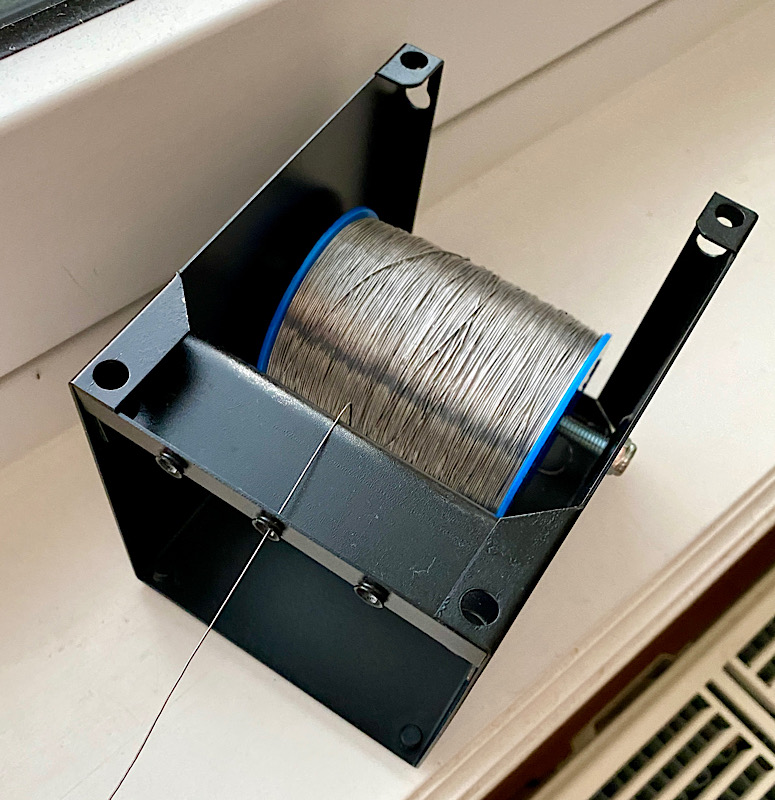

It is not always easy to use solder wire on rolls.
Sometimes the piece of wire is too short, especially when you just have to hold it to the soldering point. Other times the wire spools off the roll in loops because you have pulled too hard or it has fallen off the table.
This solder roll holder brings order to soldering and can also be integrated into an ESD environment with its grounding connection.
The solder wire roll sits securely on a steel axle and the wire can be pulled off in small doses without running off the roll.
Solid design in sheet steel.

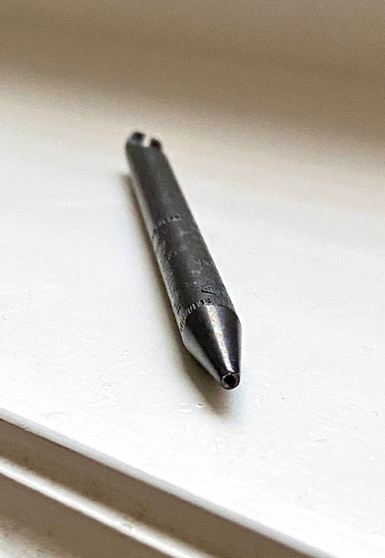

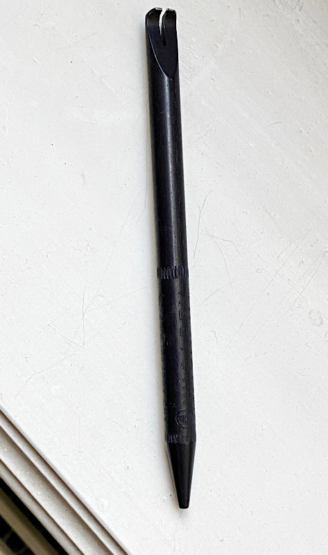

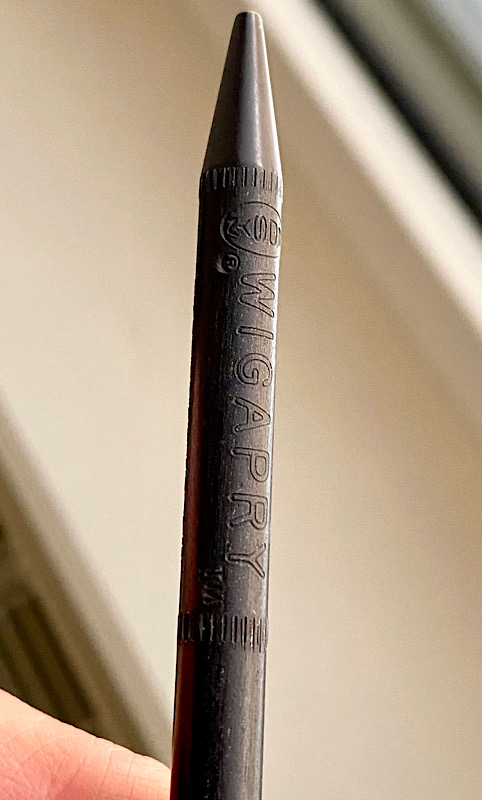

When it comes to desoldering
it is not always possible to remove all the solder from the soldering point using the desoldering suction pump or the desoldering braid.
This small metal tool helps to remove connections from circuit boards that are still held in place by a thin layer of solder residue.
It can pry and pick up connections in its tip. Shake it gently and the connection is free.
The manufacturer of both tools should be Edsyn.
