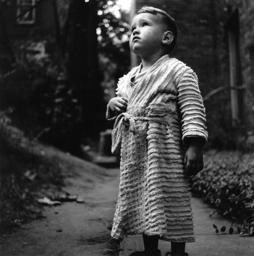

I don't have the experience of museum archival cleaning like chimneyfinder did. However, I printed some negatives from the 40s and up for couple clients. The negatives were not that bad, but I rewash them in water and photo-flo on their requests. Homemade negative carriers will be very handy, alright, where are all my notes, hold on I'm trying to find them haha. Alright they are MIA so I am just going to go with my memory. Anyways I used my 75mm lens the most on the old Omega B22, Some of them I also use an old 5x7 contact printer with a additional dimmer switch, the contact printer is for those really odd size negative while personally I didn't want to crop them. I was using Kodak Dektol with various papers (Mitsubishi and Ilford MG for 5x7 and Some kodak whatever Matte for 8x10). I found out some of the most exciting images were printed, without any filters. But some requires lots of trial and error with all my pack of MG filters to make them look good ( as far as i remember #3 looks ok on most of them) . That's all the info i can give you for now, good luck!
Attached is one of those photos I printed, I love that one so much.
