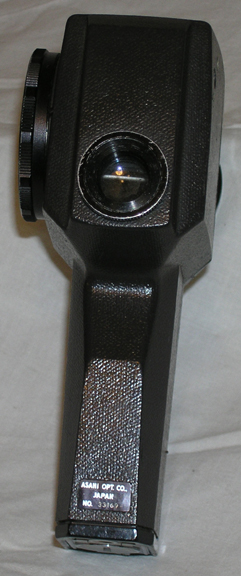

Anyone any ideas on this beast ? Going on the auction site at a place that knows little about it. Serial number apears to be '33169' and it's described as a "vintage asahi pentax spotmeter" Apparently Hi and Lo meters respond to light. Does it predate the Honywell partnership or is it likely to be later ?
Cheers ; Chris
