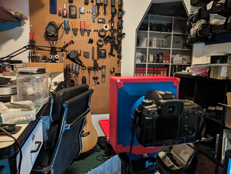

Of course, I'm not 100% convinced I'm making the right choice, so I 3D printed myself an open source field camera, and bought the bellows, ground glass, and a pinhole "lens" from Standard Cameras to build something to play with until next year.

So far I've designed a mount to put my E-30 onto the back of my 3D printed field camera and shot a couple pictures through the pinhole with it (ie: the worst possible use of a 17x13mm sensor)... but at least it's let me figure out that I still want to paint the inside of the camera with Black 2.0 because in addition to the unusable blurriness, I've also got whatever fogging is called on digital cameras because the plastic I printed it all with isn't quite opaque.

For the morbidly curious, here's the setup and resulting picture:
And here's the setup:

The field camera looks fascinating; I'm curious how well it actually works for LF! A few coats of paint should fix most of the opacity problem.
As I printed it, it's frankly pretty terrible. Part of the problem may be that it was designed for PLA, and I printed it in ABS, because all of the dovetails are loose and rattly.
Other problems are that the tension knobs are too small to get a really good grip, so things like the front swing never really lock convincingly. Finally, the hardware that's specified isn't really ideal for that it's being used for... self-tapping flathead screws were specified for almost everything, but most screw holes don't have a countersink, so the screws are proud... and for the lensboard clip, I need to actually remove the screws to replace the lensboard.
Overall it's interesting, and can be made to work, but I've already started designing a replacement. The back design works pretty well though, and the way it slides to the infinity stops is very satisfying (though the stops need to be part of the printed model... no way to adjust or add more later).
