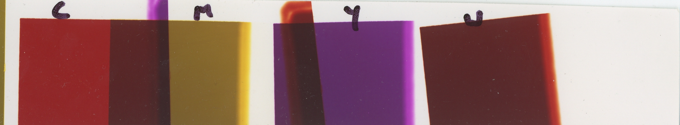

Hey friends,
I could really use some help troubleshooting some problems with my RA-4 printing. Bought the Ektacolor RA developer/replenisher RT & Ektacolor bleach/fix from Adorama, those came yesterday and I mixed them up today, making especially sure to not cross contaminate funnels and beakers with the wrong chemicals. I've been doing it in trays at 20C, 2 minutes for developer, a quick stop bath rinse, and 2 minutes in the blix (as suggested in previous threads). The problem is, when exposing at the standard C-0 M-50 Y-60, my prints appear red. Here's a raw scan of that first print:
I also ran a test strip at maxed cyan, magenta, yellow, and unfiltered white enlarger light to get a better understanding of what's going on color-wise, these are the results:
At this point, I'm like 90% sure its a chemistry problem (I couldn't help but notice that part A of the blix had a whole lot of precipitated sulfur, and that the entire a-c developer had expired as of February 2018), but I'd love to hear any input from people with more experience. Could it be a paper issue instead? Or is it possibly a technique issue too?

Hard to say if the developer is bad but the blix surely has a problem. But I think the red is due to filtration. Starting filtrations in the neighborhood of 50M, 60Y are often suggested, but that is what they are, starting points. You almost never get perfect color the first print with these suggestions and have get to the correct filtration setting by trial and error. In your case you need to add more magenta and yellow in the enlarger to counter the red in the print. Try 10-15 more units of each, observe the change, and go from there. Eventually you will likely have to tweak each one individually. Do not add any cyan.

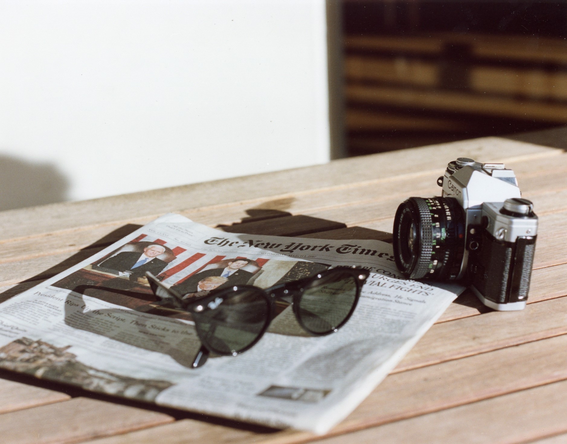

That certainly looks a bit on the red side, maybe a touch of yellow as well.
However work on the basis it is a red cast, do a ring around taking out red in steps of say, 5 units at a time.
Currently you have 50M and 60Y so adding 5 units at a time you would start with a ¼ part of an 8x10” sheet exposed with 55M 65Y, then the next ¼ part of your sheet with 60M 70Y and the following ¼ parts of your sheet of paper with 65M 75Y and lastly 70M 80Y.
If possible, expose the same part of the negative for each colour filter change. I would use the part of the newspaper with the man in the suit.
I would use your second density exposure time and keep it at that time for all exposures, meaning, as you add more filtration the print will start to get slightly lighter. Please note that as your print gets less exposure, this will also make the colour less red. By only changing the colour filtration and nothing else, you will have only one known variable. By changing the exposure each time as well, you have two variables; don’t do this at this early stage of your colour printing career.
I’m guessing that around 70M 80Y will be reasonably closer in correct colour, although I could be wrong. I’m thinking that your fourth colour filtration change will be closer to being correct. At this stage, if the colour has constantly been getting better as the filtration changes, then you could have a good idea if your colour cast is a predominantly red cast. By doing the four changes on one sheet, you should be able to see a clear and progressive change quite easily.
When you are really on the money with C41 colour printing, then differences of say 1 unit of magenta can be seen. Plus, as I said before, adding density (making a print darker by using a longer exposure time) will make a print more red, conversely, using less density will make a print more cyan.

Looks like a filtration problem and not a blix problem. Can you get a white border? If so, then development and blix are both ok.

There ain't no such thing as a "Standard" filtration.
You always adjust the filters until the cast is cancelled out.
Don't look at the numbers. Look at the print. You have a red cast. You need to add M+Y filtration until you see a cyan cast.
THEN you know you have too much filtration and dial back towards neutral.
Wether the dials read "050"&"060" or "001"&"999" doesn't matter, the procedure is always the same.
When cancelling out a cast, depending on the strength of the cast you can proceed in steps of 5, 10 or 20.
If you can get a good solid black with a completely fogged strip of paper your developer shoud be good.
White borders will tell you if your blix works (at all) and if there is any (severe) fogging.
Don't use expired RA4 paper if you're beginner, it is a waste of time, energy and money. because it is unpredictable and will drive you nuts.

I would replace the blix. Precipitated sulfur in the fixer part may mean the fixer is not doing its job and if so, you won't see the effect now, but prints may darken or take on a color cast down the stretch.

Thanks for all the replies! After doing some more research online, I found out that I misunderstood how the paper responds to the different color filters. Oh well, lesson learned. Since my borders were coming out white, as Photo Engineer talked about, I ruled out any issues with chemistry. So, after 4 hours in my darkroom and lots of fine tuning of the filters and I finally got a good print:
Seriously, thank you all so much!! I would've been completely lost without your help.

Looks great, what filter settings did you wind up with?
