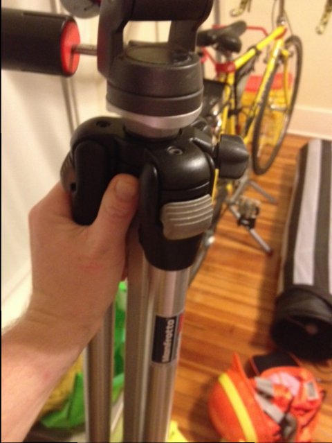

This makes sense. I actually have a pretty stout manfrotto (See crude iphone photo attached).
But I'm not sure what head I would need, or even how to take this head off...or if it even comes off.

Is that plastic parts I see there?
No, steel. Just painted.
Edit: or anodized. I'm not real sure how to tell the difference.

FWIW. The head just unscrews. There are three screws under the tripod's mounting plate. They have to be loosened
for the head to unscrew.
Does the head you have have a model # on it? Some of the Bogus, I mean Bogen are substantial enough.

Raise the center column and look at the bottom of the column plate. If there are screws along the outside perimeter, usually 3, loosen them 2 or 3 turns. Hold the column and turn the head counter clockwise and unscrew. They can be very tight if factory mounted and may require a strap wrench to loosen. The GV II clamp can be mounted directly to the column as the head was.
