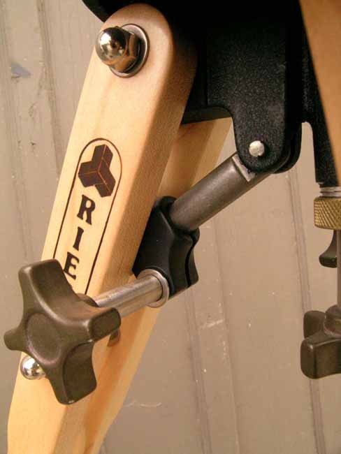

So because I had to work all weekend I decided to take Friday off. Had the itch to take both the 8x20 and 11x14 out for the day. Went up Highway 1 in California and wanted to do some work back in the canyons. I set my 11x14 atop my Walnut tripod and had everything secure. I was about to put the waterhouse stop in my lens and as I was about to do so I stepped on this huge rock that one of the legs of my tripod was against and it twisted!!!!! My camera started to fall to the rocks!! I managed to grab it and hold on for dear life. Fortunately for me two nice guys who were watching me jumped in to help. We got the camera to a safe spot and I realized that the torque on the base caused the Walnut base to snap. I need to re do the base. My question is when I do this I'm considering that I want to make the Tri-lock device that is on the Ries tripods. I've looked at the website and the pictures tell me a fair amount but can someone who owns a Ries let me know how this tri-lock system for securing the legs into position works. Does it expand the leg from the top? I can't see how it works. Please don't say just buy a Ries tripod as right now I don't have the $$$. My Walnut tripod is strong but I need to do an upgrade to make it better. Thanks.
TracyStorer
Oct 12, 2004
111
SF Bay Area
ULarge Format
more tri-lock detail
Jim, here's the image I PM'ed you about....smaller, but should still be clear.

I wanted to thank everyone that gave me input on the tripod repair/upgrade. I did the "Ries thing". I made a tri lock system for my hand built tripod. It is more stable and solid than before. It is nice in that I can lock the legs in position and if I need to move the system a short distance ( very short) I can leave the legs in place and they don't move. All in all a very nice system.
