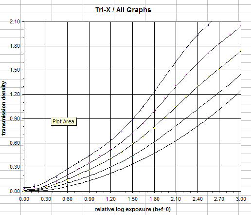

When shooting Tri-X, I generally rate the film at 1/2 the published speed, and reduce development appropriately. To increase or decrease contrast, I use times I've figured out over the past few years. I get pretty good results, but I'd like to be a bit more consistent with my results. Since I own Way Beyond Monochrome, I thought I would use Ralph's method for figuring out all this information. Based on my reading of the BTZS, Ralph's method seems to be very similar to the BTZS method for determining film speeds and development times.
So, I went though the testing process - I exposed 5 sheets of Tri-X using my enlarger, made the graphs, used the graphing overlays and ended up with these results:
Dev Time Log Exp Avg Grd
3.5 1.01 0.56
5 0.82 0.58
7 0.64 0.65
10 0.53 0.73
14 0.40 0.80
Note that I was very careful to ensure that the generated graphs were to the correct scale so as to match the overlays supplied with the book.
Development was done using hangers and tanks, HC110 diluted at 1:11 at 20C, 10 seconds agitation each minute.
When I try and graph the above information, I don't have enough information to make any sort of determination for contraction times. My thoughts are that the upswept curve of Tri-X is skewing the results, giving me a higher average gradient that I should really be getting.
I've attached a graph of my results of the 5 tests. I would welcome any comments on the data collected.

What do you mean you dont have times for contraction? Contraction would be your normal time minus one stop, two stops, etc. You results show the different times are having a clear effect on contrast. What is your normal time?

Hi Ken
You're dead right.
Both TXP and HC-110 are designed to give upswept curves.
A higher dilution of HC-110, and reduced agitation, is needed to get a useful N- curve. Or, use Xtol. You'll still get an upswept curve with XTOL: comparing midtone straightlines, Xtol will give a higher shadow density and lower highlight densities than HC-110.
But there isn't any way to make a negative from TXP that will give the full shadows and compressed highlights we usually want from an N- negative.

While the individual graphs do look different, if you take into account the speed points and the point at which the exposed density reached 1.37, the slope of the line (or the average gradient) is very similar for the first two graphs (0.56 and 0.58). There is therefore not enough information here to extend the graph (of dev time vs. avg. gradient) to accurately make a determination of the required development for reduced contrast.
An average gradient of 0.56 works out to something like -0.5 N (I have neither the book or my graphs in front of me). There just isn't enough information to extrapolate to determine other development times.
So, as I mentioned above, I think the avg. gradients for the first few curves are similar because Tri-X has an upswept curve. In other words, I'm not sure how applicable this method of determining the average gradient is for a film which has an upswept curve.
BTW, my normal dev. time for Tri-X is about 6.5 minutes. I use 4.5 minutes for -1 development, and rarely go further than that.

There is always an advantage, and a problem, when we devise a system to describe film's performance.... that's why there have been so many methods in the past !
You can have a TXP neg of a given gradient, but all the curve falls below the slope !
Or, with HP5, or TMY, the average gradient overlays the straight line of the film.
Handy though, having the choices. TXP makes me a much better portraitist than I know how to be !

That's one of the strengths and weakens of average gradient. Gamma just measured the straight line portion neglecting the shadows and highlights. The key to average gradient is to measure only the part of the curve that will be utilized in printing (paper's Log exposure range). Kodak's Contrast Index is designed to comes closest to producing similar negatives with a variety of different curve types. If you want, I can go into specifics about the aim values.
The question about your contracted development is that you just don't have a processing time short enough. You can also reduce the dev temp and/or dilute the developer if it appears the dev times will be too short to be practical.
