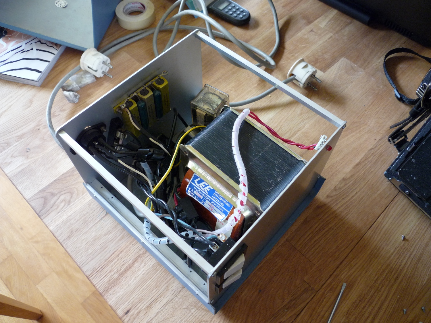

The transformer for my IFF Ampliator enlarger has two switches on it. The first one is obviously the power switch, but the second one doesn't make anything obvious happen. It can be on or off and everything behaves the same.
The switch is wired up to something inside, but I don't know much about electronics to make any sense out of it.
Does anyone have an idea?

Can't tell from that picture. Is that a relay to the left of the transformer? I hope your not powering your enlarger on with the case open- that transformer would probably blow you out of your chair.
There is a relay to the left of the transformer. The transformer is connected directly to a wall socket, and it has another plug that goes to the timer. I think the relay is used to switch the lamps on and off. It has some large components at the back which looks like resistors.
I suppose it doesn't matter what the switch is for when it doesn't do anything!

Base on the picture this is what I think:
The transformer converts 220v to 48v at 700watts maximum for the bulb
The resistors drop that lower for some other thing on the enlarger. Like an indicator light or the fan.
Are there wires to the lower switch? Where do the wires come from? Maybe it is to turn on or off the alternate supply , like to turn off any indicator lights.
Those resistors are more likely part of a snubber circuit.
Note the capacitors associated with them.
Possibly, that circuit is there to protect the lamp or the relay contacts.
This sounds plausible. The power supply makes a clicking sound when the lamps turn on and off, and I suppose that comes from the relay. The filter scale lamps didn't work when I got the enlarger, and in the end I connected a small external power supply to the head just for the filter scale lamps. Perhaps the the second switch is there just to turn on and off the these lamps as ic-racer suggests. I will open it up again and check where all the wires go.
