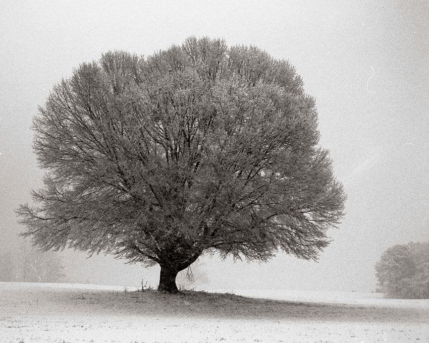

Here is a shot I took yesterday during the height of our blizzard!!! LOL!
We did get about 6" and it was beautiful but is almost gone.
I was thinking this shot might look good toned somehow? maybe Selenium + Sepia???
All I have currently is Ilford MGIV RC paper. Will RC paper accept toning?
RB67 w/90mm "C", Tri-x 320 XTOL 1:1

yes, but this paper is difficult to tonem especially with selenium, you might try sepia.

RC tones about as well as FB. I wonder if a gold toner for a colder color would do well.

Yes, Ilford MGIV-RC will accept toning, less so than Ilford MGIV-FB, but it will. I'm a big fan of selenium+sulfide toning, but in this case, I'd try sulfide alone first.

Maybe I am seeing the "greenish" cast that you are talking about in my prints??? They seem so close to what my mind's eye see's but they still have just a bit of dullness. The straight negative scan has the "pop" I am looking for but the print doesn't quite have it. I n Tim Rudman's book "The Photographer's Master Printing Course" on page 28-29 he has a photo of a misty lake print high key. It is a low contrast shot bit it has the same tonal range as the scan I posted at the beginning of this thread. My actual print has more of "something" in it that I do not want. It may be a green cast but green is a difficult color for me to see. Faint green is difficult fo me to see.
My negative is really nice, sharp and good range. Nothing blown out or blocked up so it seems I should be able to get a crisper, colder look from this shot???
Am I trying to get a result that this paper in a straight print is not able to produce?
