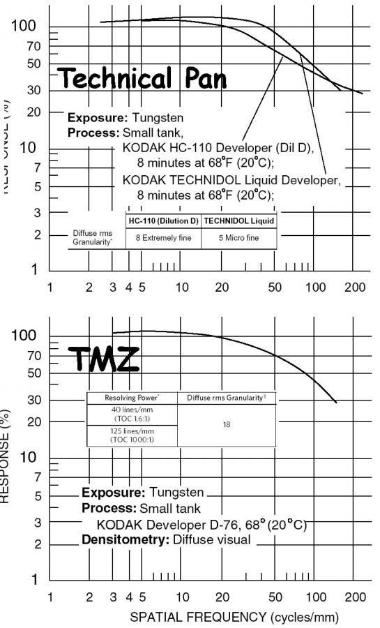

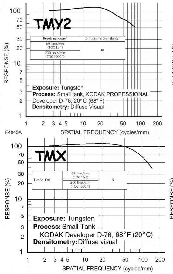

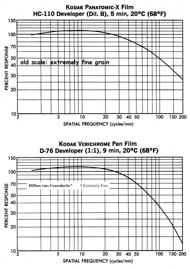

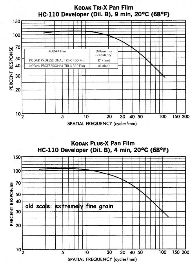

However much fun it is to mourn the old films we have lost,
the the films which replaced them are better. Here are a selection of Kodak MTF and Grain/Granularity charts for your entertainment.
If you aren't comfortable reading an MTF chart, you might look at where the curve crosses the 50% Response line (vertical axis) to see the practical limit of that film's Spatial Frequency. This is a handy snapshot of what the film can give you.
For instance, Tri-X gives you 60 cycles at 50% contrast. It has a Granularity of 17 (fine). TMZ gives you 80 cycles at 50% contrast. The Granularity is 18.
There are two questions one might ask. The common one is, " Kodak doesn't know what it is talking about"; the second is, "Hmm, I wonder what I can do to improve my pictures ?".
Take squint at TMY2 & Verichrome Pan; and if you feel strong, compare TMX to Tech Pan and Panatomic. For that matter, take a long, hard look at TMY2 and Panatomic X.

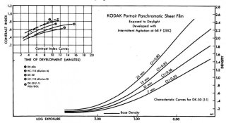

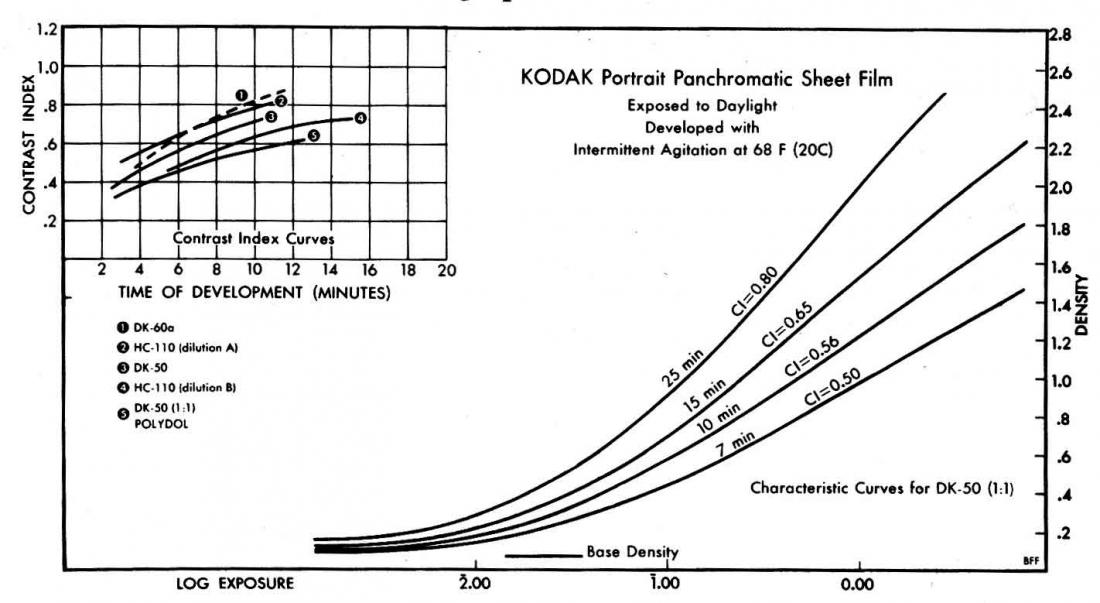

The chart is no more than a mathematical description of what the film is doing. Here is Kodak's glorious Portrait Pan, Paul Strand's favorite film, long and gone these many years. You can reproduce it exactly with TXP. When we run out of TXP, you can do it with TMY2.
TMY2 in Edwal 10 or 12, or HC-110 or DK-50 ? Exact match.
Really, we can !

Spectral sensitivity, however, has nothing to do with exposure or development, and that's the main thing I don't like about T-Max films--they look too much like B&W video. It might be possible to tweak that by filtering it differently on the camera than other B&W films, but I used TMX and TMY for around 10 years as my main films when I mainly shot 35mm and ultimately realized that by shooting larger formats, I could think less about grain and more about tone, and since then, I haven't shot much T-Max.
