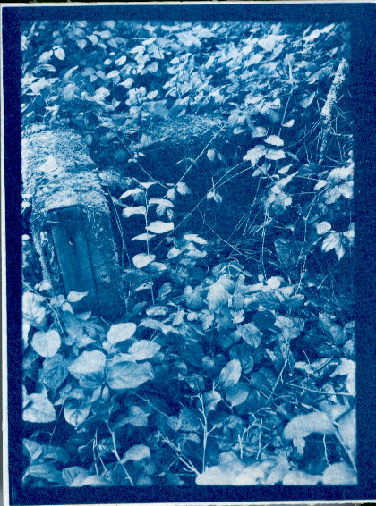

Jay, I recall it as being both TMX and TMY, but it's information I read either here, on photo.net, or on the Large Format Forum, not something I know from firsthand experience. The only alt-process prints I've made are cyanotype from Fomapan 100 in 9x12 cm, which works very nicely if I get the right combination of negative contrast and contrast enhancer (or lack thereof) in sensitizing the paper. I need to make some more of those; I've got a couple images that print well enough and look good enough they might be saleable...
