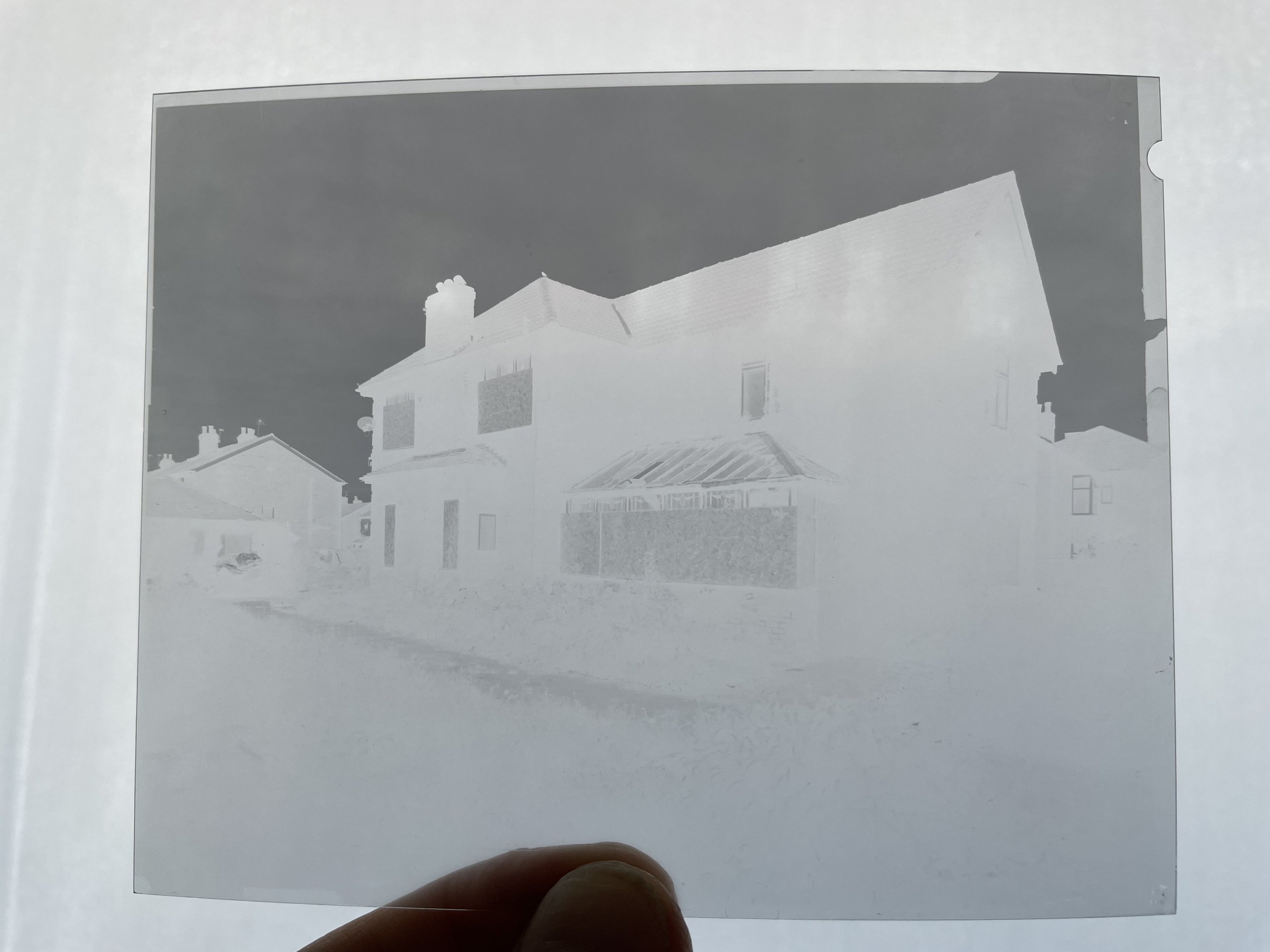

So first time shooting 4x5 and I chose Fomapan 400 to learn as it's the most 'economical'. I have shot 8 exposures and developed with monobath CineStill DF96. I have used this monobath on 120mm Fomapan 100 successfully in the past. However all of these sheets are coming out thin, massively underexposed. Have I underexposed all 8 frames!
So on your expert opinion, where's the problem here? This was shot at ISO400 f22 1/30 I'm doing something really wrong but not sure at which part. the DF96 was 27degrees with 4mins (as i have developed 4 rolls before) constant agitation on a SPP-445 tank.
Thanks in advance!

Do you shoot at box speed? Most shoot Foma 400 at 200, never used DF96 so don't know if you need to increase the time. I shoot Foma 200 at box speed and develop in a number of developers including D76 ID11 with good results.

Yes all were shot at box speed but since then I have been reading a bit about it and yes most people seem to recommend to shoot iso200. I 'm gonna run a test now in my garden shooting at 200 and see. As for DF96, you need to increase 15seconds per developed roll and i had developed 4 rolls hence the 4 minutes developing time. I have in mind to order some D76 this week though.

They look like they're possibly over developed, but it's impossible to know from just an online jpg. In 35mm form, my Foma 400 likes to be shot at 200-250. Just a thought, but have you checked the shutter speeds? 4x5 cameras usually have old shutters and lenses that are usually running at least a stop slow, although I've seen 'em run fast at slower speeds too.
This film really looks great in D76 full strength, and it would be prudent to buy it in the old tins and paper packages off fleabay or somewhere. By all means try the Foma 100. Wonderful film. The Freestyle Arista EDU films are rebranded Foma I think, and they're a little cheaper to buy.

Based on my latest adventures I'm pretty sure you have underexposed heavily. That is not even 1 stop, but maybe 2-3 stops. Development density looks OK based on the sky. How did you measure the scene? Your sky looks to be in midtones so that also suggest underexposure.
I personally would not use monobath developers.
I've shot Foma 400 at ISO 640 and got really usable frames.

Another vote for ASA/ISO/EI 200 & D-76. Monobaths are touchy and iffy things - they work great under some circumstances but deviate a tiny bit and they stop working. Chinese "Kodak" D-76 seems to be going through fits of problems, try Ilford ID-11 instead.
As Vedostuu mentioned, the negative looks very underexposed. Try test shots at Sunny-11 - or make sure your meter reads 1/200 at f11 for a sunlit subject (it never brightens up to Sunny-16 in Cleveland, Ohio, probably the same in the Midlands).

Tricky. Maybe you can get it to work, but Foma400 needs quite vigorous development in my experience and with a monobath, you run the risk of having fixed out anything that could be developed before the developer can get at it properly.
Plus what the others said about exposure. It's not a true 400 speed film and in most developers, not even close to it.

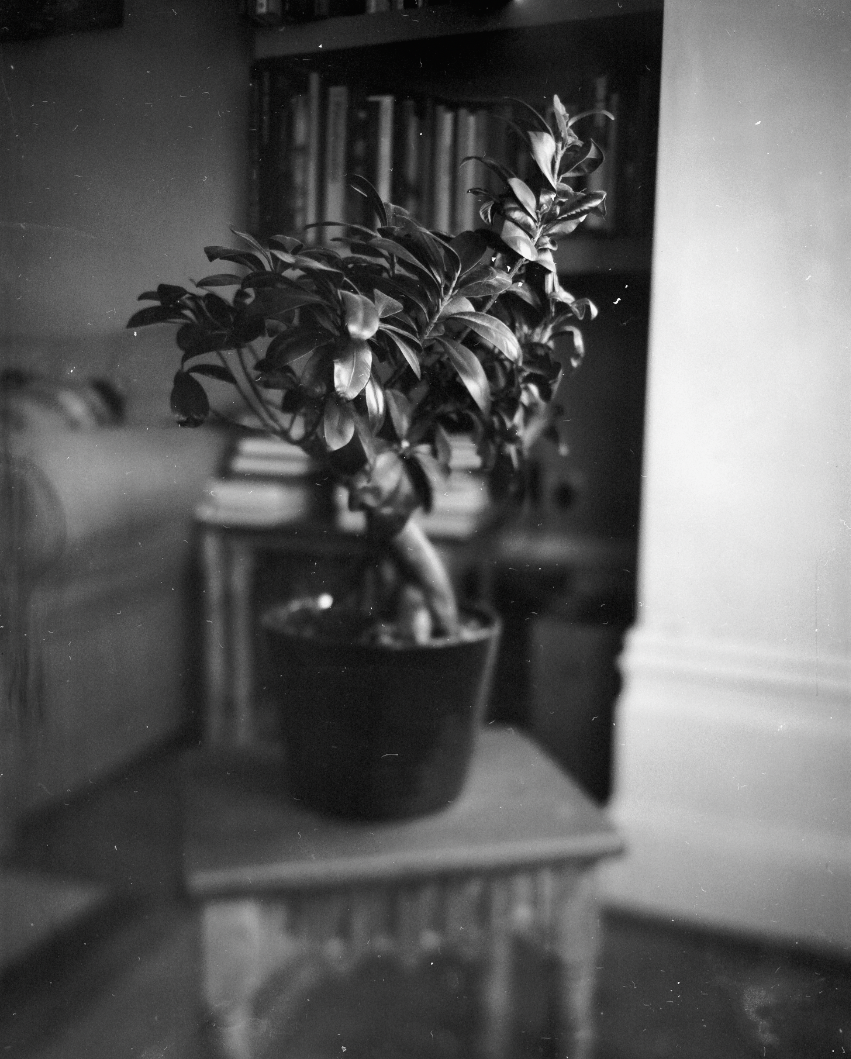

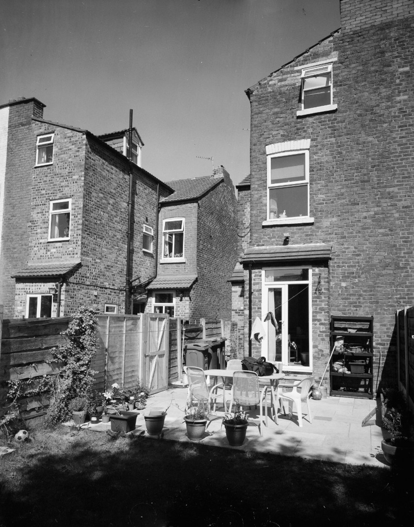

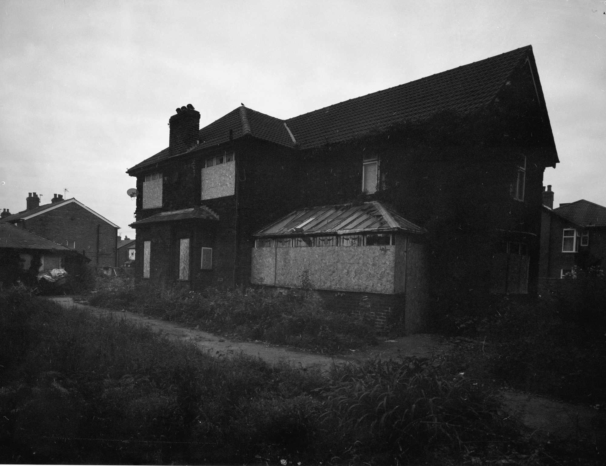

Guille Ibanez
May 20, 2021
7
Manchester
thanks everyone for your contributions!!!
shooting as if it was iso200 helped A LOT plus i added another half stop. Maybe i should also get the shutter checked
these re better than before
I'll also get some d76 this week even though after adjusting exposure, the monobath didnt turn out too bad
thanks!
