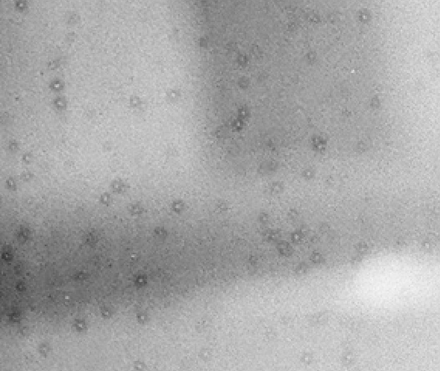

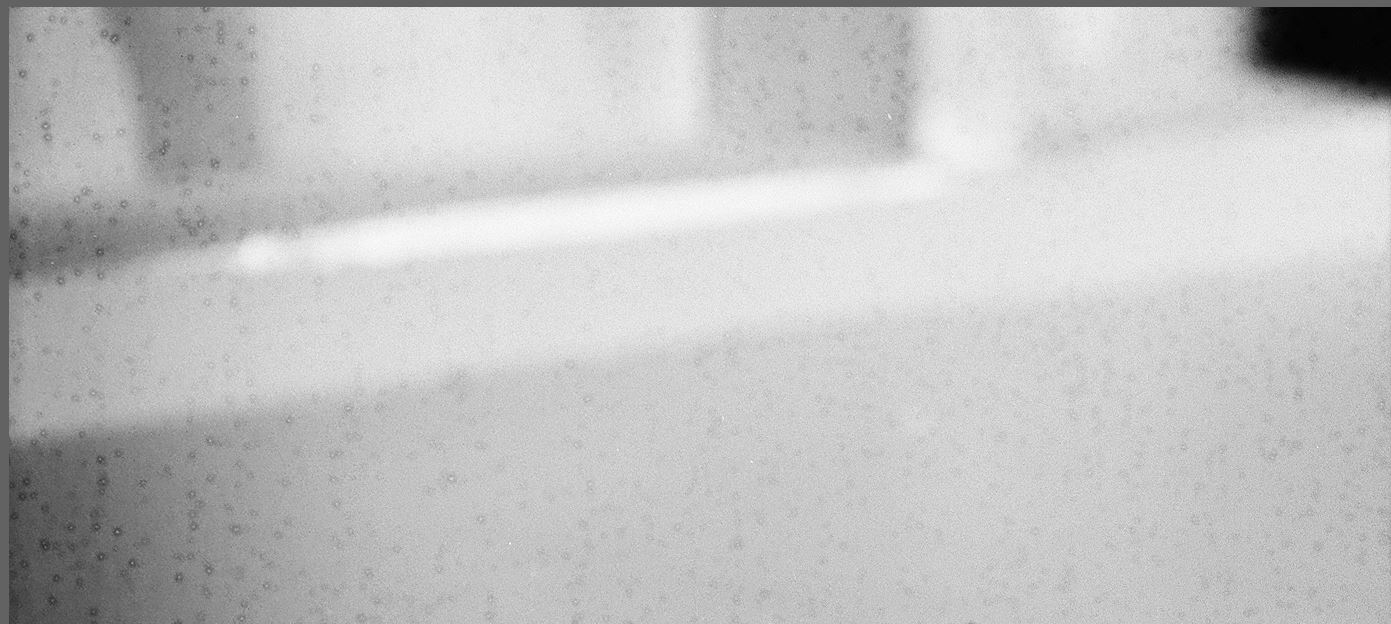

I have seen air bells before, but not like these. On films that I have seen air bells before, there were only a few at the most. But these tiny spots literally are everywhere on the entire frame and on every frame! Attached are a close-up and an even closer up screen shots of the same frame.
Information (I have never had any problem before with this setup and process):
Ilford Orth +
120 Format
Processed in a Jobo CPE-3 at 23° C
Prewash in plain water (5 min)
Sprint Standard B&W Developer (11.5 min)
Kodak Stop Bath (1 min)
Kodak Rapid Fixer (no hardener) (12 min)
First Rinse in plain water (5 min, no exchange of water)
Perma Wash (5 min)
Final Rinse in plain water (4 cycles/exchange of water of 2 min each)
More info: In the same batch is another 120 Ortho and a 135 TMY. No spot on the 135 TMY but they are on both rolls of 120 Ortho.

It doesn't look like air bells to me, contamination of some sort? The center of the spots appear to be cubic in shape not round like air bells.
How old was the 120? Was it in the sealed package? I've seen stuff like this on some old 120 film that I had that was out of the sealed foil packages and I had no idea how long they were out. Almost looked like moisture/mold damage.
No idea how old it is. The films actually belong to a fellow member of my local photo club and he in turn found these 2 rolls (sealed in original packaging) in the new house he had just bought. So he just shot some pictures of his new house with them. When he handed them to me, the paper wrapper didn't look old, but who knows how old the film actually is. I too suspect that the film may be quite old. I think that because the edge markings are very, very faint (almost unreadable) but the images he shot are of correct density as exposed and developed. Since the edge markings were exposed in the factory during manufacturing, so, doesn't the faint edge marking indicate that the films have been manufactured quite a long time ago — am I making sense?
Do you mean contamination in my chemicals? Don't think so. The TMY roll developed in the same batch doesn't have these spots. Or do you mean contamination in somewhere else?

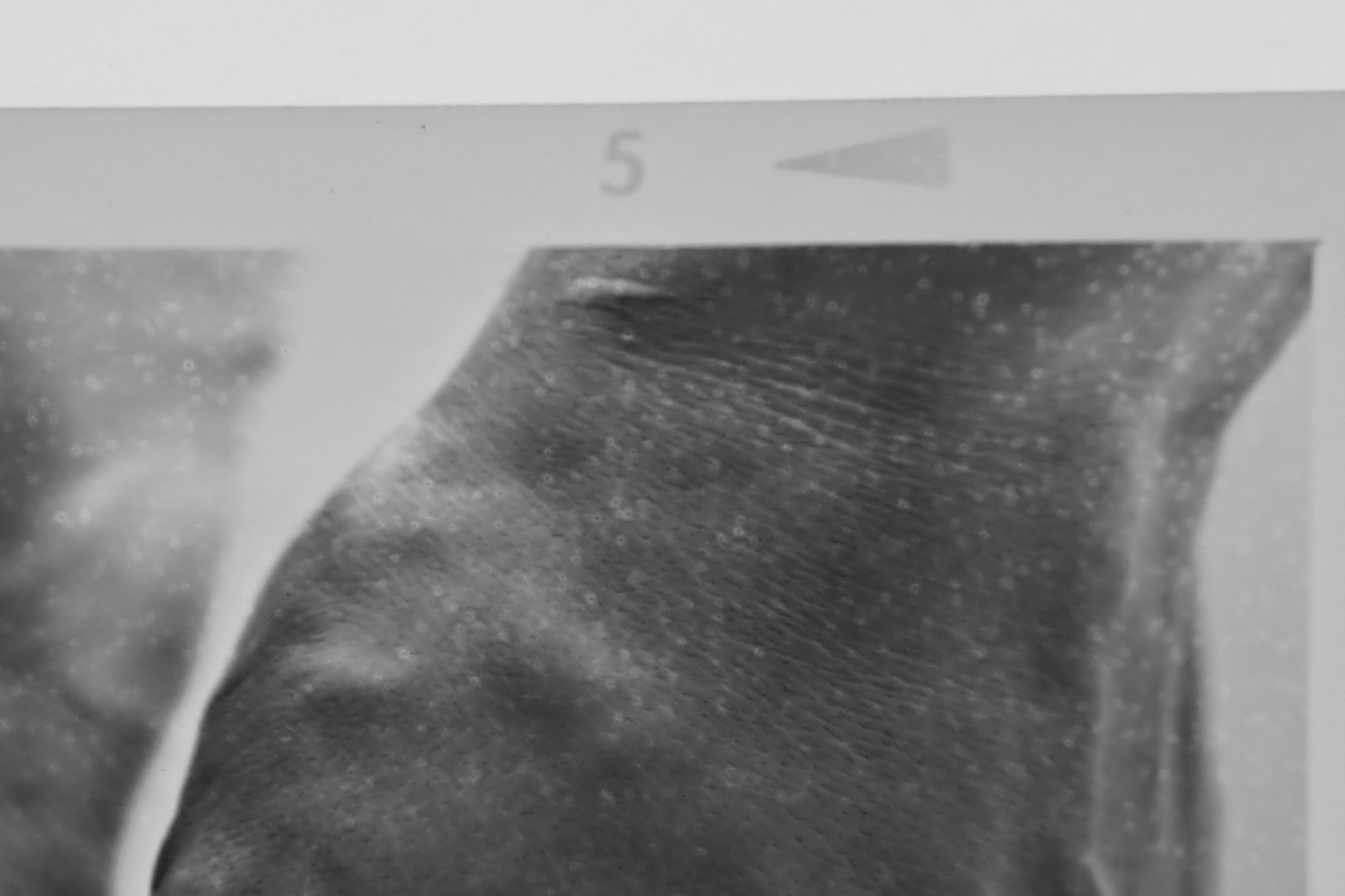

Not air bells. Contaminated film. Film left in the heat too long. Paper backing problem. All good contenders. Show us a backlit photograph of the negative including the rebates please.
Note how thin the edge markings are.
Looks like an emulsion issue to me too. If you have more of this, I'd shoot another roll and see.

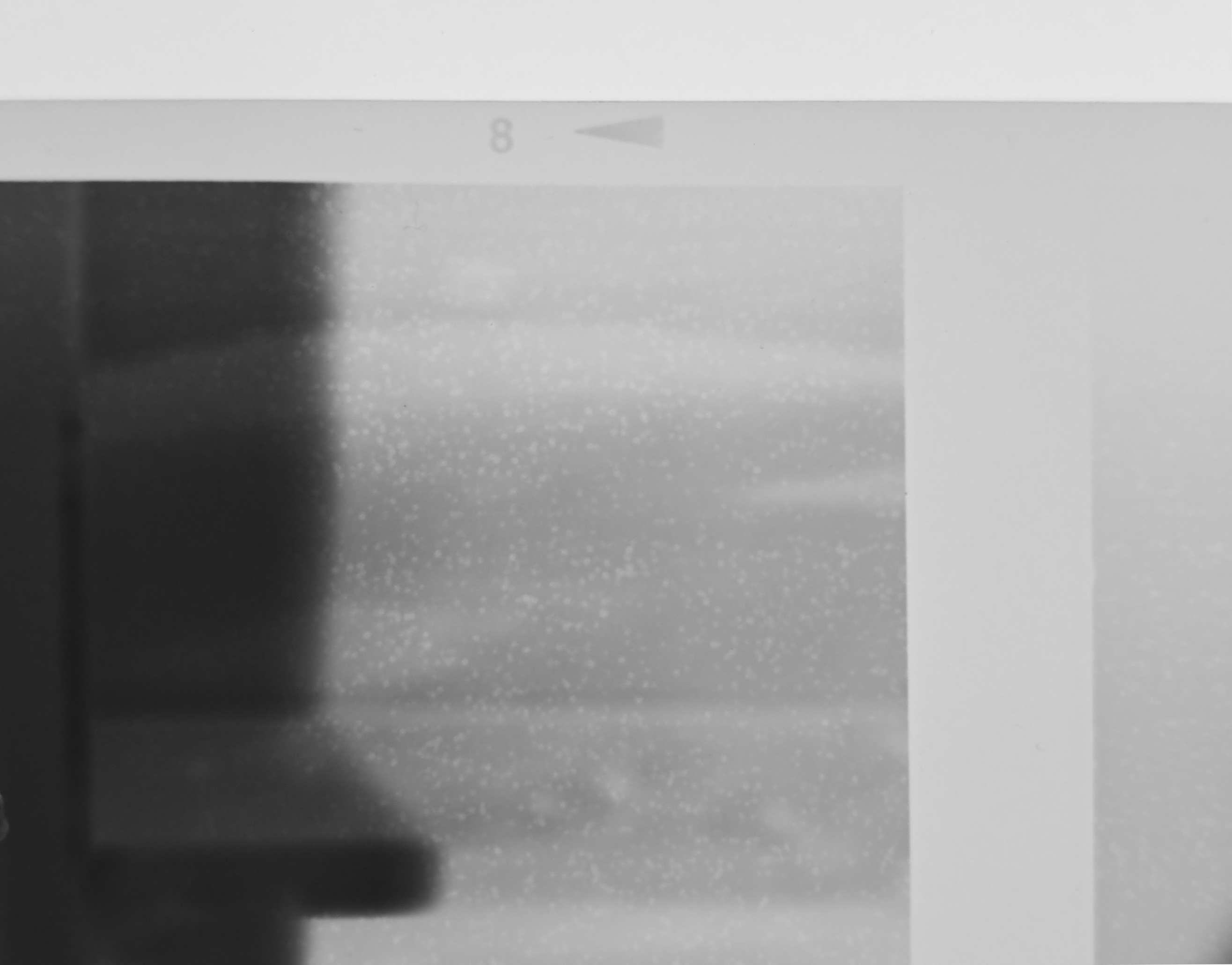

Have we any 120 Ilford Ortho Plus users here? If so were the frame numbers faint like this? Presumably poor storage would not affect the frame numbers?
OP, can you show us some of the complete negs in their entirety.

Anyway, I agree that they aren't air bells. Hecks, there is no way there would be so many air bells on one roll of film.
I also notice that on the positive image (scan) these spots are black outside with a white dot in the middle. Don't air bells appear (on a positive image) just the opposite — i.e., white-ish or gray-ish outside with a black dot inside in the middle?

I shot a roll a couple months ago. Fresh stock. No issues. Frame numbers normal density.

The photos in post #1 look as the classic appearance of bacteria having eaten emulsion.
I am now pretty convinced that it is a problem with the film. I find a couple of videos on YouTube that describe spots on Ilford 120 film, much like the ones I am seeing.
Also, the YouTuber in the first video claims in another video that he didn't see any edge marking on his Ilford Pan F film which exhibited the problem. I wonder if the edge markings are so faint that he just didn't see them. And this is very similar to one of the 2 Ortho I am talking about here. The edge markings on both rolls are very faint, but for one of them, the markings are so extremely faint that I can just very barely make out the markings using a loupe and light table.
I agree. I never thought that they were from air bells. The film was defective. Now get some fresh film.
