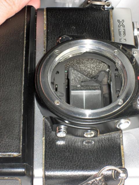

Anyway, it seems to have a fungus issue on the body, but I don't see it on the lenses. I've never had a fungus before. I see white spots on the light seals and in the mirror box.
I've attached some pictures.
So after seeing these, is this a fungus? Is there any hope of removing it?
What would you do with this if you owned it?
Is it at all likely that the fungus would grow on film that is run through the camera? I'd hate to use it and contaminate my pictures or my tanks.

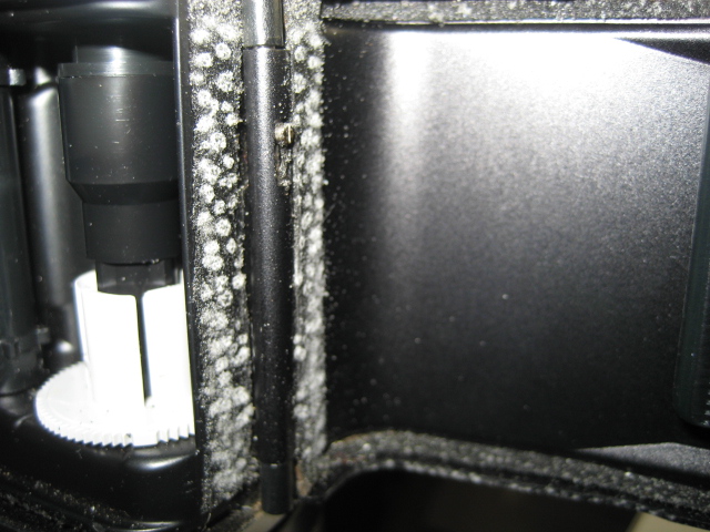

To me it looks like the light seals deteriorated; I've seen that pattern many times before (the third picture.)
If I owned it, I would scrub it with some alcohol and Q-tips. After getting it clean I would replace the light seals and periodically check it to make sure it's okay. Unless it's not functioning properly I would see no reason not to use it (I used a totally beat-up Trip 35 in the past.)

That looks like corrosion of the aluminium to me, not fungus. Of course, it could be fungus and I'd hate it to grow on you, but I don't think it's organic. You see the same spotty pattern on aluminium things all the time. Even if it is fungus, it doesn't look like the same species of fungus that inhabits lenses and eats your coatings/balsam - that typically has a fibrous spidery frond-like appearance, not spots.
At least the lenses you got are fine!
I would clean it carefully with isopropanol and then ammonia (just in case it is fungus) and leave it out in strong sunshine for a couple of days. It's probably all through the body though, and a professional CLA may be more than it's worth.

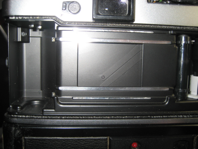

First image. Definitely aluminum corrosion. Have seen it before. Scratch it and will see it is a dry powder, leaving a small crater. Was it fungus, your mirror wouldn’t have look so nice.
Second image. I don’t see any problem. All looks clean.
Third image. Confusing, but if it would have been fungus, it would have migrate, not self-limited to this specific area. I rather suspect corrosion again, but this time triggered not only by humidity, but also by an electric effect due to the proximity of two different metals. And, iron and aluminum are very sensitive to this phenomenon. This would explain both, the aluminum oxide migrate on the light seals, and the iron rust on the door. For confirmation, the axis and spring of the door should also be rusted. These are the parts putting the two metals in close proximity, and this would also explain why this corrosion didn’t showed-up elsewhere on the light seals. Once again, scratch the spots and see if a dry powder (like a very fine salt by touching). You’ll feel if organic or mineral.
If it shows to be corrosion, than mechanical local cleaning, +/-some painting, would be enough. Avoid chemical cleaning, especially bleach, ammonia, vinegar. Alcohol would still be fine (at least but not last, for cleaning).

It's mold. I've lived in Florida 30 years, I've seen it on all sorts of things, photographic and others. You can clearly see the mositure this camera was subjected to by looking at the third photo of the seal for the back, look at the nooks and crannies and you will see surface rust in several places. You have a mold problem. Wipe things down with isopropyl alcohol that are affected by the mold. Don't touch the mirror. Then send the camera out for a CLA and foam replacement and replace the leathers on the body. You can use some "Ospho" with a spotting brush to stop the surface rust in it's tracks.

If it was galvanic corrosion, how would you explain the spots inside the mirror box? Corrosion of the base aluminum through the paint would probably cause the paint there to blister and peel. I'd say this is on the surface. Fungus likes organic materials like paint, foam and adhesives.
And yes, the steel of the door spring and hinge would probably rust - doubtful that it's stainless steel and any other steel would rust in presence of moisture. For aluminum in contact with steel, acting as a galvanic couple, the aluminum should be expected to corrode first since it is the more active material.
phenix
Mar 30, 2008
216
penguin-cold
Aluminum can be paint over, or paint might be applied by galvanization. And I’m inclined to consider galvanization for the mirror room, for at least two reasons: the paint must be applied on a textured surface to avoid reflections, and the paint mast be very strong fastened to the aluminum surface. In this case, corrosion works just like in the first photo. Beside that, only the owner can say if these spots are in surface (fungus) or in profusion (corrosion).
