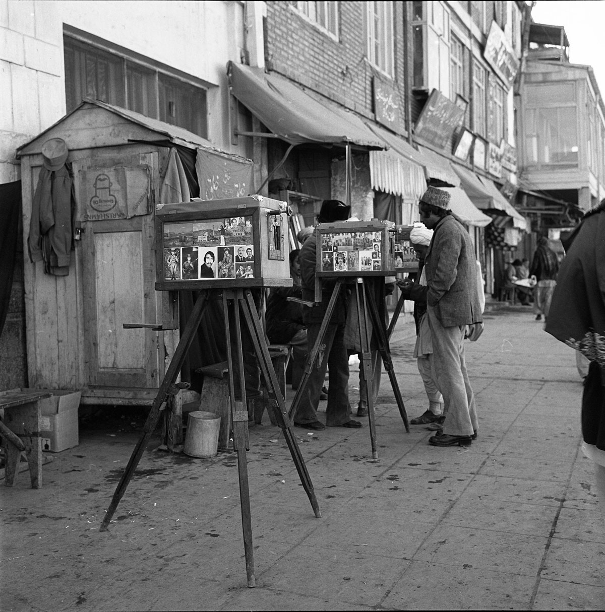

I took this picture in the early seventies, maybe the same guy in his younger days?
There were quite a lot of them in those days.

The designation "Afghan Camera" provokes the idea that those cameras were only to be found in Afghanistan. However they had been widespread.

thank you for the video link, I love watching masters with their afghan cameras whether they are in Afghanistan or Havana or New Mexico .. the wooden bit that dangles down below the front of the camera is typically flipped up as a copy stand where he wet and stuck the just made negative and rephotograph it all over again inside the camera making the positive print. ...
Those were very common in the Third World for much of the 20th century. The designation as "Afghan Box Camera" is mainly because Afghanistan is the last place they stayed in regular service. As recently as twenty years ago, they were still seen in upland India for things like passport photos. Apparently they were seen in Cuba fairly recently, too (there was a gallery shot here on Photrio within the last couple months of a similar camera in Havana). Put a second sleeve in there and enlarge the safelight window, and you could pour, sensitize, develop and stop a tintype in one, then bring it out into the light for fixing, drying, and varnishing.
I was wondering about the thingy...It makes perfect sense now you've explained it, thanks!

For dry gelatin, you would not need a towel and a beaker, and a sleeve, as in photo #1. But the holder for re-photographing is missing. Some direct reversal process?
