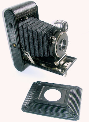

I quit searching materials who can block light completely in one layer, instead, since bellows are made in three layers, all together they are light proof is enough to me.
Out side layer is Chinese silk, cutting sheet as ribs, and inner is cotton cloth or darkroom nylon cloth, the glue is acrylic white glue made for fabric, they brings me very good bellows.

You did a great job on that bellows!
