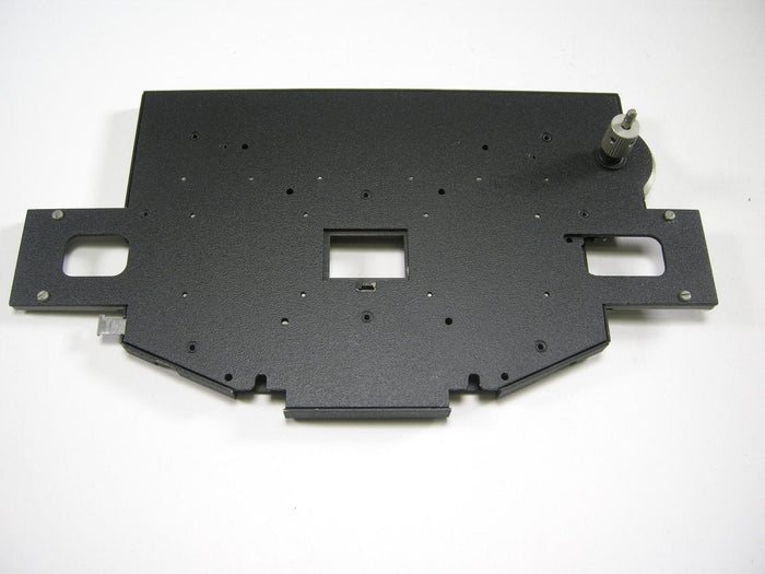

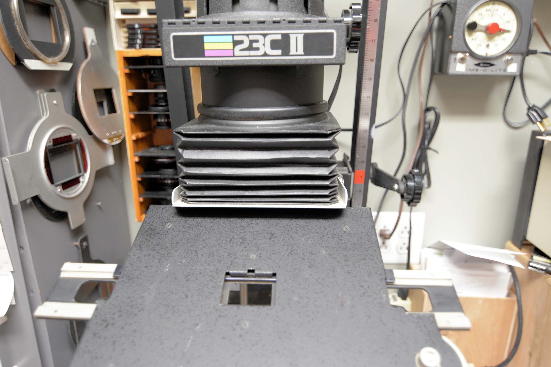

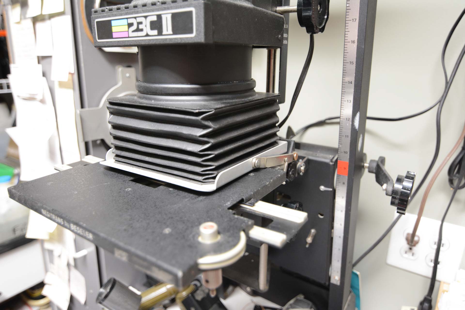

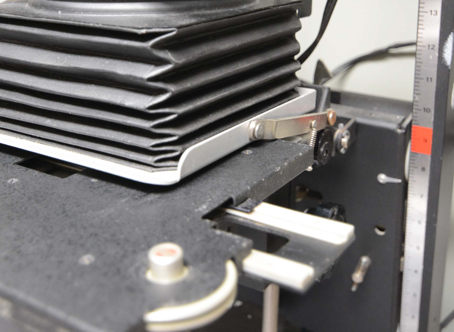

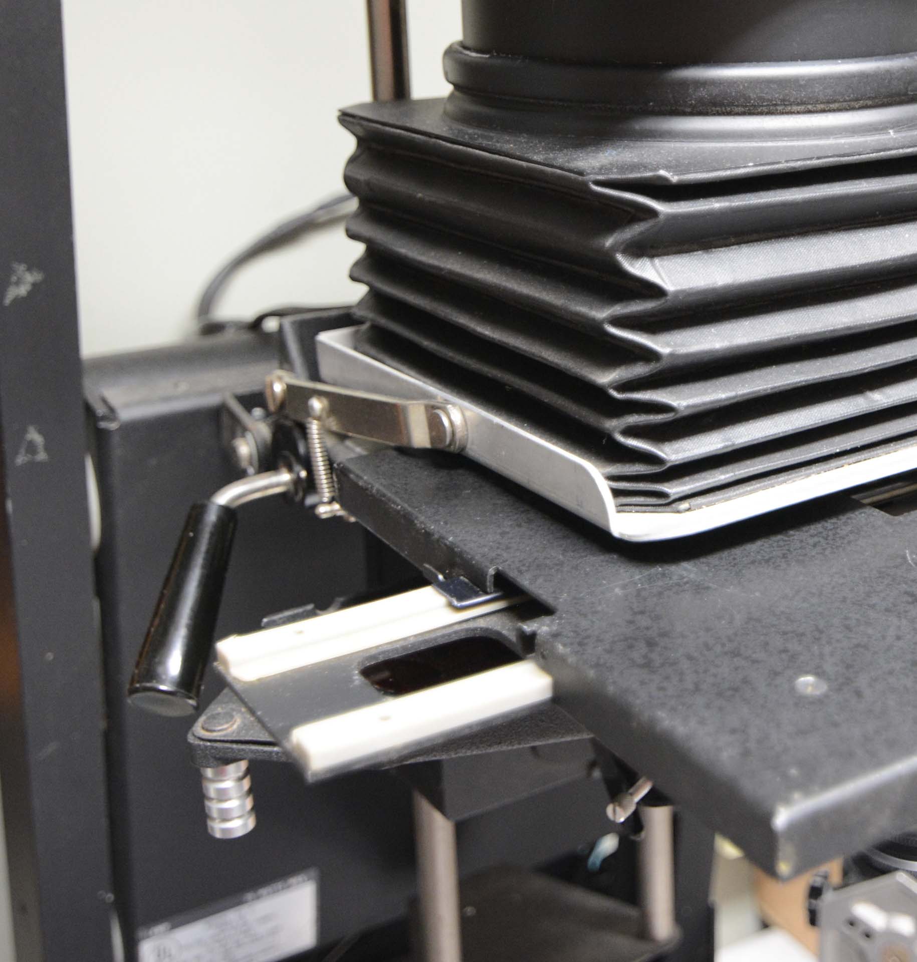

I don't see how I can make this fit. The spring, lift cam and lift bracket are in the way.

So, I decided to do a little research, which I should have done from the beginning. The Negatrans for the 23C enlargers is shaped noticeably different on the back side to make allowances for the offending bracket, spring and cam. Now I know. I shall keep looking for one at a reasonable price.
