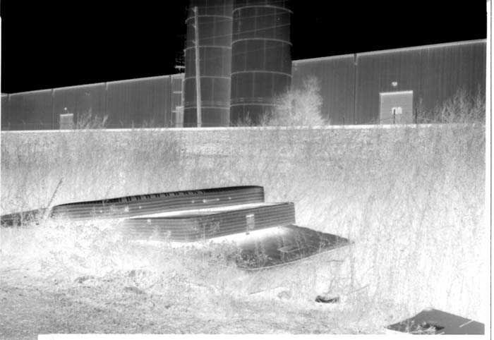

By the way, here is a scan of the first negative. Yes, I know... it is a picture of old mattresses, a little boring. But I will be going out to shoot again soon.
Thanks everyone... -Grant
