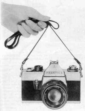

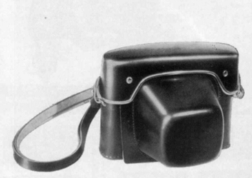

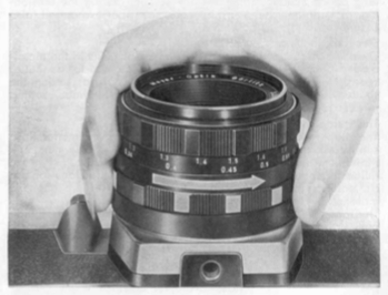

I suppose the term "vintage" applies here, but in case I'm mistaken, please, dear moderators, move this thread where appropriate.
I am fascinated by the peculiar aspect of old halftone reproductions in manuals, especially photo items. However, I'm at a loss trying to describe it in plastic terms because I don't understand how it came to be. To illustrate what I am referring to, here are some snaps taken from a Praktica L manual.
Surfaces like metal or leather have that really neat unreal look to them. It doesn't seem to be just a question of boosting the contrast because there are gradations and midtones.
So what was the process behind the particular aspect of these reproductions, especially the way the specular reflections are rendered? Was there some retouching involved? Is it something that can be duplicated with film photography only?

I do believe the photos you show have been airbrushed prior to being rephotographed for publication and the artist was NOT "painting with light" but "lighting with paint".

Different techniques were used: airbrush as well as pencils, ink pens, paint brushes, diluted white or light paint. I think you can still buy some of the retouche paints (Schminke -or Schmincke?- still sold them some years back). IIRC, one worked on rather contrasty prints of the original analog photographs. Afterwards a copy of the finished art work was made on a contrasty (lith?) film used for offset printing.
It took regular and thorough training to work on a retouche department. If you want to find out more about the tips and tricks of the trade, you do well to look for books on vintage advertising techniques, vintage (pre-press) graphic design and halftone printing techniques. In very early air brush manual you may find a chapter on photo retouching. It may be worthwhile to figure out how to do this without a computer, since it takes as long with the aid of software programs as it does by manual labor.
