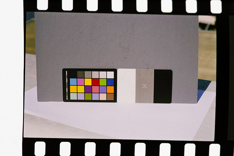

Hello again. As I had mentioned previously, I tried 6 135-36 films in the same 500ml of E6 FD and CD solutions, following formulae by @stefan4u. I didn't try to correct pH between uses, but used them as they were. The photo below is from a colour checker shot with a film from the third, last batch of films processed in these chemicals. It was Agfaphoto CT Precisa 100, few months out of date. The film was placed on a mobile phone, to be used as a backlight. The raw file from the camera was opened in Adobe camera raw and white balance was set by clicking on the screen itself, on the left.
After processing the the third pair of filmns, I checked CD pH and found it to be 11,63, obviously off specs. Had it been closer to 11,95 where it started when mixed, the colour balance would be less magenta and shifted towards green. Contrast is perfectly reasonable, as is Dmax. Higher densities lean towards green, so there's probably a light crossover. In practice, when projected, the slides look fine and whatever faults they have go unnoticed.

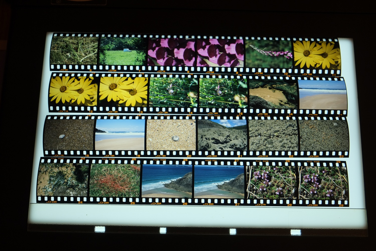

Alessandro, I respectfully disagree, as my experience (and I routinely home process E6 !) is totally the opposite !
I stop sending my film to so-called "pro" labs, years ago. I was charged when sending my film by mail (as a parcel, not a letter ), was charged for the processing, and charged again for having my slides back (again as a small packet, not a letter). And the resulting slides was.... just ugly ! Badly mounted slides, dust and specks (after drying, obviously...), and sometime muddy colors... My home processed slides, with 5L and now 2,5L Tetenal kits, are a lot better, and in all case, if any rare defect, I'm the only one to blame. All of this with my 30 years+ Jobo ATL 1 processor (carefully self repaired and grossely calibrated...)
I now use for the first time 2,5L kit, after using 5L kits for long, and it yields 30x 135 films. This 2,5L kit is now 65€ (see nordfoto webshop), so a little more than 2€ a 135 or 120 roll. Of course, this is not going cheaper, as not so long ago, 65/70€ was the price of the 5L kit (can process 60 films...)
I am agree that this one-shot kit is rather a steal, and probably not a smart move from Tetenal, unless they want to sparkle interest to the young and unexperienced with a one-try E6 processing. Re-Introducing the 1L kit would be a lot more interesting for us.
I should talk also about MF and LF films : I can process 120 sheets of 4x5" large format slides with one kit ! Last time I checked (years ago), pro labs asked 5€ for processing.... ONE sheet !
BTW I just begin a "batch" of E6 dev, yesterday night, and here is a glance at the result from the first film (Provia 100F)
Slides are IRL a lot more nicer, vivid and accurate on the light table than this quick digicam shot (quick WB adjustement).
