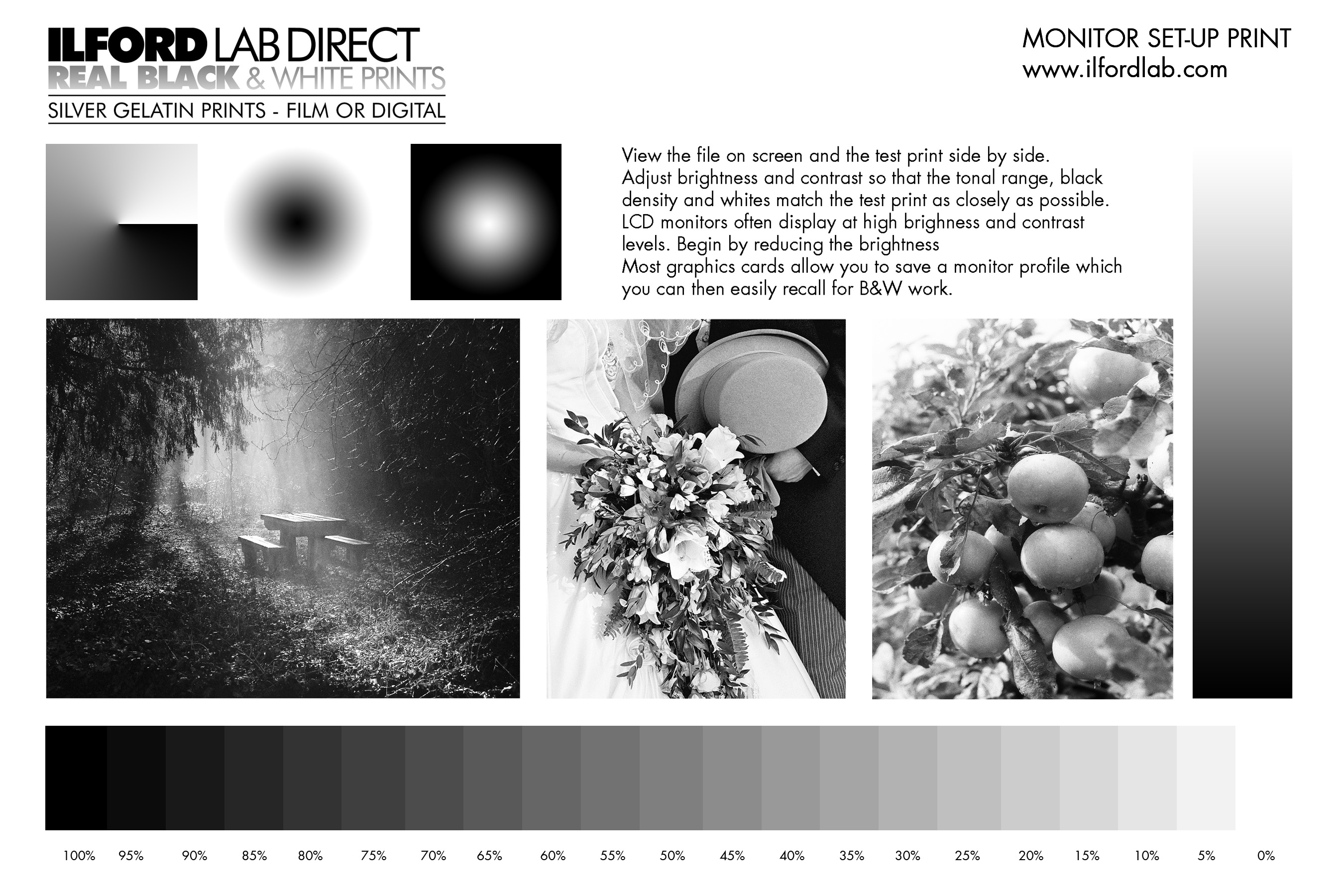

Ilfordlab (now Harman Lab) used to have a monitor set up print. You used to be able to order a print from them or download it from their site and print it yourself.
@redbandit .You could try making your own "Shirley". I have done it and it worked out for me.
If you are interested I can send you a bigger size file of the set up image and explain how to do it.
