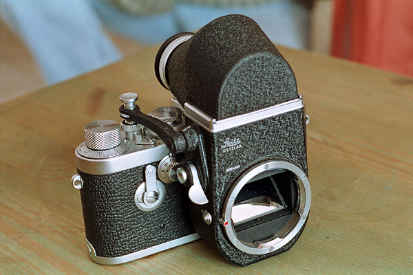

Visoflex:
Then you can stick any M39 you want but infinity focus is gone. I think there are special visoflex lenses...but then it would be loads cheaper to get a cheap SLR with a bellows.

Right. Visoflex -- it turns a rangefinder Leica into an SLR. Not the cheapest way to go.

Find a Visoflex, a focusing adapter, adapter tube & lens head. I'd guess that without a lens you're looking at around $300. Oh, oh, pretty soon you'll be talking serious money.

You could hunt for an off-brand M39 bellows plus a reflex mirror housing. I found one locally on Craigslist for $20 which included a Xenar 135/4.5 in LTM.
Ended up being a Novoflex branded bellows plus a "Reproflex" by Novoflex before it became Novoflex (K. Muller Jr Memmingen).

A screw mount viso complete is inexpensive and kilfit made a variety of long focus lenses with macro ability. However,the viso 1 requires a double cable release but sometimes a kilfit reflex housing comes up on the big auction site. Kilfit lenses are very good and for use on a leica tm viso you can get by without an adapter since only a thin spacer is necessary. As a substitute a thin washer from a hardware store will do . Have fun!
